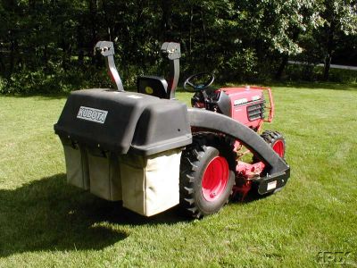

This is a very old post but just to update, I ended up finding a used B2410 (year 2002) with 25 hours on it from an individual, love the tractor. Still don't have many hours (60) but I do have a larger NH. It came with the mmm and bagging system. I have found that I never use the bagging system, it just takes up space in the garage. How much is it worth (near perfect cond), I expect it cost over 2 grand new. Dealer said it would be worth $600 to $700, what do you all think? I may put it on ebay or try to trade it in to the dealer on a RTV or ATV. Opinions appreciated. Thanks

Guess no one is that famaliar with the bagging system. I'll see what ebay says as soon as the grass turns green. thanks

Rodney, I'm not sure if you're saying it's a NH bagging system, or a Kubota bagging system, but you may get a better answer if you post your own thread on it in the respective forum.
Many people only go to their brand's forum and may not have seen your question. Good luck, John

</font><font color="blue" class="small">( This is a very old post but just to update, I ended up finding a used B2410 (year 2002) with 25 hours on it from an individual, love the tractor. Still don't have many hours (60) but I do have a larger NH. It came with the mmm and bagging system. I have found that I never use the bagging system, it just takes up space in the garage. How much is it worth (near perfect cond), I expect it cost over 2 grand new. Dealer said it would be worth $600 to $700, what do you all think? I may put it on ebay or try to trade it in to the dealer on a RTV or ATV. Opinions appreciated. Thanks )</font>
I was looking at a nice 2002 B2410 but i passed on it because I was able to get a new BX 23 for less because of the 0% financing.
   / No perfect 24 hp CUT
#29
B2410 is quite a bit more tractor in my opinion for my needs. Bx23 has its benefits and may be better for some users.
Bagging system is Kubota.
