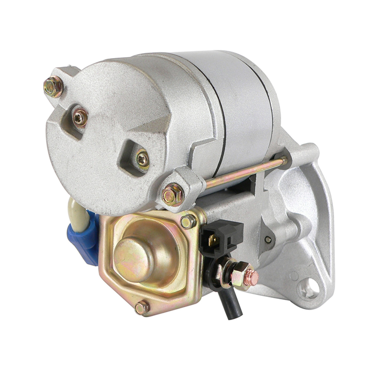

Updated:
I replaced the key/ignition switch with zero improvement. I found a blown fuse that apparently controls the dummy lights in the dash which now work.
After checking all wiring and other fuses that appeared good, I jumped it from the battery to starter as I have to. This time it cranked slow. I am unsure if it's because I had the key on for so long trying to diagnose, this running the glow plugs/pump?
When it runs, I now have the battery light illuminated. My plan is to replace the battery and go from there. I am concerned why it would start by jumping and not by key if the battery was dying?
I believe my second concern would be the transmission safety switch? I think that's the only one still operations as I've bypassed the seat switch. Any input on how to bypass all the switches or each individual switch would be helpful.
Thanks all.
   / No start condition Massey Ferguson 1260 #9
When you jump from the battery to the starter are you going to the battery lug on the solenoid or directly to the starter hot lead?
When you jump from the battery to the starter or solenoid you are bypassing the battery feed to the starter.
The safety switches usually only inhibit the key start cycle, in which case a screw driver or short jumper from the battery to solenoid should start the tractor.
I still believe that you have a bad battery cable or connection which you are bypassing with your jumper cable.
And now with your battery light illuminated it tells us your alternator is not charging, not that your battery is necessarily bad.
If this is your starter, are you putting your jumper cable on the stud visible on the right side of the picture, then using your key to start?
The plug in lead above the stud is were the voltage signal from the key should be going to start your tractor. It is also were a were a small jumper from the battery should crank your engine over.
I am gong directly from the positive battery terminal to the "plug in" wire above the battery cable lug on the starter. I leave the key on, touch the plug with the charged jumper wire, and the tractor starts.
