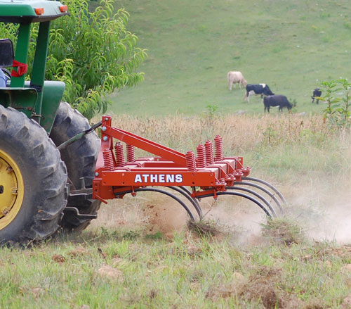

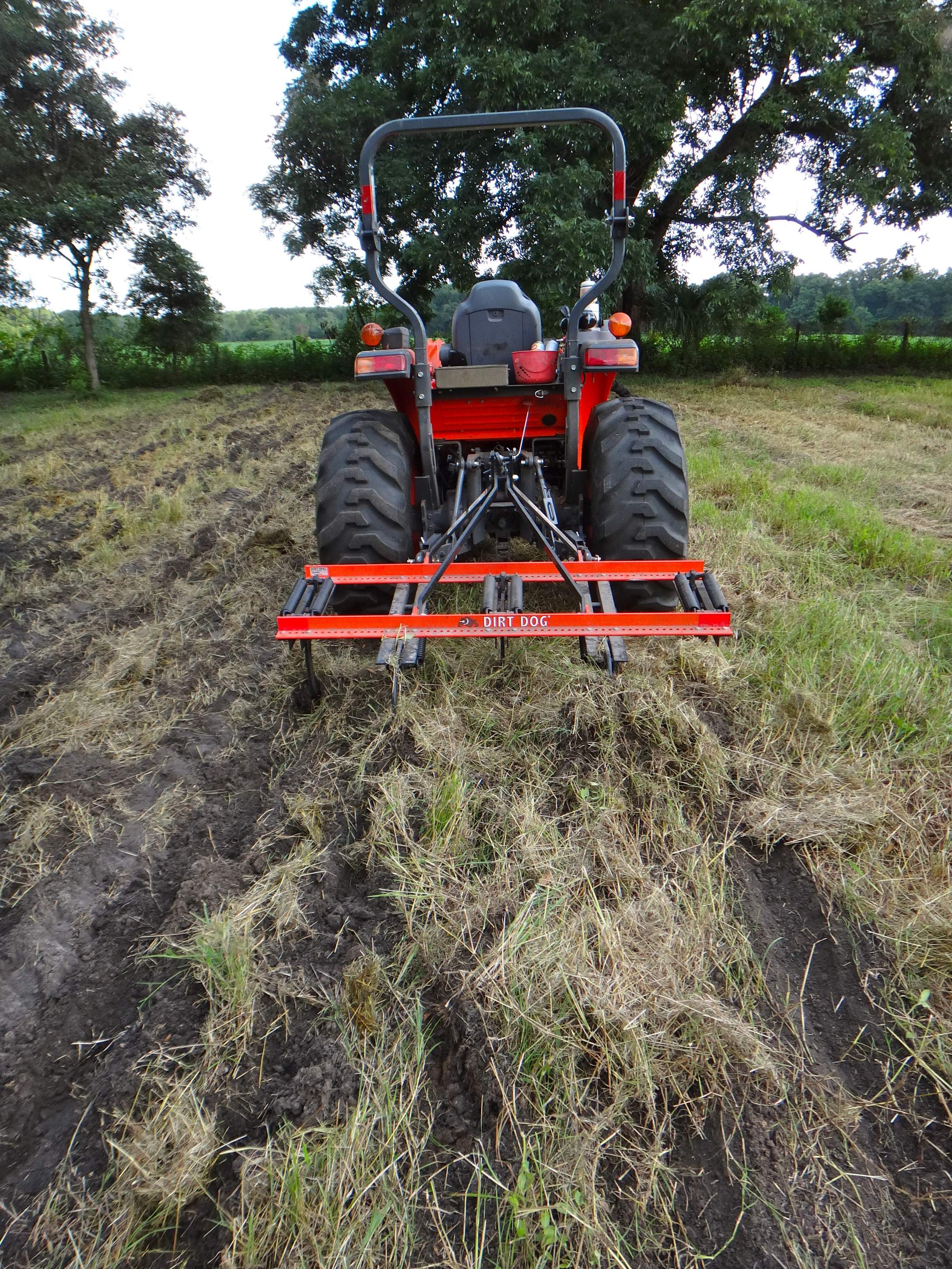

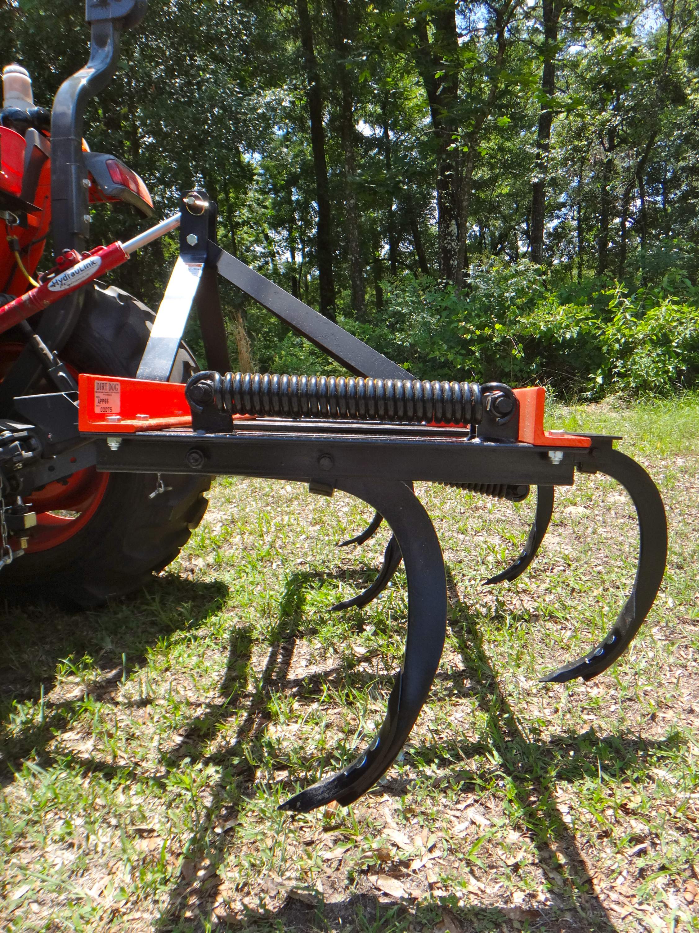

The main conservation plows is the Chisel plow or its lighter brother, the Field Cultivator. Tines are pulled through the soil, leaving some vegetation on top to prevent top soil from blowing away. You can pull a four tine Field Cultivator with an L3901, possibly, not definitely, a five tine Field Cultivator } $900. Many would opine aeration provided by a Chisel or Field Cultivator improves soil productivity.
VIDEO: How to Use a Ripper / Field Cultivator - Gardening Series - YouTube
If your tractor could handle a heavy drill you are back to the optimal no till combination: very low cut with a Rotary Cutter, then a drill for seeding. BUT....do not let the perfect become the enemy of the good. You have had a ton of GOOD, DIVERSE, options suggested in this thread.
Photo #1 Chisel plow, Photo #2, #3, #4 Field Cultivator, AKA: All Purpose Plow

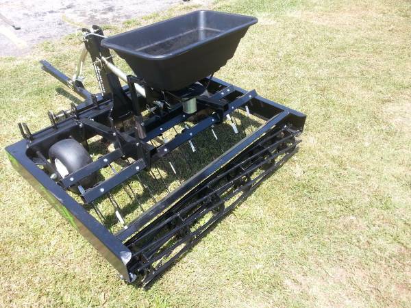

Here is a picture of my Olathe, now TORO slit seeder I incorporated Timothy seed in to my existing hay field. The original owner was a local high school that used it to reseed their football field. They installed astro turf, so the seeder set for years until it sold at a surplus auction. It was bought by a fellow who never used it. He put it up for sale on Craigslist, and I bought it for $100. It needed some TLC, new roller drive chains, and a couple of bearings. I still have less than $200.00 in it.
I did a Fall seeding, after making the last cutting. You can see how much it disturbs the soil.
A local dealer has a similar Land Pride unit that can be rented for $175.00 per day. Recommended speed for these units is 5-7 mph, so if you stay with it, you can cover a lot of ground in a day, even though they are only a 48" seeder.
