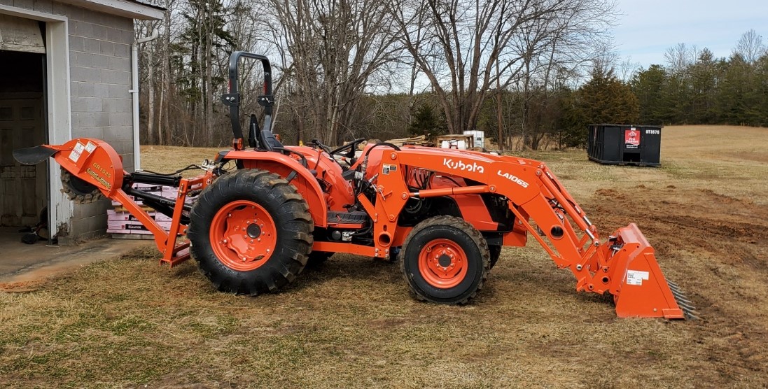

I happen to have a hydraulic up/down - left/right stump grinder by Land Pride. Position the tractor, engage the pto and use the hydraulics. I did two 18" pear stumps, a 24" cedar, and a 30" butternut stump this afternoon in about 3 hours. I'm sure I'll get faster as I learn. Sure is hard on the neck though. Oh... and I can stay on the tractor while doing it.

This is 吐ixed mounted right? You can raise and lower with 3 point hitch, but move it left/right and forward/back with tractor?
Probably not bad with a hydro tractor.
I think the one痴 that swing left to right with hydraulic cylinder are a lot more expensive, but maybe worth it if renting.
So where was the hydraulic leak if just PTO driven?
Bought it.
Leak was from the engine area, not the grinder.
