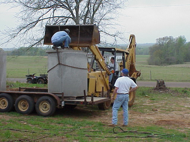

txdon said:
At least one installer ( in a non-inspected Texas County) would put a hole in the bottom of the tank so it will not float. When "they" were installing my septic I heard one guy tell the other to knock a hole in the bottom, I quickly intervened and told them I did not want a hole in the bottom and I filled it up with water so it would not float if a rain came before it filled with sewer.
That doesn't happen with concrete. This is 1 of 2 500 gallon tanks I was unloading. No holes in the bottom, just a 10" or so inspection hole in the top cover. They were actually much cheaper than the plastic tanks.
