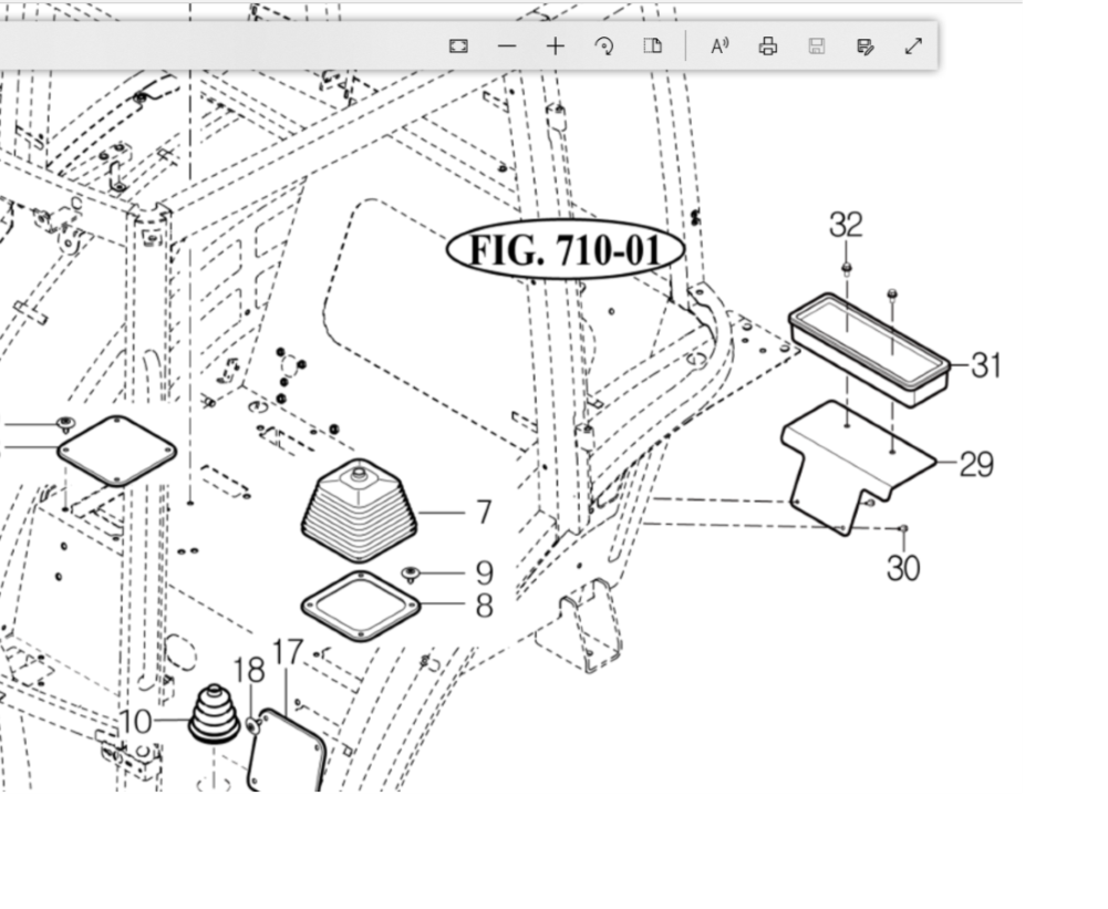

-Lots of extra pieces not attached - 4 in fact. One is a plastic toolbox with a heavy-duty bracket (not sure where it is supposed to go), one is a drawbar and one is a swinging drawbar mount (I think they had to be removed for BH...?), and one unidentifiable metal piece (will post pic later)

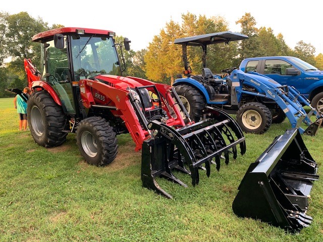

EDIT: Here's a couple more pictures - Old NH hanging out with the new RK. RK's tires are bigger that NH's. New-n-old.jpgWheel.jpg

The tool box goes on a ledge just behind the lower small glass on the outside or the cab. I’ll take a picture of it and post it in a few.

The tool box goes on a ledge just behind the lower small glass on the outside or the cab. I値l take a picture of it and post it in a few.
Thanks! I looked at the parts diagram and saw that it went behind the cab left side. But on mine, the washer fluid reservoir is there. I'd love to see what yours looks like.Toolbox.png
Gunny is gonna help me with the toolbox mounting (from the parts diagram, looks like it conflicts with my washer fluid tank). The drawbar just has to be removed for the backhoe.
The mystery of the other spare partswas solved by reading the backhoe and loader manuals: in the exploded parts diagrams, there is a forward cross-member for the loader that is replaced to become both cross-member and front-mount for the backhoe subframe. Likewise, the stock swinging drawbar mount is replaced by a different drawbar mount that serves as the rear-mount for the backhoe subframe.
