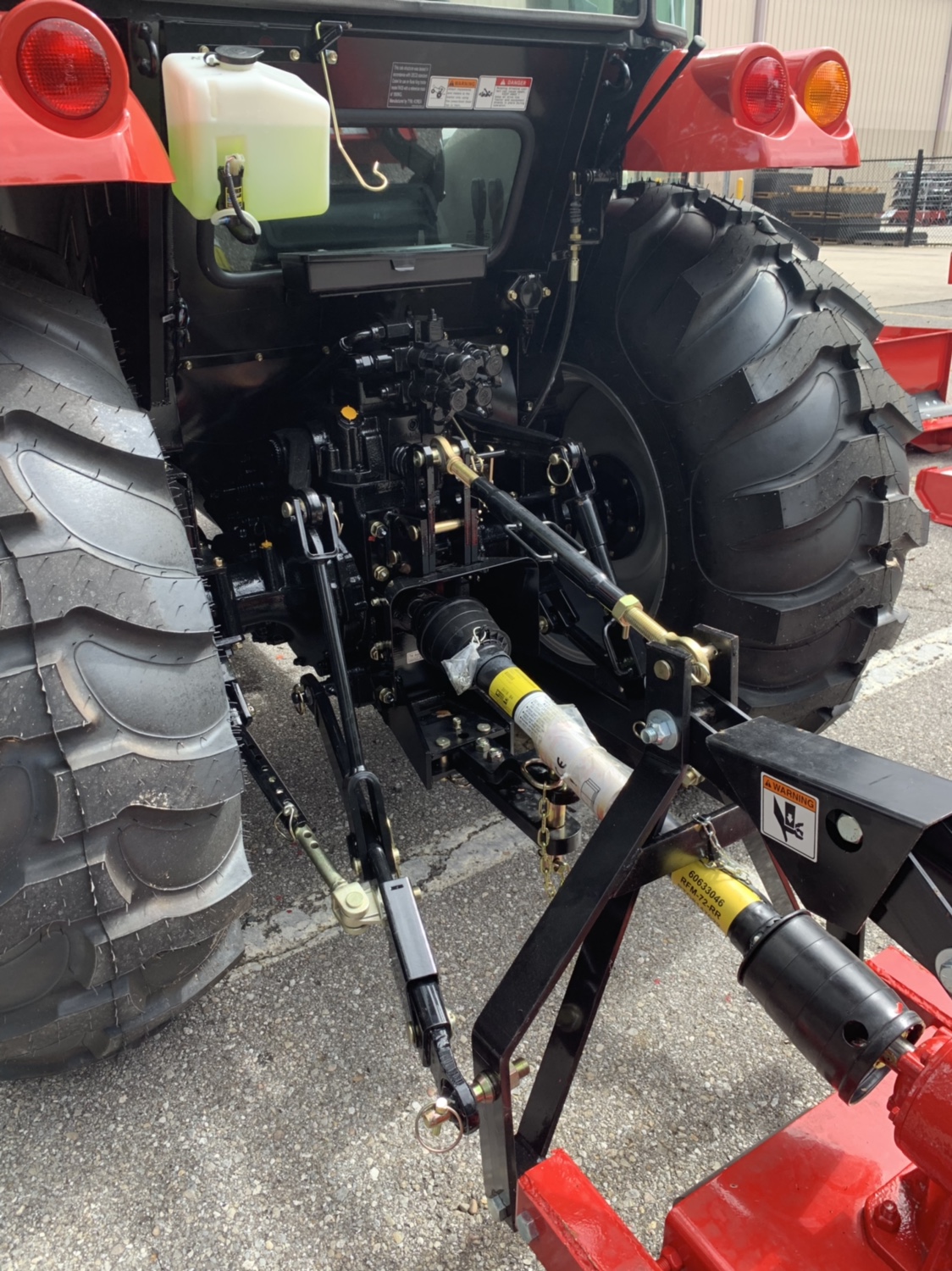

The tool box, if you can call it that, sits just to the right of the washer fluid reservoir and above your rear remotes. If you need a photo of the mounting bracket, just let me know.
Ah...that explains it: I got the third set of remotes, which sits on top of the other two. They might have had to take off the toolbox to make room. I'll confirm when I get some seat time later today. Thanks for the picture!
The third set of remotes makes lining up the bracket's holes for the screws impossible - about a quarter-inch too high.
