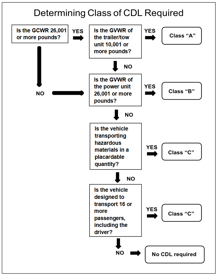

No need to do the typical TBN over-analysis.
Westcliffe is within the law based on the info he provided.
Just keep the flow chart on board and keep positive.
