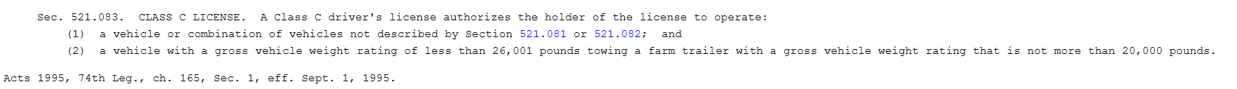

Pickups are under 26,001# GVWR with regular tags. The statute does not address the plates on the towing vehicle, just that the farm trailer being towed does not exceed 20,000# GVWR. Here is the actual statute:

That changes everything. I've been thinking that I need to have two trucks to be legal, and still be able to haul 20,000 pounds. One truck for farm use, the other for going to work in. I need to do some more thinking on this and what I should buy.
   / Non CDL F250 towing 12K trailer across state lines ? #76
Thankfully, that is a Texas law and doesn't apply here in Florida! Not that my pickup hasn't been to Texas a time or two, but have never been stopped. (which doesn't mean I am legal, just lucky!)
