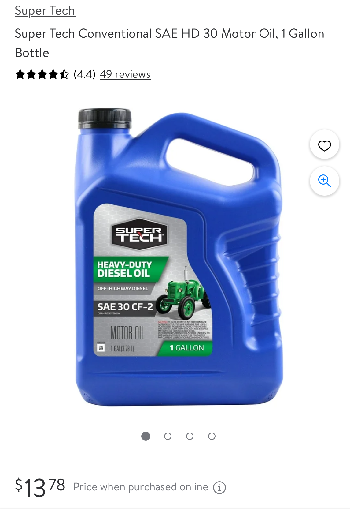

   / non detergent 30 weight oil #7
My local Walmart always has this:
