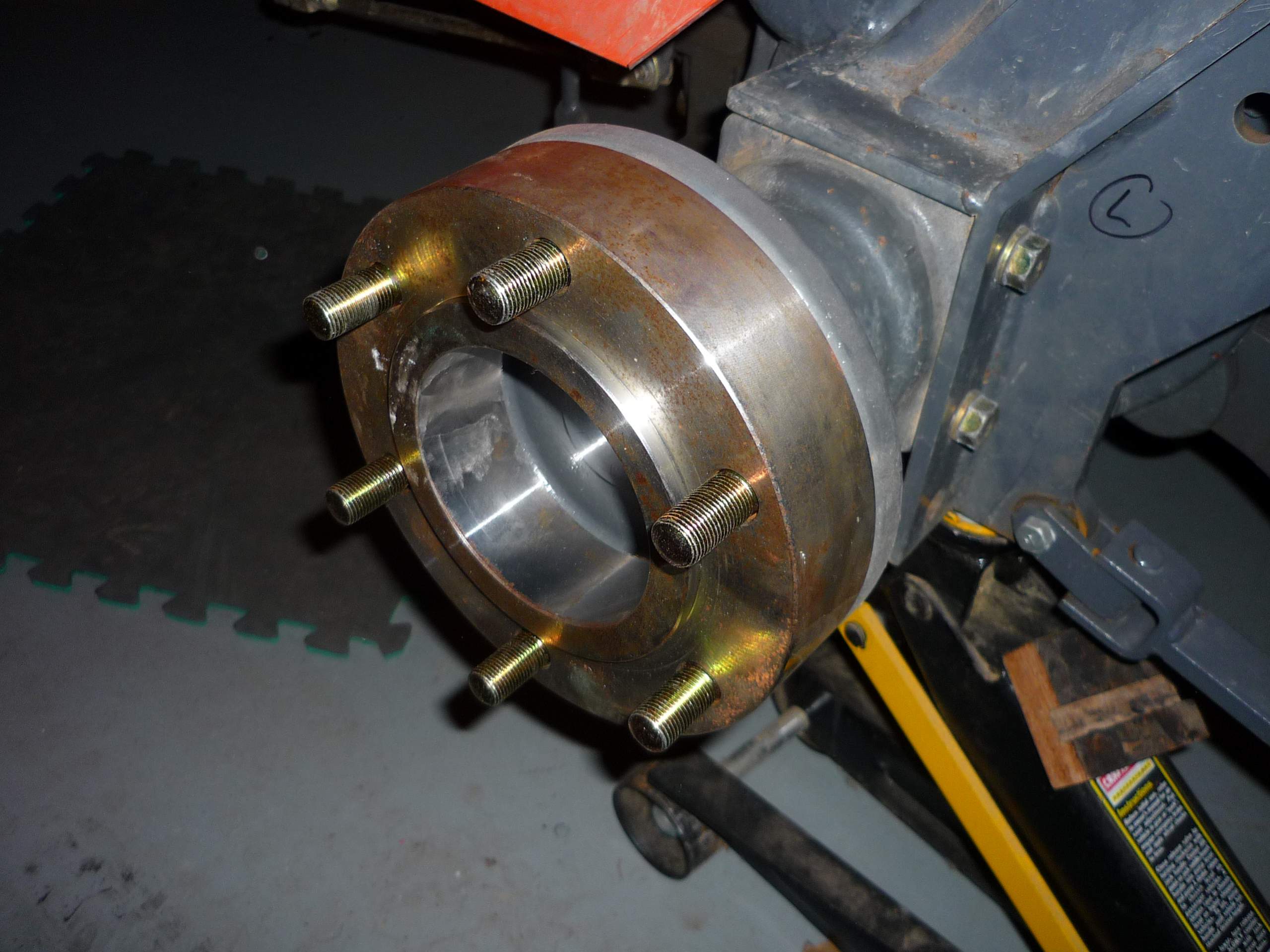

It's fairly easy to spread the rears on some tractors, often by reversing the wheels if they are two piece, or if not, just add some steel spacers- they really help stability. Mine cost about $170 by the time I got all the fasteners. Something with 50Hp or so, and turfs, may be harder to find in the size you need?
