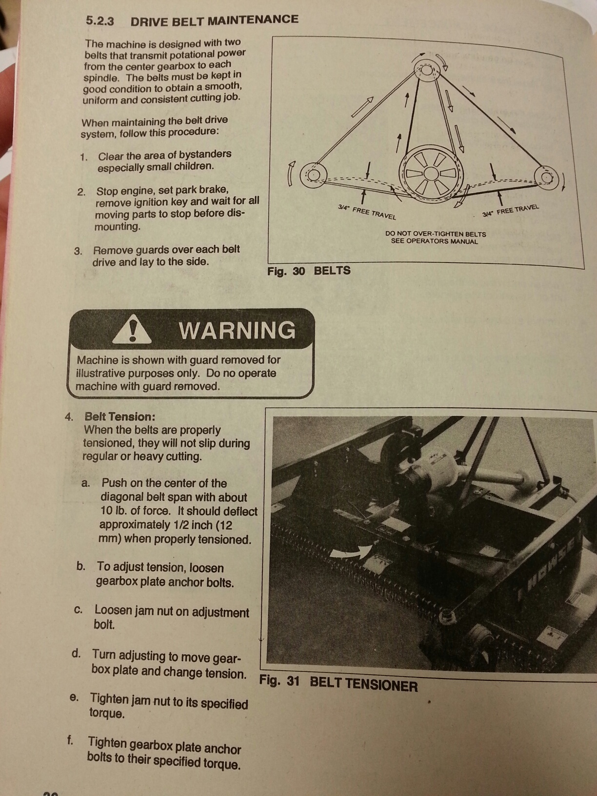

Thanks for the info! Here's the page out of my manual that describes the belt tightening procedure. The mower is simple in that it keeps moving parts at a minimum but that does make it more essential that the belts are matched.
There must be some side slop in the gear case bolt plate.
That path is not going to maintain even tension on each belt as they wear and stretch or you happen to hit some dirt, rock, stump, etc with one of the blades and it causes that belt to slip and/or burn a little bit.
The drawing back of the tightening bolt does add tension but you notice they want you to get the 10 pounds of pressure adjusted on the short run of each belt.
If your present belts are not cracked you can probably readjust them to work.
