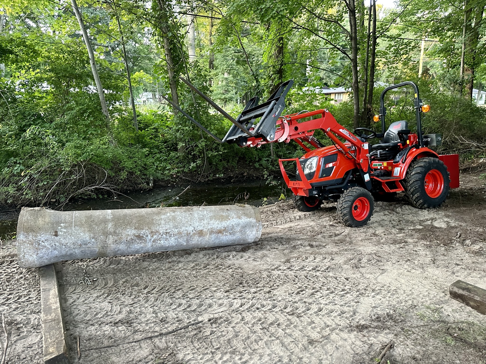

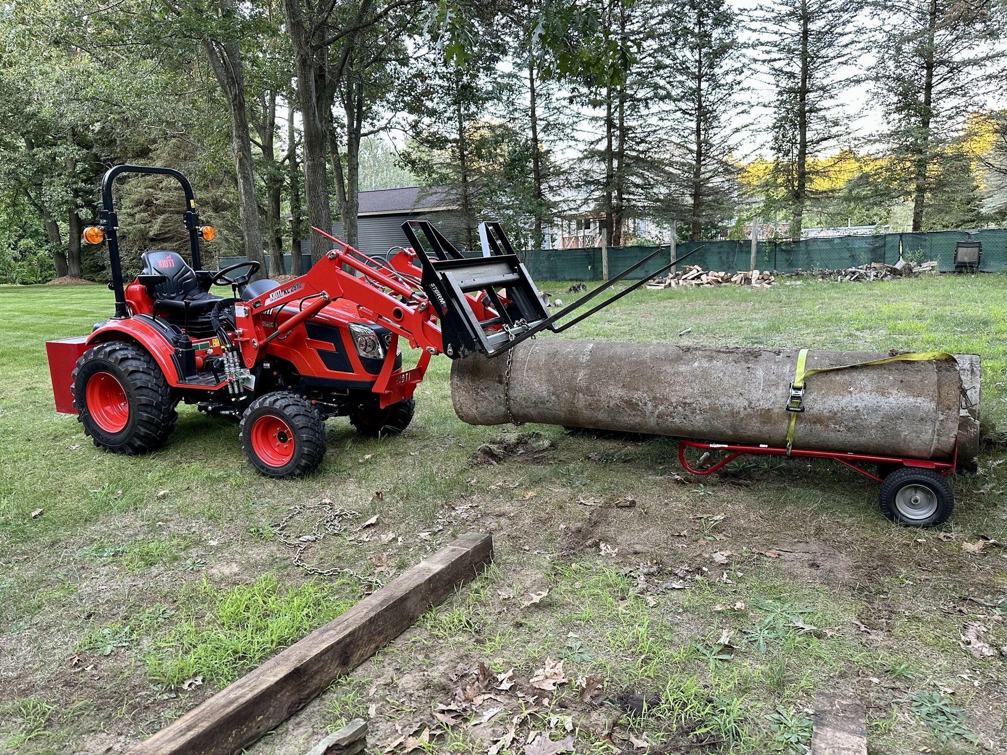

Not land clearing but this was some redneck engineering here. Moved three of these this way, worked really well.

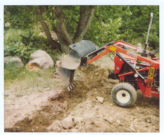

I don't know if this is non traditional, and it doesn't involve land clearing but I occasionally use a tractor as a portable concrete mixer.
I welded an old stand type cement mixer to an SSQA plate and attached it to the FEL. I replaced the electric motor with a hydraulic motor and power it via the 3rd function valve.
I drive the tractor to the various sand, gravel & cement sources and mix while I drive to the construction site. I then use the FEL to dump the concrete directly from the mixer into the forms. The only time I get off the tractor is to load the ingredients.
I have been wanting to do this!! Brilliant!
   / Non Traditional Projects (What have you done with your tractor?) #29
I'd post some pics but my brother is using it at his place.
The idea is so simple, I'm surprised an attachment like this isn't commercially available.
EDIT:
I guess there are commercially available SSQA mixers:
And
Quite pricey though.
I picked up the stand mixer at a yard sale for $50. It had a bad electric motor that I replaced with a $150 hydraulic motor. I had the blank SSQA plate laying around so the whole rig cost $200.
