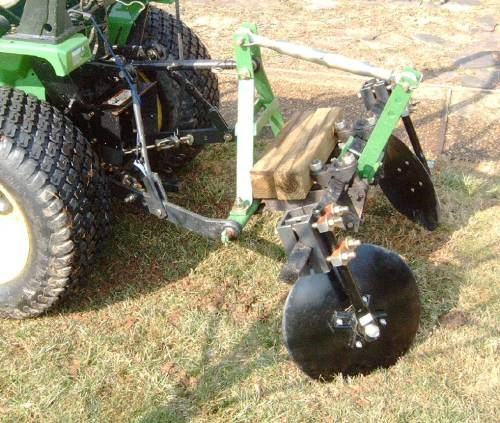

The JD 4010 with its turf tires was fine for ground breaking stuff with an old JD M soil ripper, too. It's turning brakes allowed me to make nice, even raised rows with opposed discs on the soil ripper bar, too. The 4010 is 1420 # without the FEL.

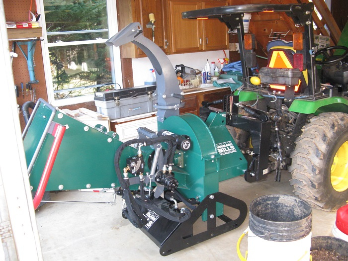

That last picture is with the 2025R. It is near 250 # heavier than the 4010. The 500ish # WC46 chipper is noticeable on the 3ph on slopes on the 2025R. Would not take a bigger WC68 chipper at 700 # unless always on flat ground. Would run it fine. Has plenty of power.
