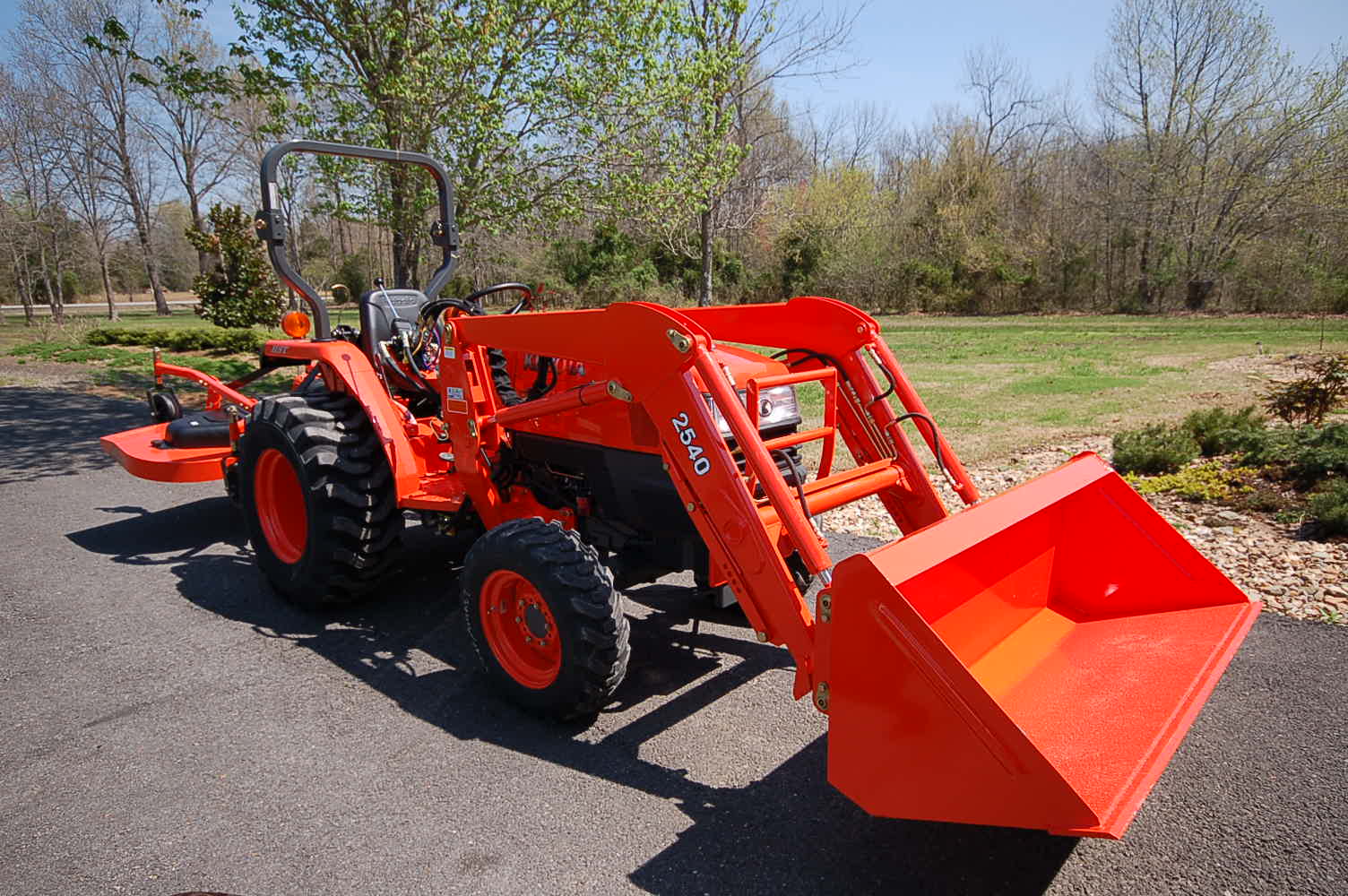

Well the L3400 HST with the Ansung, QA is here!:D Also picked up the Land Pride 6' finish mower and a box blade. Now if my yard was just dry enough to go out and play.
Thanks to everyone for your help:) Any suggestions to a new Kubota owner would be most welcome.

   / nOOB Question on FEL for L3400 #14
Congratulations!
Advice: go get her her dirty, then take some more pictures.:D

#15
Not dirty yet, but my wife has taken more pictures of the tractor than most people take of a new baby! I think she is more excited about the landscaping that can now be done than I am about having a new toy:)
