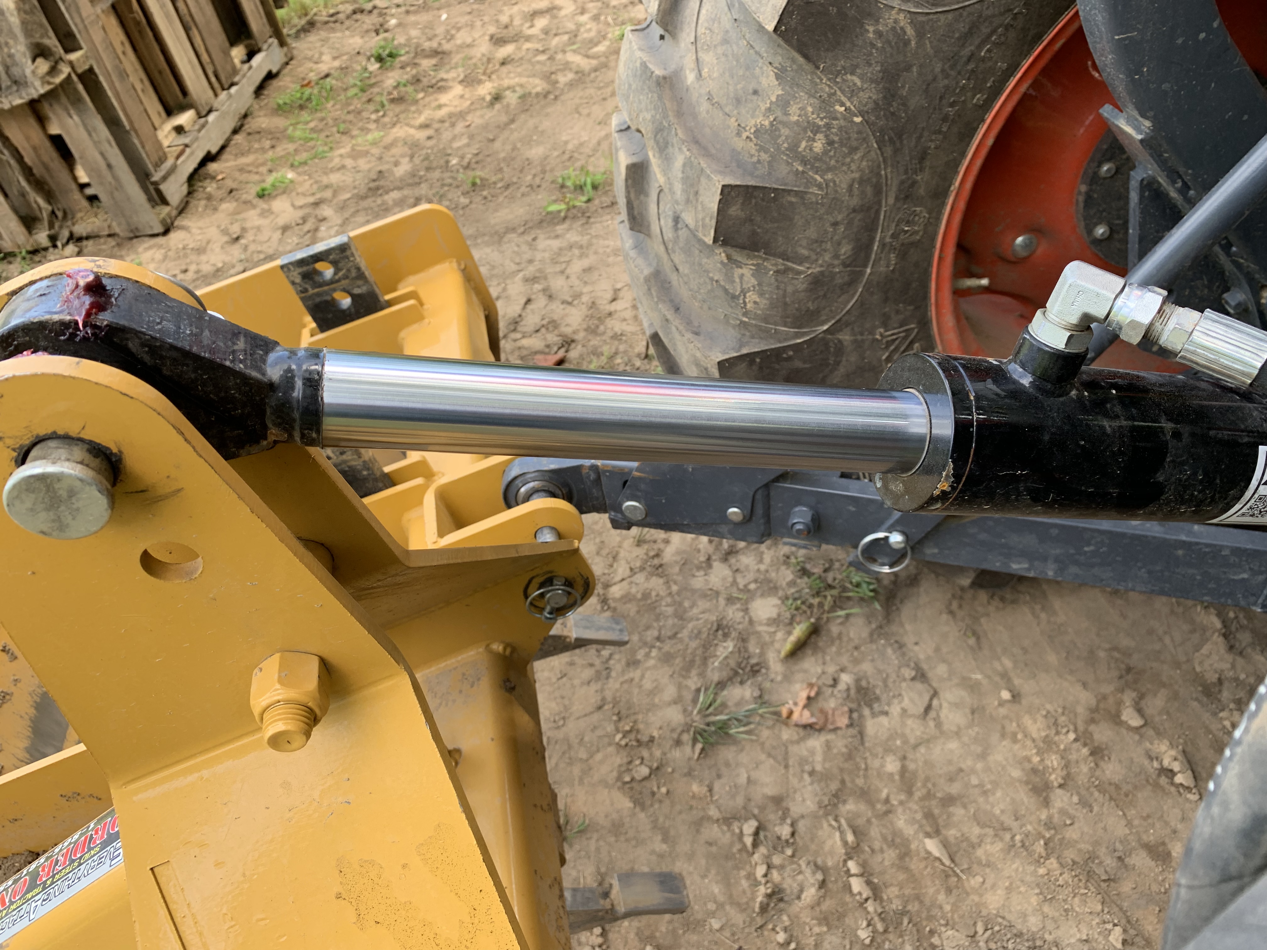

I did the same test with the implement off the ground with the hydraulic toplink fully collapsed, only this time i left the remotes plugged in. Since I had less than 1/4" of movement with the cylinder disconnected, I wanted to know how much it moved with it connected. I waited the same time to go and check it, 2.5hrs. I'm not sure how long it took but the cylinder was extended all the way to let the implement rest on the ground. This was on the float-detent valve. I did not test the standard valve yet, but i assume it will be the same.
Is this expected behavior? Does this tell me some additional information?

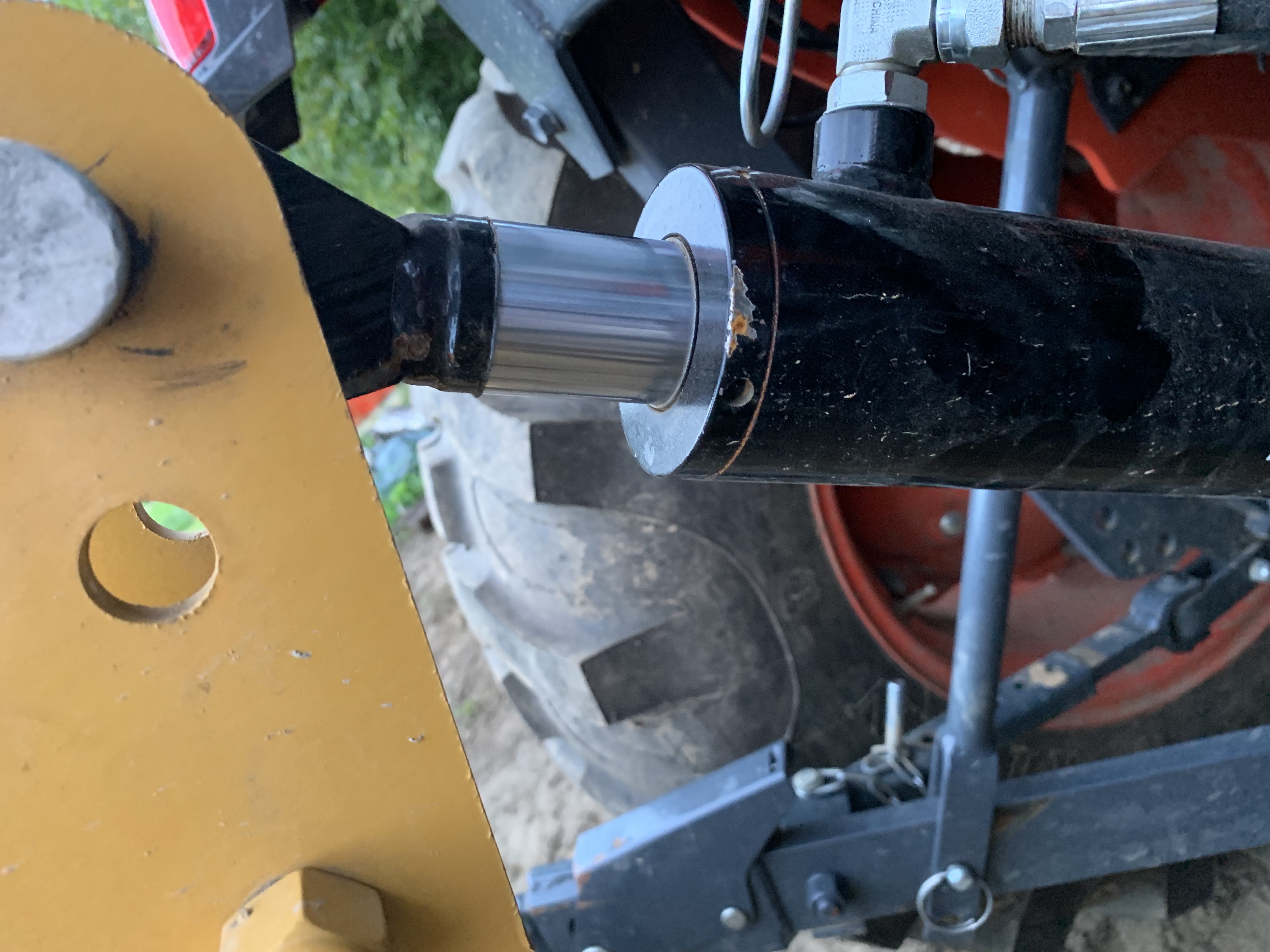

Cylinder disconnected from rear remotes. Its got a 1200lbs boxblade on it
Same test. Same boxblade. but I left the cylinder attached to the float-detent rear remote valve.
Timeframe on both was 2.5hrs. I am unsure if the "cylinder connected" test hit the ground before the 2.5hrs, but the implement was resting on the ground when I went out to check on it again at 2.5hrs.
   / Normal Kubota Rear Float-Detent Valve Operation? #14
This confirms that there is a definite problem with your control valve-s. :(

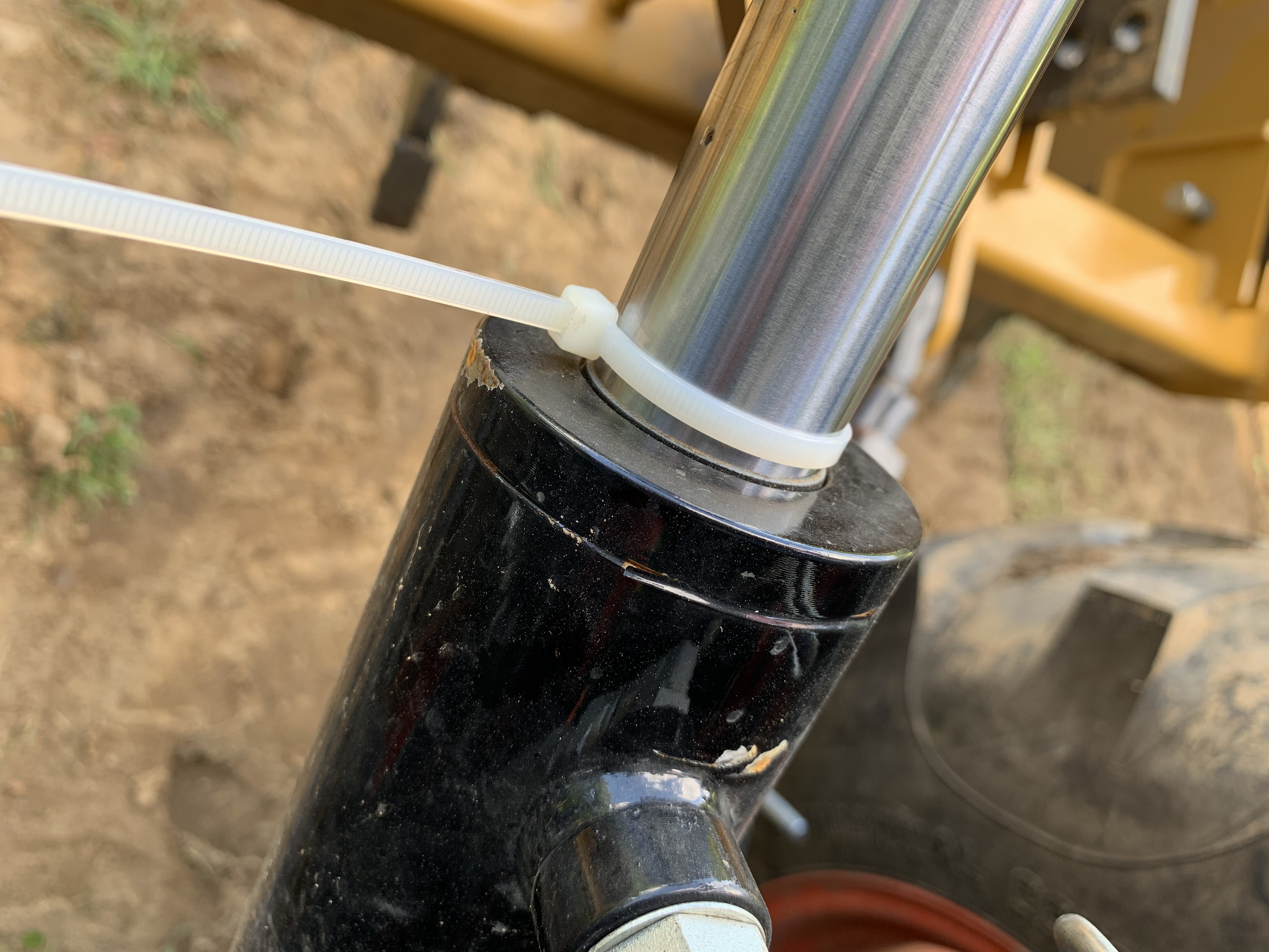

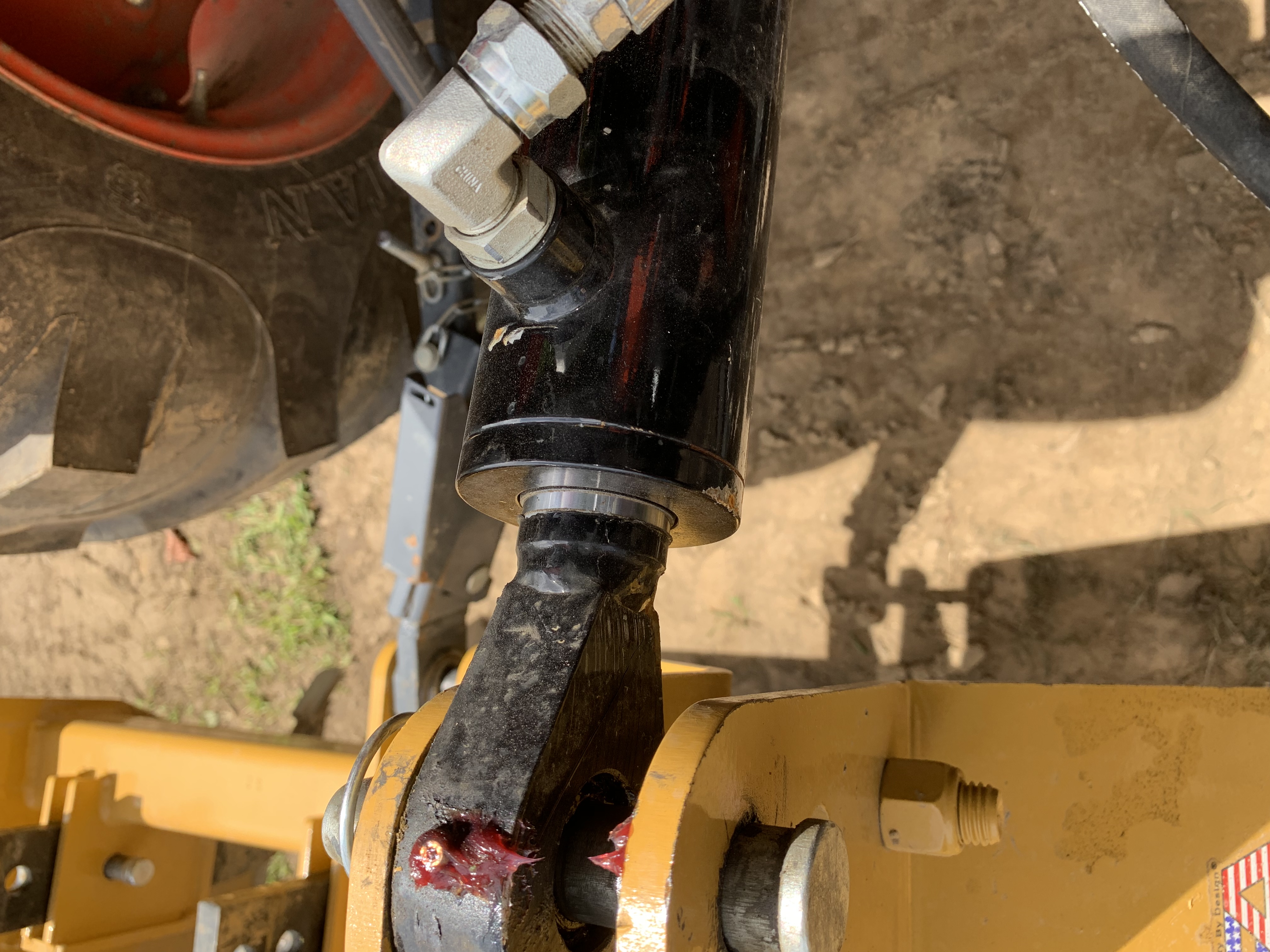

Here is the (1) position standard valve. Same test, same boxblade. 2.5hrs on the clock.
Start
2.5hrs later. aprox 3" of the cylinder showing
I have not done the center (2nd posistion) Float-Detent Valve. If the result is in between this result and the 3rd posistion float-detent valve, would you say that the issue is with the 3rd posistion valve in some manner?
