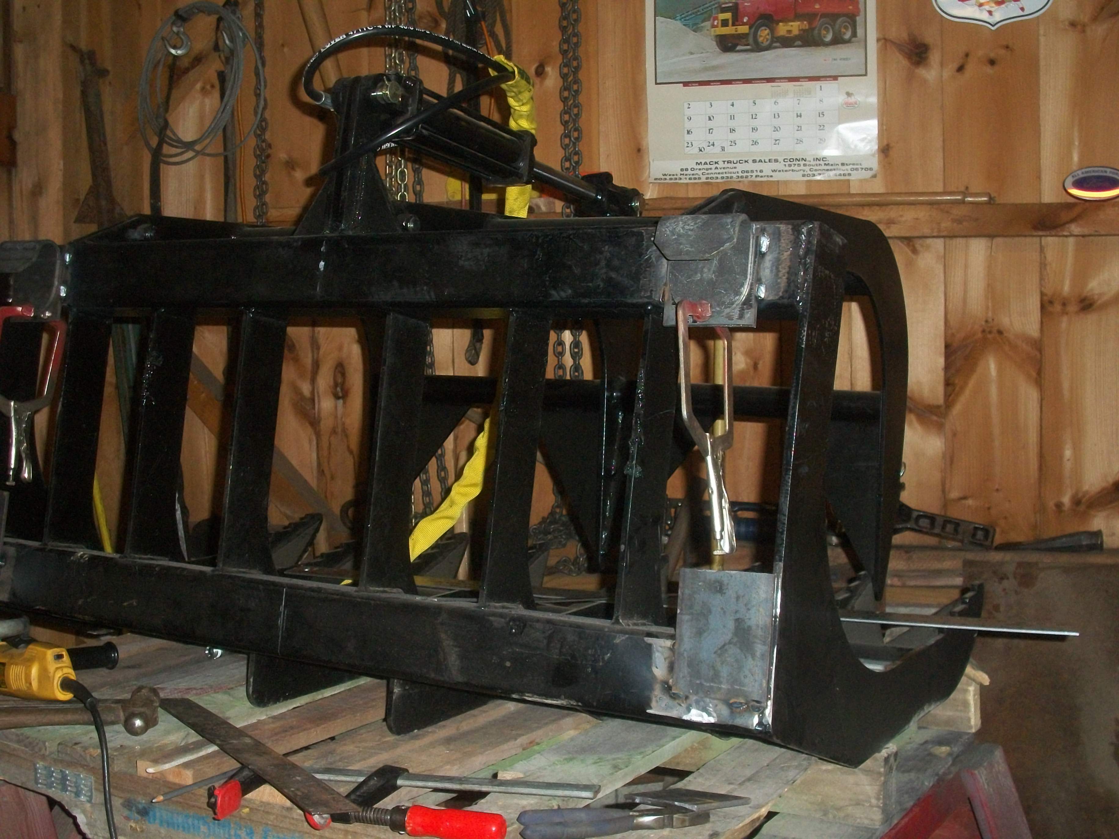

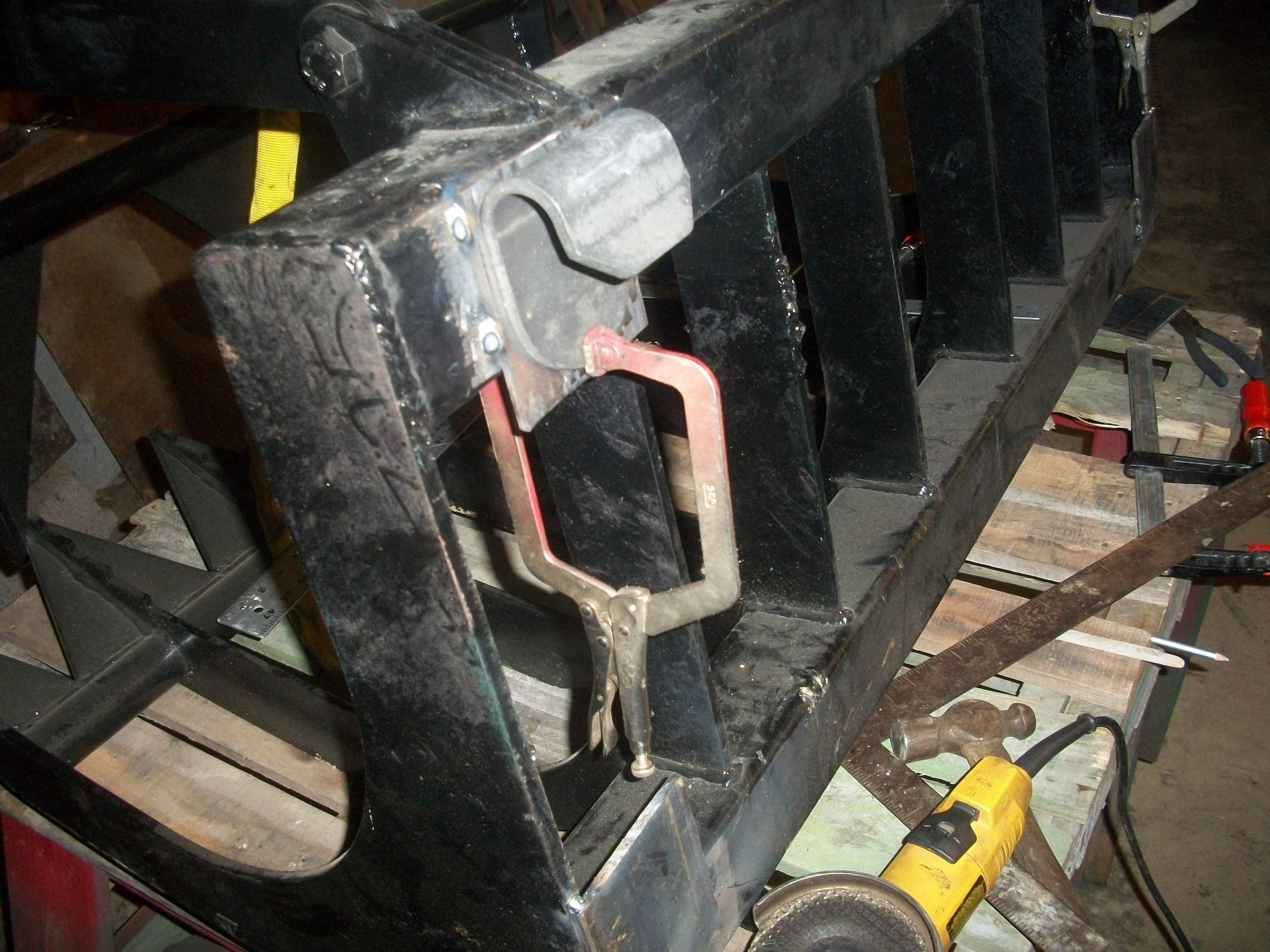

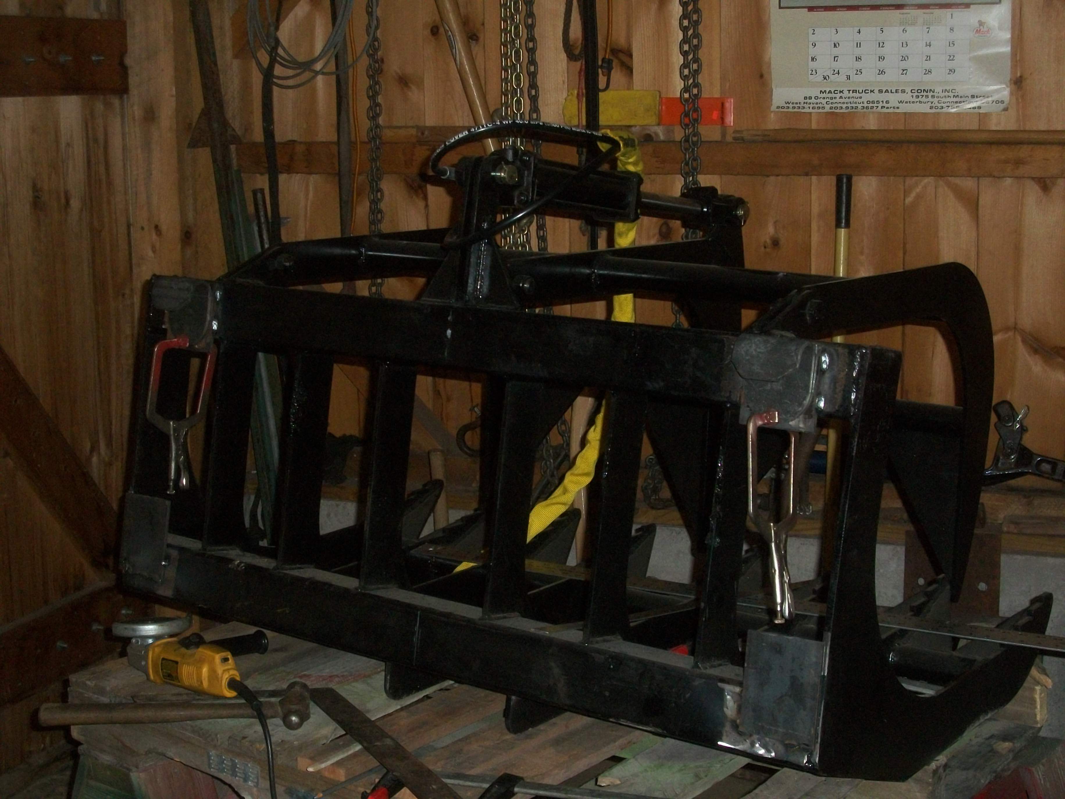

At that price, given I paid 667 delivered to MA., no doubt in my mind I would go for the Wildkat. By the way, I read some comments that their JD system was not the best fit so I got 50 bucks off and got mine without the mounts. I bought the JD hooks/pins and welded them on myself.
No nasty comments about my welding skills-I don't have any!:laughing:
