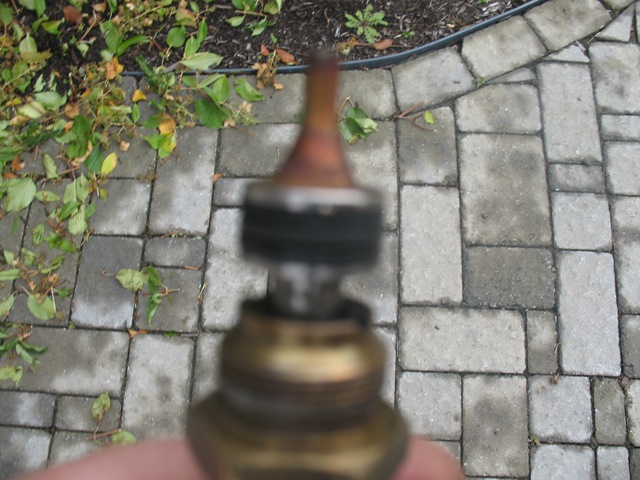

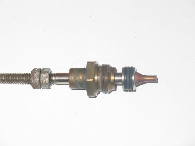

JB4310,
Thanks I'll try that next.
Gnash,
I didn't find anything all clean out.
here's some pictures:

Just got off the phone with North Star and they don't make this unloader valve anymore.
Am going to try replacing the washers from the local hardware store.
I'll let you know if it works.

update:
JB4310,
I checked the o ring is there.
I went to a Plumbing supply house --no good.
Pick up a oversized washer from the hardware store, amd tried to match it to the old one so I can cut it to size it came out ok.
I could not replace all washers--it's just the way it's made.
So I Put all back together and it worked released the trigger and that was it the pressure was gone again.
The pressure is a little stronger.
So am convinced it's the unloader valve.
Now it's time to find one.

they probably Do have an unloader valve that will work but you will need to buy a few extra fittings to adapt it to your machine. They can supply the fittings. what you have in the pictures is exactly how mine looks inside.
bob
   / North Star Power Washer problem #18
I'm by no means an expert but I do have 2 pressure washers, they can be a pain, one is very old but was a commercial duty unit, the newer one is commercial quality also but both have given me trouble.
Yours does sound like it's in that unloader assembly, maybe not necessarily with the plunger that you show in the picture but inside where the little ball seats.
Like I said both mine did the same as yours, with the newer Honda powered unit it was a combination of a poorly seated ball in the unloader and not high enough rpms on the engine, and on the old one just yesterday it was the o-ring.
Do you have any other leaks when you pull the trigger and also do you have the correct tip that came with the machine, if the tip was for a higher GPM machine then you would lose pressure

UPDATE:
Installed new unloader valve works great.
Thanks to all.
