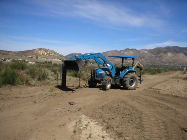

One of the dis advantages of a post hole digger mounted on the front end loader that I see is after you have dug your hole and you need to use the loader to set a pole in the hole. You have the phd hanging there in the way.
Another thing, a lot of people think of a hydraulic phd always being mounted on the side of a loader bucket or on a skid steer quick attach. there are 3ph hydraulic post hole units also. Myself, the only way that I would have a front mount auger would be if that was all that I was doing, digging holes, no installation of poles.
