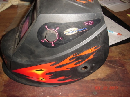

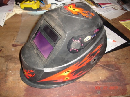

I need to let ya know mine just broke, it took a year.
I was doing some tack welding and didn't notice anything till later that night, my L/H eye was hurting and I tried to figure out what was up all night and the rest of the next day.
I decided to test the helmet with just a flashlight and much to my surprise it was not working correctly, it would go dark but then lighten up, so I decided to file it away in the trash and my GF is getting me a Miller Elite for XMAS.
Here is a pic of it before it hit the trash. I removed the headgear and put it back on my Jackson.
