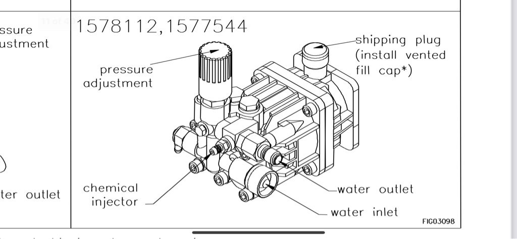

Hope someone maybe able to help - I have had the subject power washer for several years but the last few times I have used it I have noticed water continuously squirting out of a small 90 degree nozzle/hose barb that I do not recall happening when new.

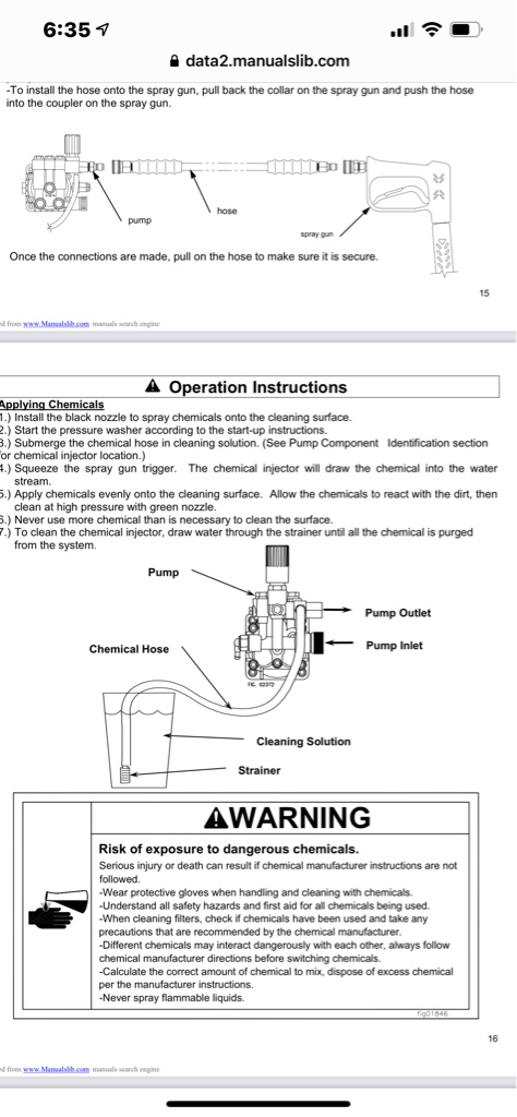

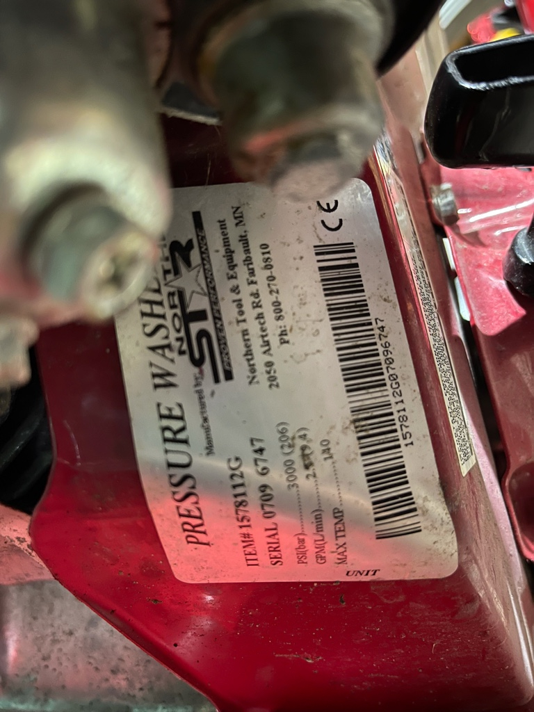

Attached are a few pics of the PW -
In the picture that is more of a close up of the pump - the water is flowing out of the small black barb on the lower left of the brass pump casing.
It can also be seen in a few of the manual drawings.
Any insight as to why this is happening - if it should or should not and if not what do you think the repair is would be greatly appreciated.
Thank you!

I would say that the black barb area is part of the thermal relief valve. Suppose to open when the internal water temperature exceeds around 190 degrees. After working on pressure washer and their pumps for close to 20 years, sometimes parts can be hard to track down, and the pumps with the aluminum heads are about cheaper to just replace the pump or the entire pressure washer.
Most common issue with the brass head pressure washers is unloader valve issues causing low pressure in most cases, followed by damaged check valves and water seals.

Tracked down the part - Thermal relief valve - no one really has it in stock but Comet Pumps but I found an online shop that can get it from them and ship it to me for less time or money than Comet or other stores. It’s a $12 part but most places want $30-40 for S&H. Sorry no go with them.

Thanks for all the feedback. I took a chance at a local NorthernTool and they had one in stock by chance. The. Lack hose 90 was cracked at the barb but otherwise they said it should be just fine. Total cost $5.
I also have one on order that will be here in 10-15 days. Son is happy he can start work now!
I was thinking the same on the - can use most any - online. This confirmed it for me.
