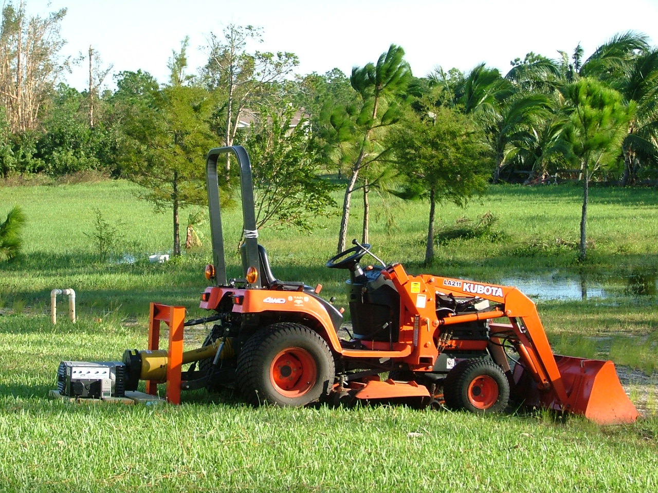

I have the same generator run it 24/7 for a month during the storms here in florida, very good unit, get it. It will be getting it ready just in case for this year.
