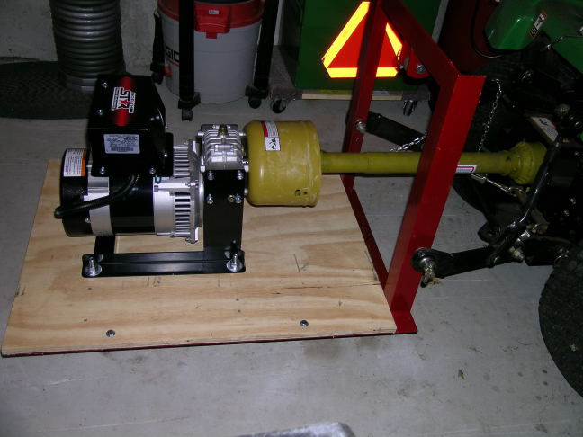

#13
Here is the unit mounted to a carry-all. I put some small casters on it to make it easier/faster to mount. Plus, I put a couple of 2x4's across the underside of the plywood to give the 5/8 inch mounting bolts something rigid to bolt to. Runs like a champ. The tractor needs to run at around 2700 RPM to bring the generator up to the correct voltage (120).

   / NorthStar PTO generator #14
check out www.generaljims.com
look under generators then go to gas generators.
They have raised the price to 795.00 since I bought mine
this spring. These are just the gen head and pto gearbox.
You have to come up with your own mount as well as an
electrical panel with plugs and circuit breakers. After I built
my own panel and dumped about $70 bucks in plugs, a panel
box and breakers I found out surpluscenter.com had a variaty
of pre made generator panels for dirt cheap.
