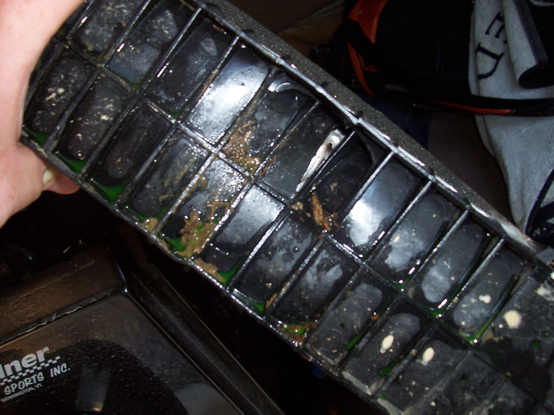

Well about 85% through the project of regrading my back hillside I managed to shove a small stick backwards through the bottom of the radiator on my DK40se. Yikes! I still haven't pulled the radiator to see if it's salvageable, but I'm thinking this is going to be an expensive backyard project!

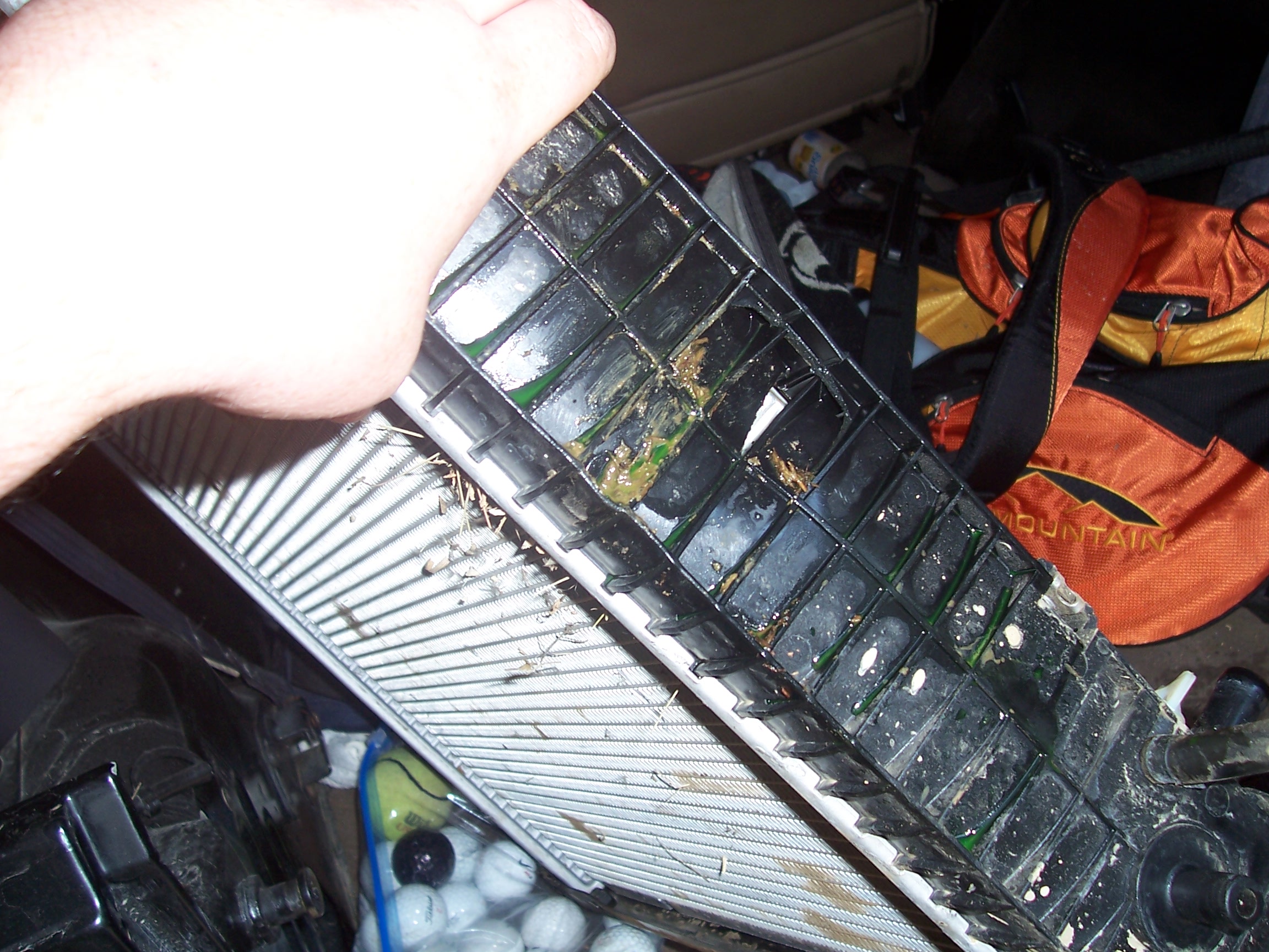

well i pulled the radiator. It's not bad at all. Only the plastic is cracked. Any thoughts on someone who can fix it?

I would call a KIOTI dealer and see if you can get just the plastic tank. I don't know that a tank busted like that can be fixed.
Me personally would fix it right with another tank or complete radiator. The cost of the radiator is nothing compared to the cost of an engine repair if it gets run hot, by trying to get out the cheap way.

I sent it out to have a new aluminum tank built to replace the plastic parts. amazing that everything is plastic these days. It should come back BETTER than new. FYI a new radiator is well over $500, having a whole new tank built will be around $225. A big difference and I should end up with a better product.
Kioti and nearly everyone else doesn't sell parts for their radiators> I guess they assume most people really trash them when they break

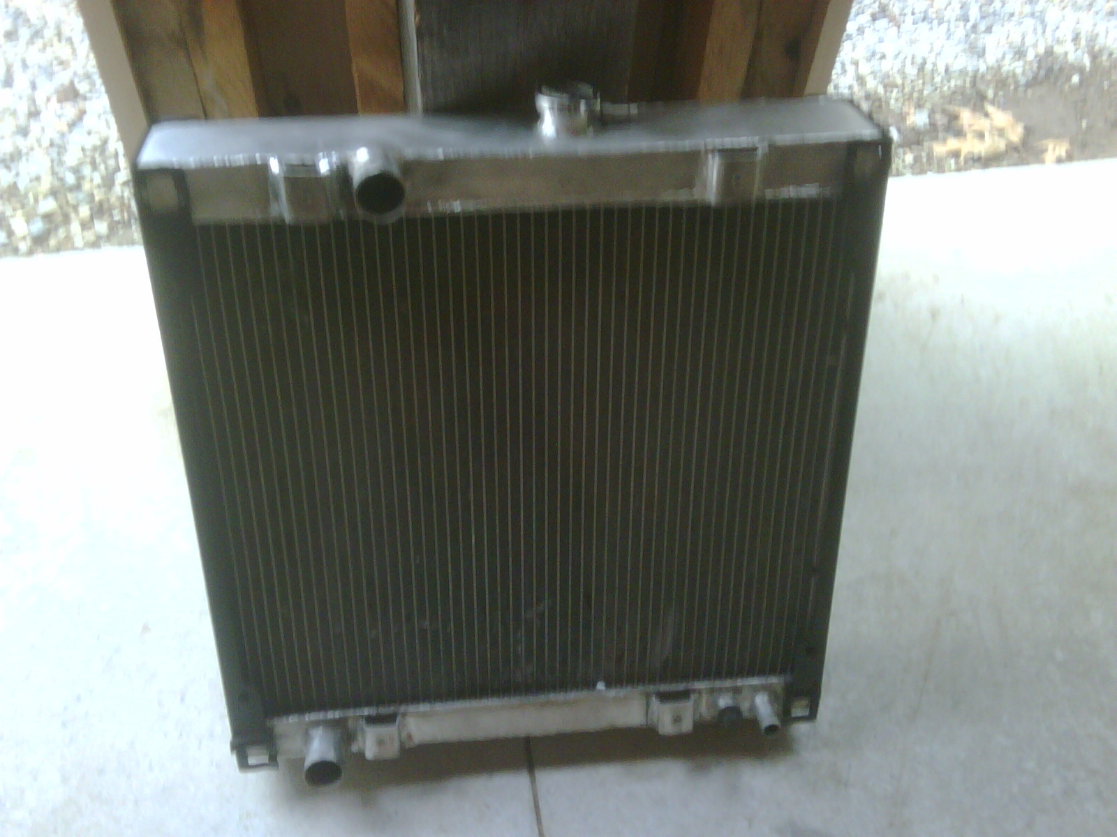

well I haven't gotten it back yet, but I sent it to Myler's Radiator Repair in West Jordan Utah! They've done some custom work for me in the past for motorcycles, and they did a great job. So here's to hoping, I'll post a review of their service when I get it back

If it is just a crack in the plastic, why not consider doing a plastic weld or just using some epoxy putty to fix it? I've been impressed with a cheap plastic welder from HF (sorry Dargo). It really is not hard to do so long as you are not concerned about cosmetics. You'd have to know what type of plastic you are dealing with but that is not very difficult to figure out. If you don't trust HF there are other welders available (I don't necessarily trust them either but I figured I'd try out their plastic welder before investing in something that costs three times as much to see if the technology/skill level was something I could handle).

Well it just got interesting. The shop just called it arrived with the top tank destroyed. Despite paying the shipping company to wrap it ($16) and ship it ($41) with fragile stickers on it it still arrived in pretty bad shape. The good news is that FedEx should pay for the additional work, the bad news it will take a couple of extra days.
Plastic weld wouldn't work there was a pretty good gap, and a crack along the plastic. Aluminum is worth the price just for piece of mind.

A GIANT thank you to Myler's radiator repair in West Jordan Utah. My crappy plastic radiator is completely rebuilt out of Aluminum, back in the tractor, and running perfect!!

Beautiful job!!! I have also noticed on the later NH TC 48, and TC 55 tractors, they don't have the all metal radiators like mine and my neighbor has. They now have the plastic/aluminum.

It's not easy to impress me, but that is truly the work of a skilled craftsman and it's nice to know there is a place in the USA that can do that kind of work. Thanks for sharing.
