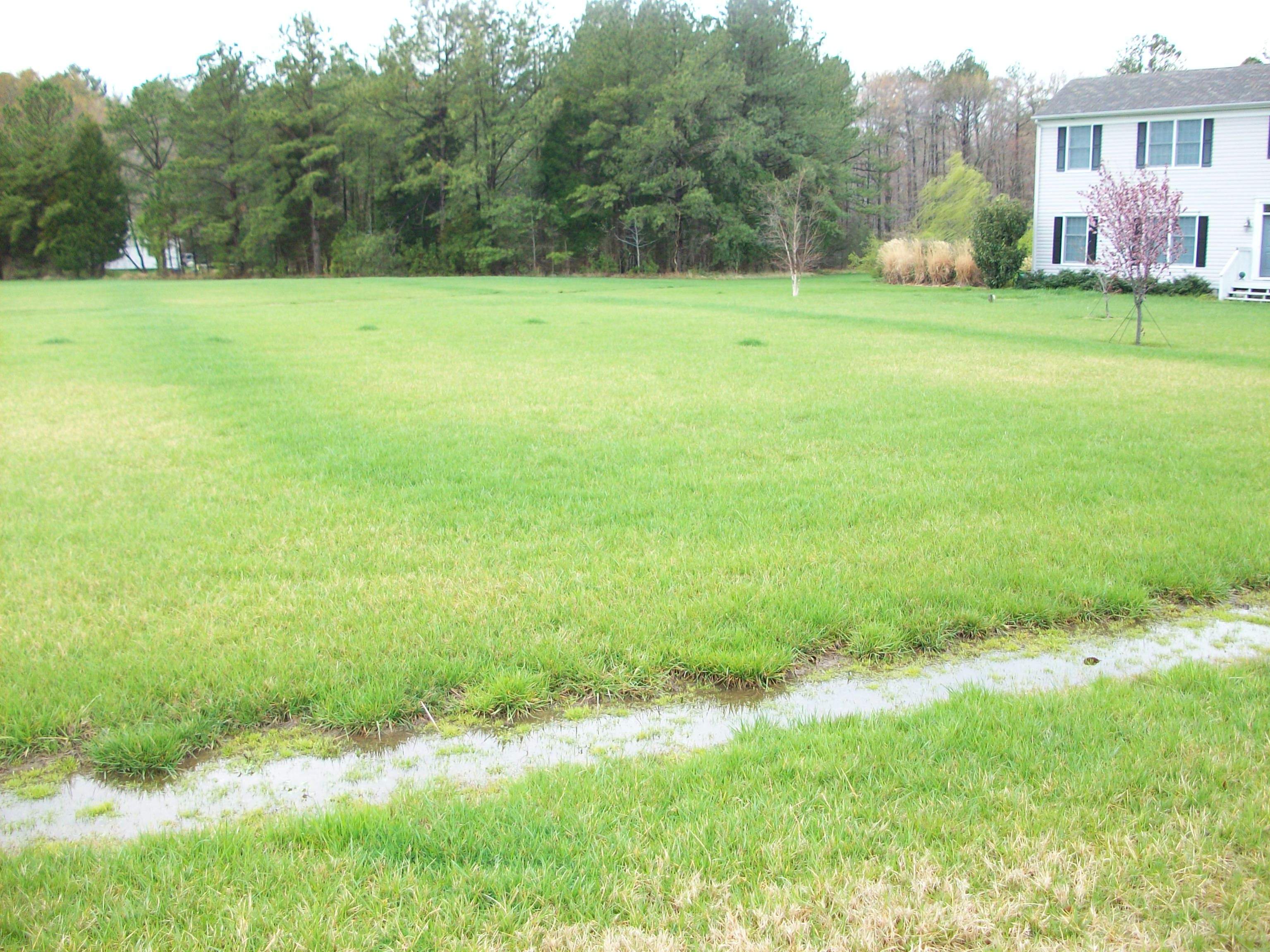

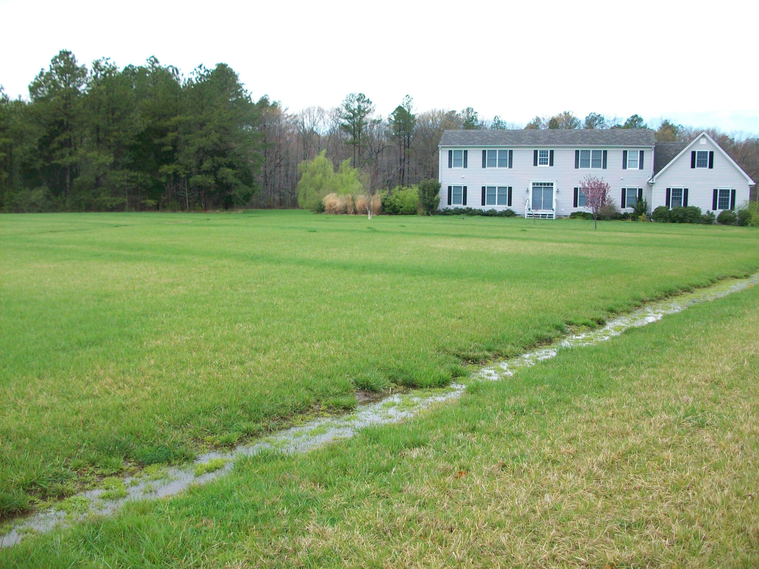

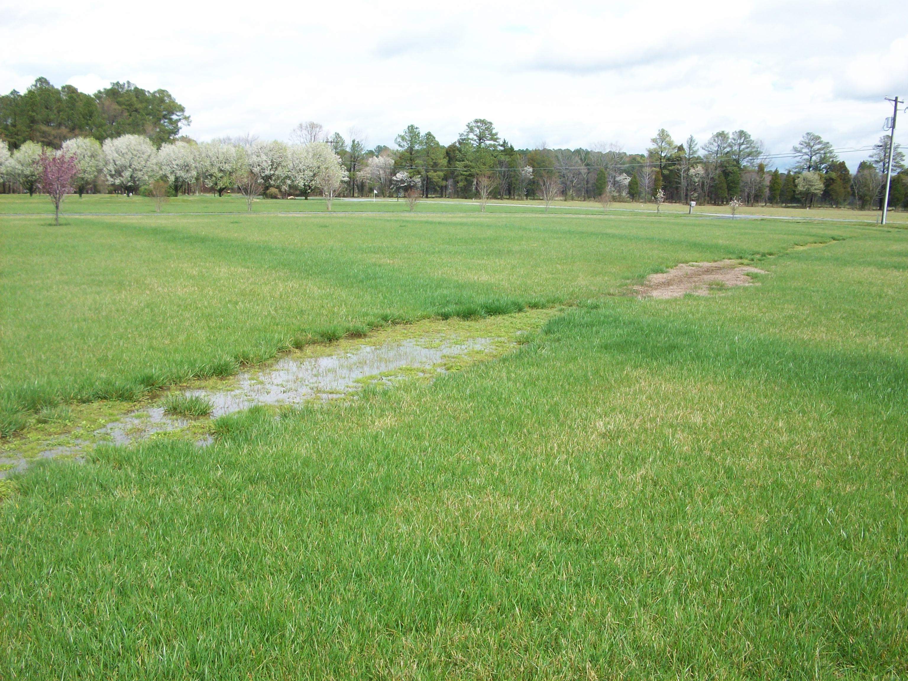

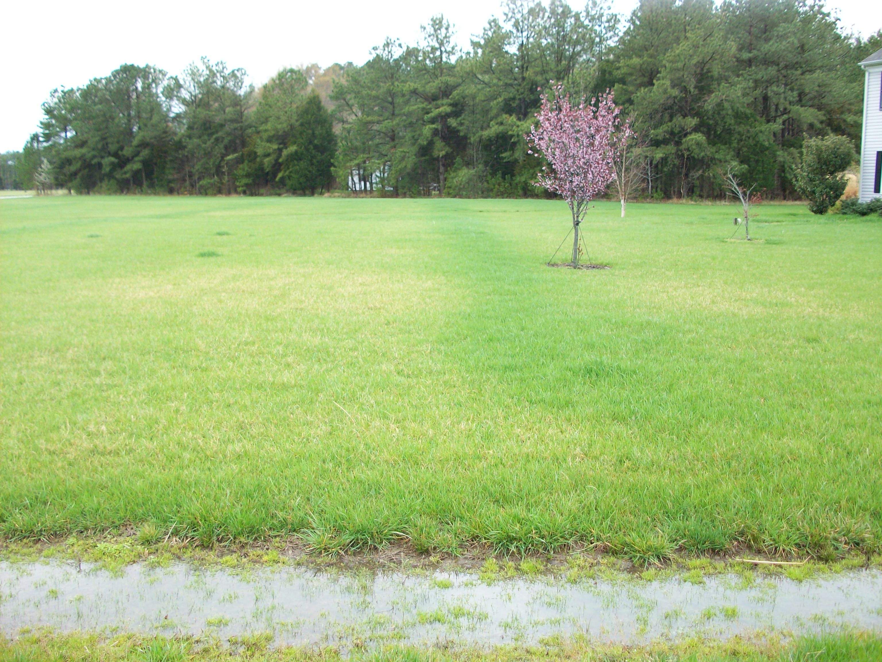

Here are the pics of my problem. When I started I followed the road ditch to get a straight line going and there is a strip down the edge of it and about 45'-50' over is another strip so that tells me that the spreader is throwing too much to the outside and not enough in the middle. That is the width of my traveling back and forth in the yard because the throw is about fifty feet. I'm sure there was over lap but the strip down the side of the road ditch without any overlap proves too much to the sides. Sorry I didn't take a picture of the ditch, I didn't figure it out until after I left the property. Hopefully I can get the spreader set correctly if that is what the problem is.

Did you try checking the spread pattern with sand? I dont know the LP 1000 details, but my befco not only has fin adustments on the plate but also seperate L and R gate control adjustments... Maybe start there and watch the overlap.. Have someone watch you put it down and flag the end of the spread with those little landscaper flags? Just thinking out loud. You have me nervous about my unit now:eek:
   / Not happy with spreader performance
#20
No I didn't check the spread pattern I didn't think I needed to. I just wanted to know how far it spread. The R and L gates were set to open the same amount at the same time. Didn't touch the fins because the manual says to adjust them to throw more right or left by placing in the four different holes. First hole throws more to the left and the forth hole throws more to the right. There are four holes so there's no middle range. Right now they are in the second hole which is more to the left. I re-traced my path and if I had strips every other pass I'd know it was the left side that needed adjusting but its not. I called the dealer and he didn't know whats going on. Like I said before I've always used a broadcast spreader and never had this problem before. I hope I've overlooked something very simple and I wouldn't be ashamed to admit it. I'll let you know if I find out what the problem is whether it equipment or operator error.
