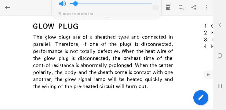

There is this interesting comment from Mitsubishi on their glow circuit.
I have yet to figure out which wires are the heat and timer wires on mine- either that or they are missing. Screenshot_20190427-080436_Adobe%20Acrobat.jpg
