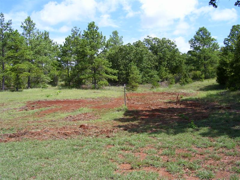

As you approach a high spot, the front wheels of the tractor go up first, making the box blade dig in deeper and scoop up a box full of dirt. Then when the back wheels track over the high spot and the front wheels are heading down hill, the box blade goes up in the air and empties its load at the top of the hill. In no time at all, I took a relatively flat arena and turned it into a motocross track!!!!
A little technique is involved. If the high spots are that high then you need to go over them with the BB up, then set it down and take off the top. Takes a few trips depending on the size. In the pic below(bummer no before images), on the left side where the clay is darker, there was a hump there about 1' or better high. Like someone dumped a FEL load of dirt there 10 years ago. I had to get on top of it, drop the BB down to get a bit on it. Took several passes with the scrapers down to bust it up. But once I got the rought spots down it was going over and over to get it pretty good. My first real BB effort besides just dragging an ATV trail. In thepic to the right of the T-post going up the hill there was a ditch cut there. Just in behihd the T-post was a washed out hole about 18" deep, couldn't mow across that.
Rob

Since you have a rear blade, set it just barely off the ground and start going in circles. If you have large ditches in the plot, go across them at a 45* angle. Don't adjust the blade for that setting. As you go around and around you will knock off the high spots into the low places. It will take a while, but it works well.

The guage wheels help a bunch. I got much better results with a rake & wheels on my pool removal project than with the rear blade & no wheels.
However, I was in a rush & I was really only getting the area "flat" but not "level". By "flat" I mean locally smooth. By "not level" I mean I still had an area that was high & one that was low. I couldn't see the difference unless I stood back a bit. The ability of the tool w/ guage wheels to level is in proportion to it's wheelbase (why road graders are so looooong). Anyway, If I weren't rushed, I would have stood back to guage generally high & low spots & then marked them with spray paint to add/subtract dirt as necessary.
I did the rough grade w/ the rented hoe & 4 in 1 bucket. Scraped off the high spots with the "clam", spread it rough with the "dozer". Smothed it out by backdragging. Then I used my tractor for the finish grade - filled the low spot with the "spoils" from the rake - It's still a little low, but better
You can see the low spot up & to the right from the hoe (straight under the apple tree)
