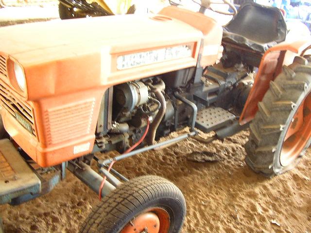

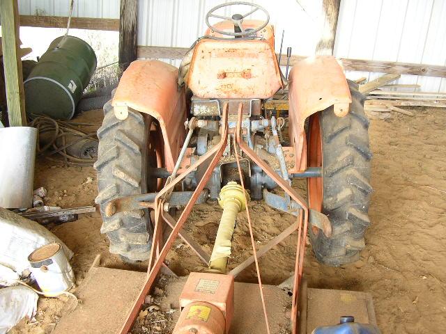

tree grower said:
I don't own one, but there are lots of Kubotas in VT, and the older ones are all blue--only the tin is orange.
Yep, I guess the blue went to gray. this one is a L175
