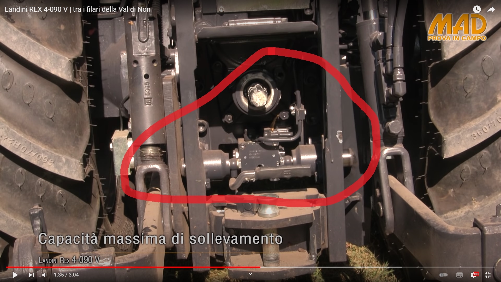

You'd think with well over 100 years of tractors that would be available.
Which tells me how spoiled we are. Farmers did these things with horses and mules.
It is available. There are tractors that even have hydraulic stabilizers along with the hydraulic side link. Typically available in specialized tractors for vineyards and orchards.

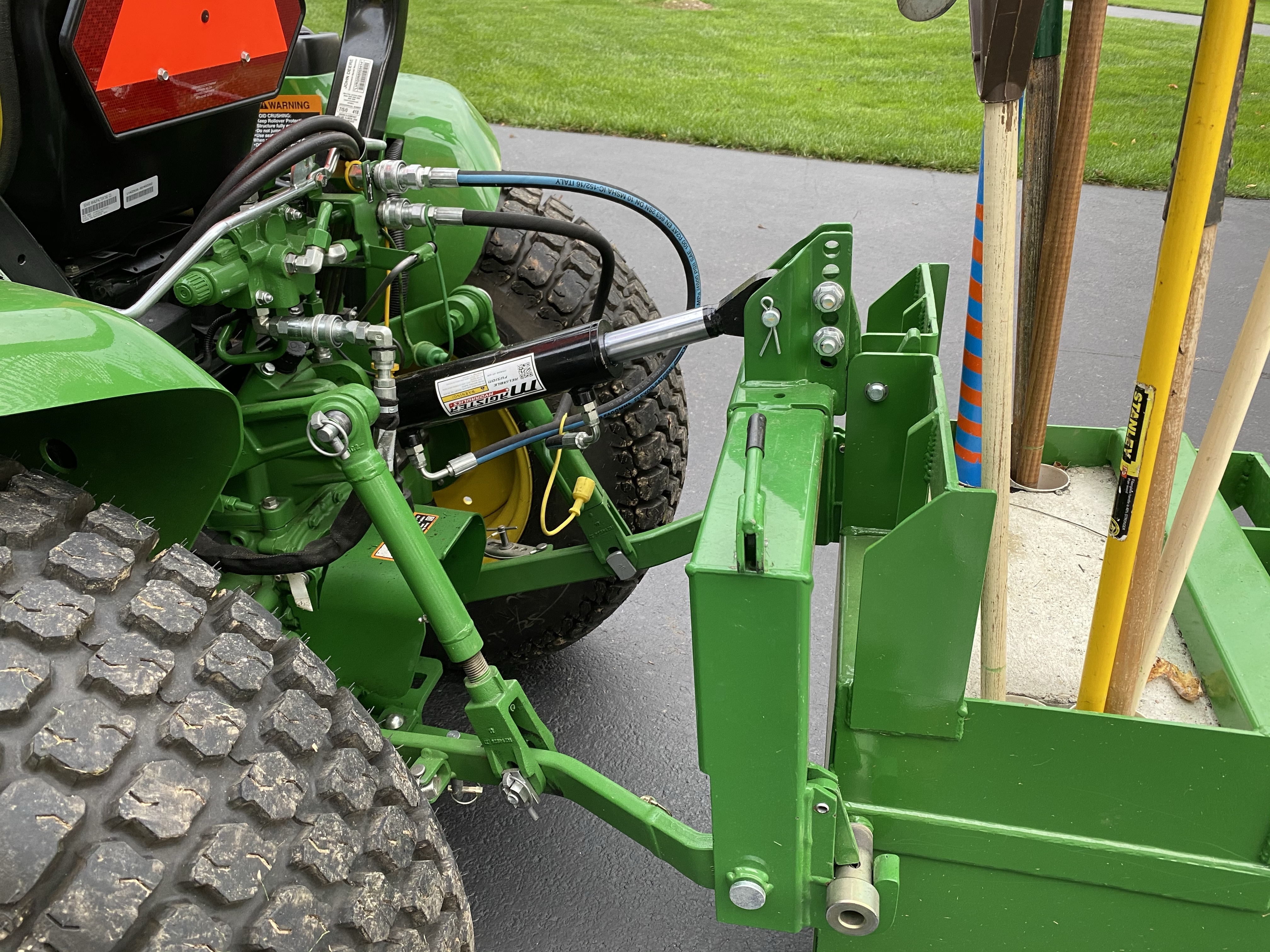

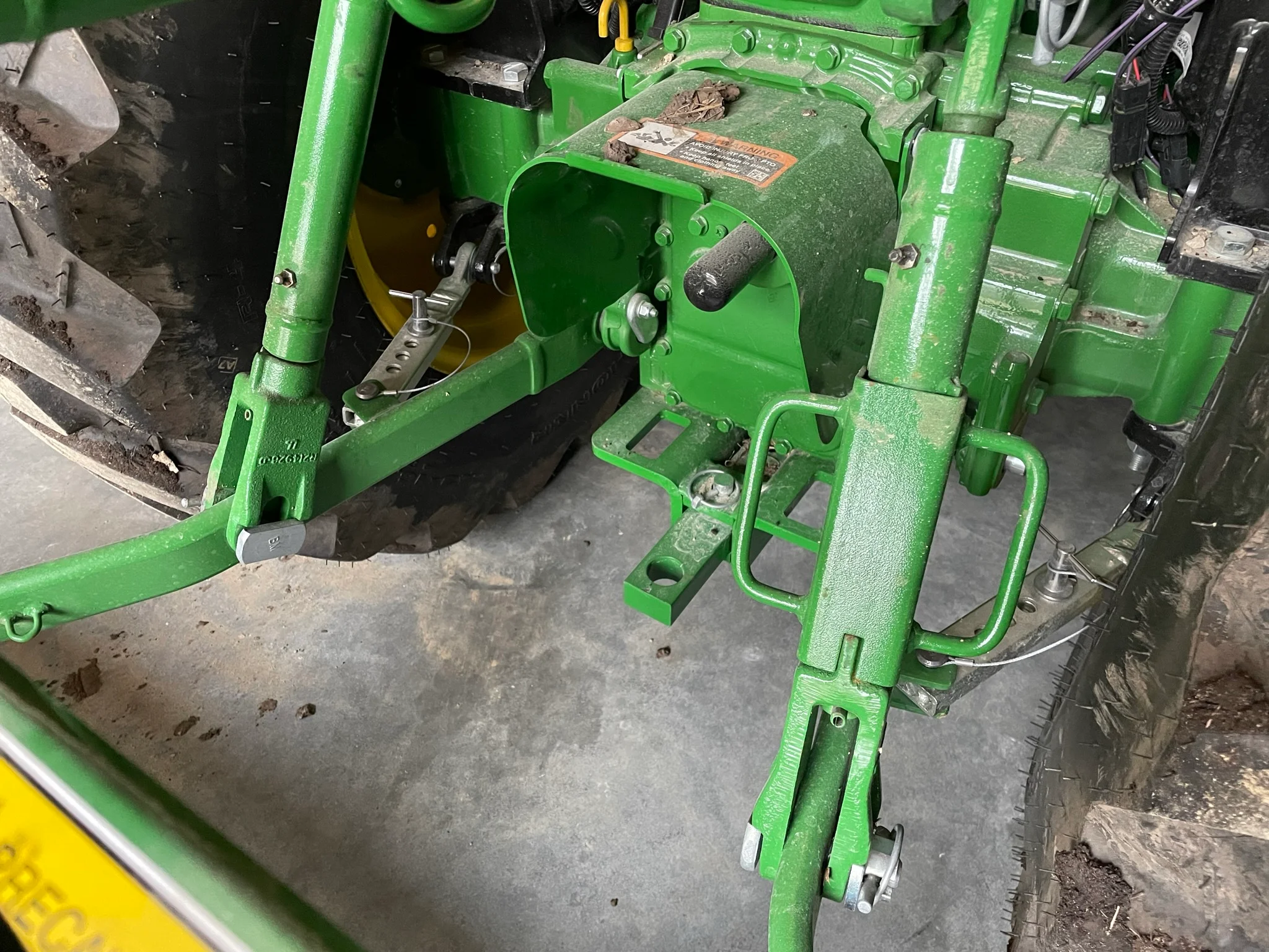

I've owned 3 Deere's (3033r, 855, 750), and all had two different positions for the pins on the connectors between the rockshaft arms and lower link arms, one of which allowed the lower links to float or lift independently.
On the 3033r, you just turn the lower link pins a quarter turn.
Floating:
Fixed:
Note the keyway slot type pin head is turned from vertical to horizontal. It's right there in the manual of every tractor I've ever owned, although the exact hardware used is slightly different on each.
Is this something only Deere does? I can't imagine having a tractor without this simple feature.
Pretty interesting setup but I have never noticed that before. It sure doesn’t appear that by turning that pin you would be able to lift one arm 4 inches higher than the other but because you would be measuring at the end of the arm maybe 4 inches would be possible.
My LS does give you 2 holes to choose from in the lower vertical arm, they are about 1 inch apart and the pins are bolts with self locking nuts, they are not even mentioned in the owners manual other than to say be extra careful if you remove them because the 3 point hookup parts are pretty heavy.
   / Not to Brag, but... #39
I've had this feature on every CUT I've owned, but they were all Deere, so maybe it's just a Deere thing. I honestly thought all tractors with 3 point hitch had this feature.
How does an implement like a plug aearator or even rear snowblower ride the terrain, if it's fixed to the rear axle attitude? Everything here is hilly, even our driveways and parking lots. :D
I didn't measure, but I'd guess it's probably pretty close to the 4" I claimed, at the end of the links. The slot is roughly 2" between centers, and positioned at roughly half the link arm length. But the exact inches of free play wasn't so much my point, as the fact that you can lift one link arm to meet the pin on an implement, after the other is already connected.
