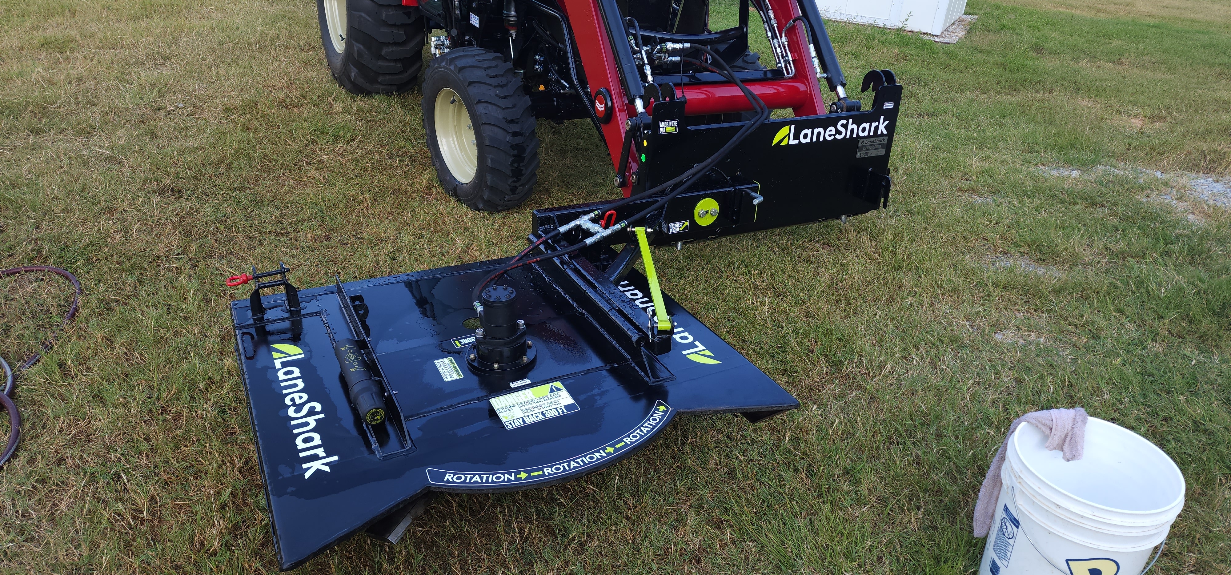

Funny I have a Lane Shark which is a shredder that mounts on the FEL and has multiple positions. It runs off the tractor hydraulics. Has a hydro motor. I'm not a seasoned implement changer and did not know that if you disconnect your stuff when there is line pressure at the couplings, when you go to re-connect, the pressure will not allow you to get the coupling to seat.
At the job site I'm looking it up on my phone. Fortunately I was by myself or it may have been a bit embarassing.
The answer I got was to crack the suspect line fitting with a wrench to release the pressure. That's after actuating all the controls so everything was settled.
I had a large adjustable wrench but found it easier to simply wack the end of the coupling with the handle of the wrench. This wrench had plastic coating so it can't damage the coupling.
The male has an exposed pin. Tapping it briskly a few times released the pressure.
Hooked up easily then. The key is to have the pressure off before disconnecting.
This almost always works, but can be varying degrees of messy, and in cases where pressure is very high or coupling large, can get more difficult.
They make couplings with a screw plunger in them, designed to relieve this pressure, but I made my own for the cost of an eye bolt + NPT plug + spare coupling. Drill and tap the center of the NPT plug with the thread size of your eye bolt (3/8-16 NC works nicely), and then screw the whole assembly together. Works great!
I used to keep mine hanging on the shed wall, where I change most implements, but lately it's been traveling in the toolbox on the tractor.
Hooked up easily then. The key is to have the pressure off before disconnecting.View attachment 3740183View attachment 3740186
I looked at one of those for my JD 5075E, but was told it would tax my Hydraulics, and I needed to get the one that a Hydraulic motor mounted to my pto to run it. Great for Ponds and Firebreaks! I also learned that lesson about the lines with my Grapple. When that happens to me, I crack the T's and it connects right up.
