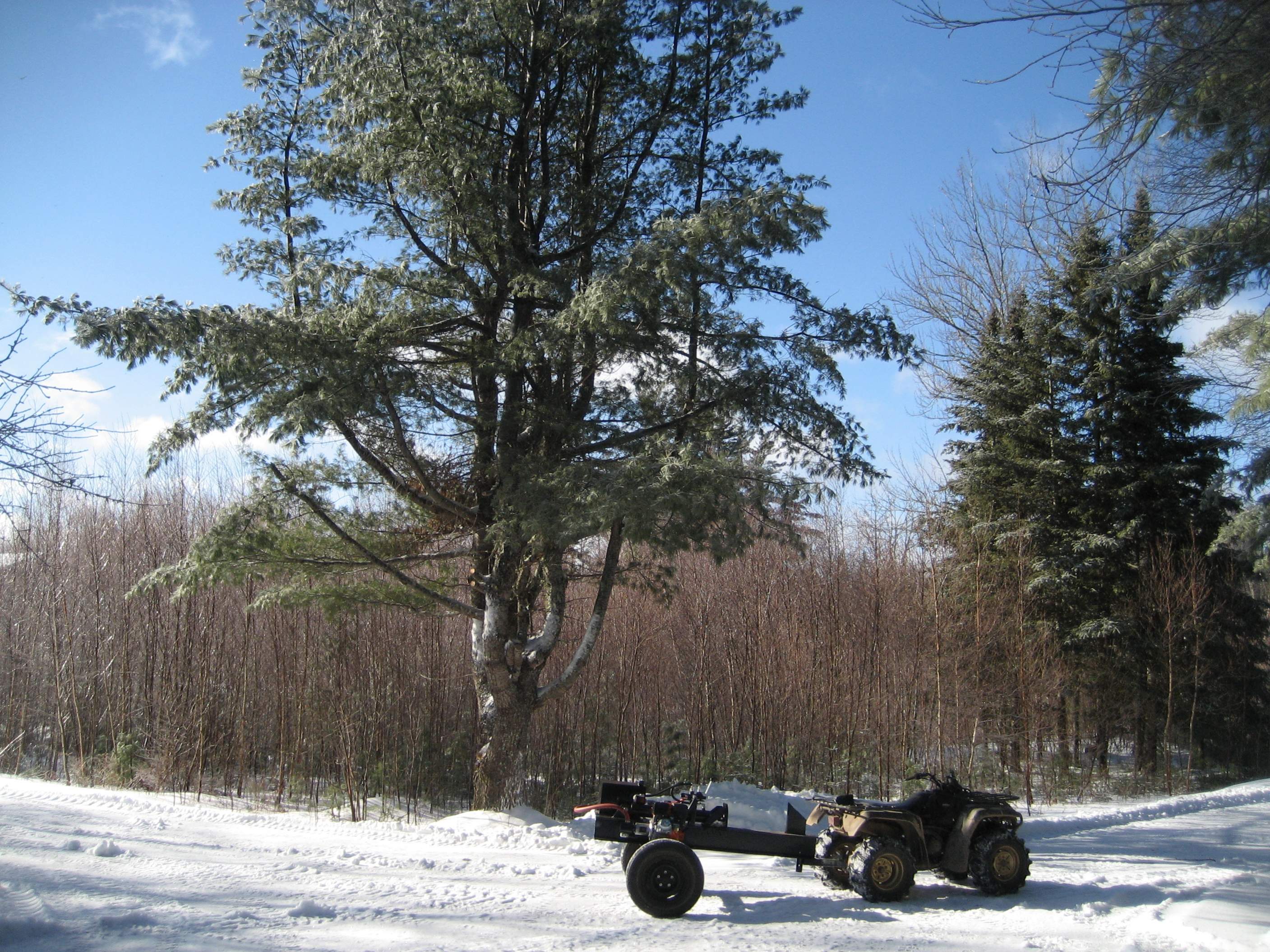

i tow mine, but you have to go SLOW, like 50. Otherwise its all over the road, and its beating itself up. No suspension on mine.
As to width, id go the max that fits into your box. Id say mine is 5' maybe, but it'll fit on my trailer if i have to take it any distance (more than 30 kms.)
   / Nother woodsplitter build
#32
That sucks about the towing bit..I probably shouldnt bank on the fact that i can tow mine at highway speeds then..i better cut another foot or so off the axle to be safe and have it down to a size that will fit in my truck or trailer..

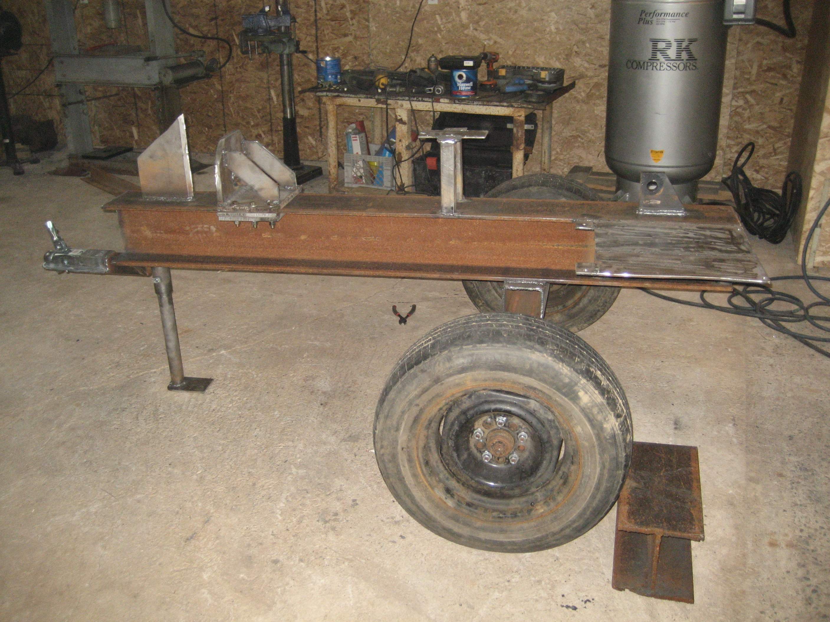

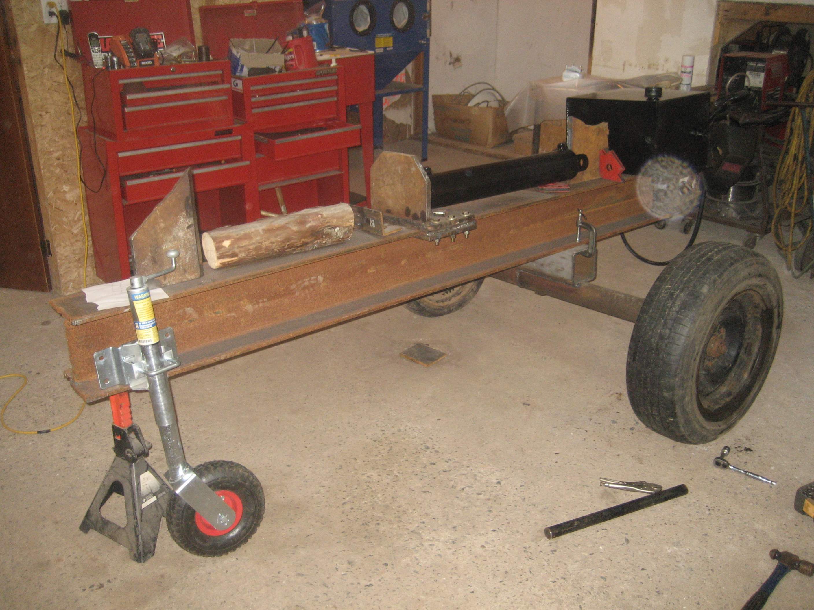

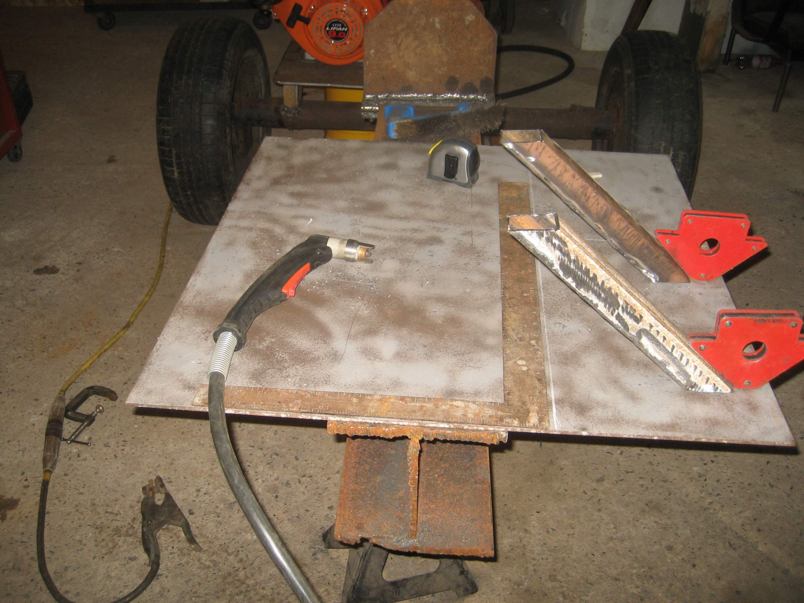

Thanks for the insight Scooby..i figure with a set of lights i wouldnt get bothered too much around here either..but i did cut the axle down so it is under 5 feet with the wheels and will fit in a truck of trailer if need be..
Couple pictures..The axle is just clamoped in place till i get all the expensive componets. I figure that way i can just move the axle back and forth till i find the right balance.

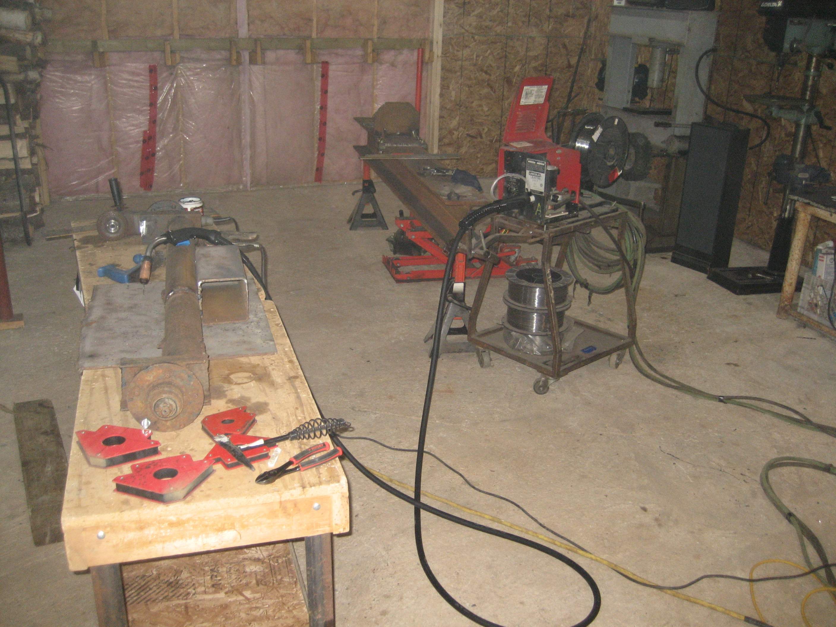

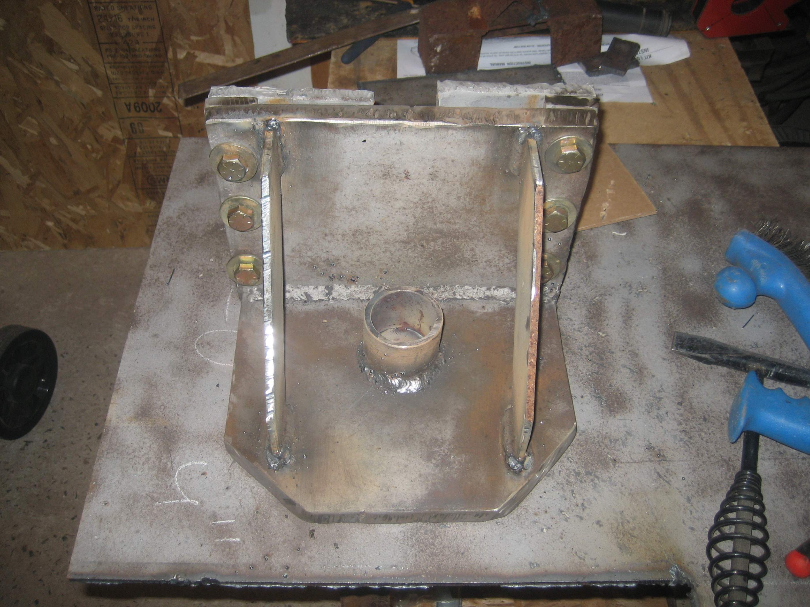

There is nothing cheap about building your own splitter..I have around 250 + in steel already and my mig gun bite the dust so i had to buy another one..Oh well works great now...

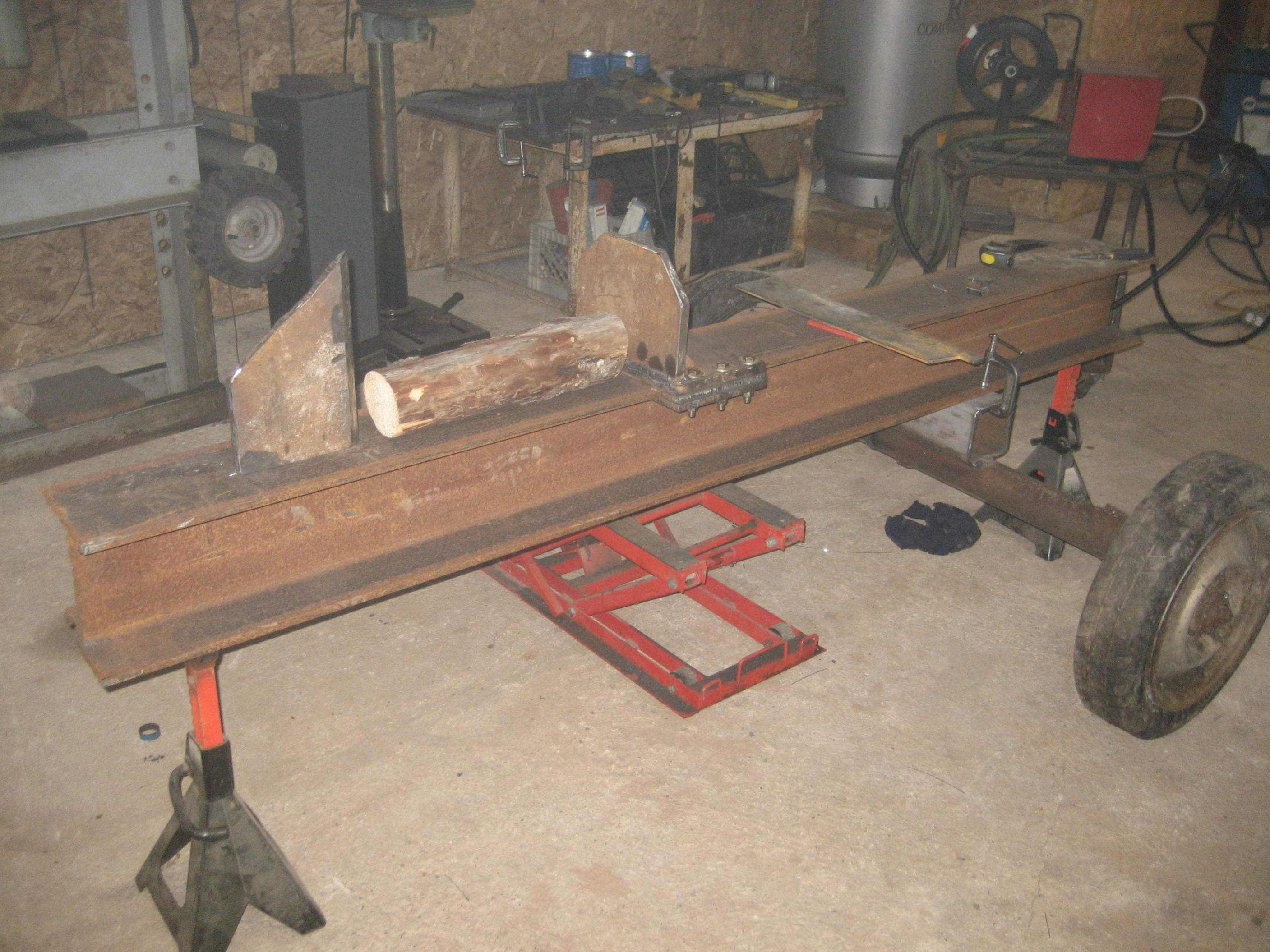

where she stands as of today..

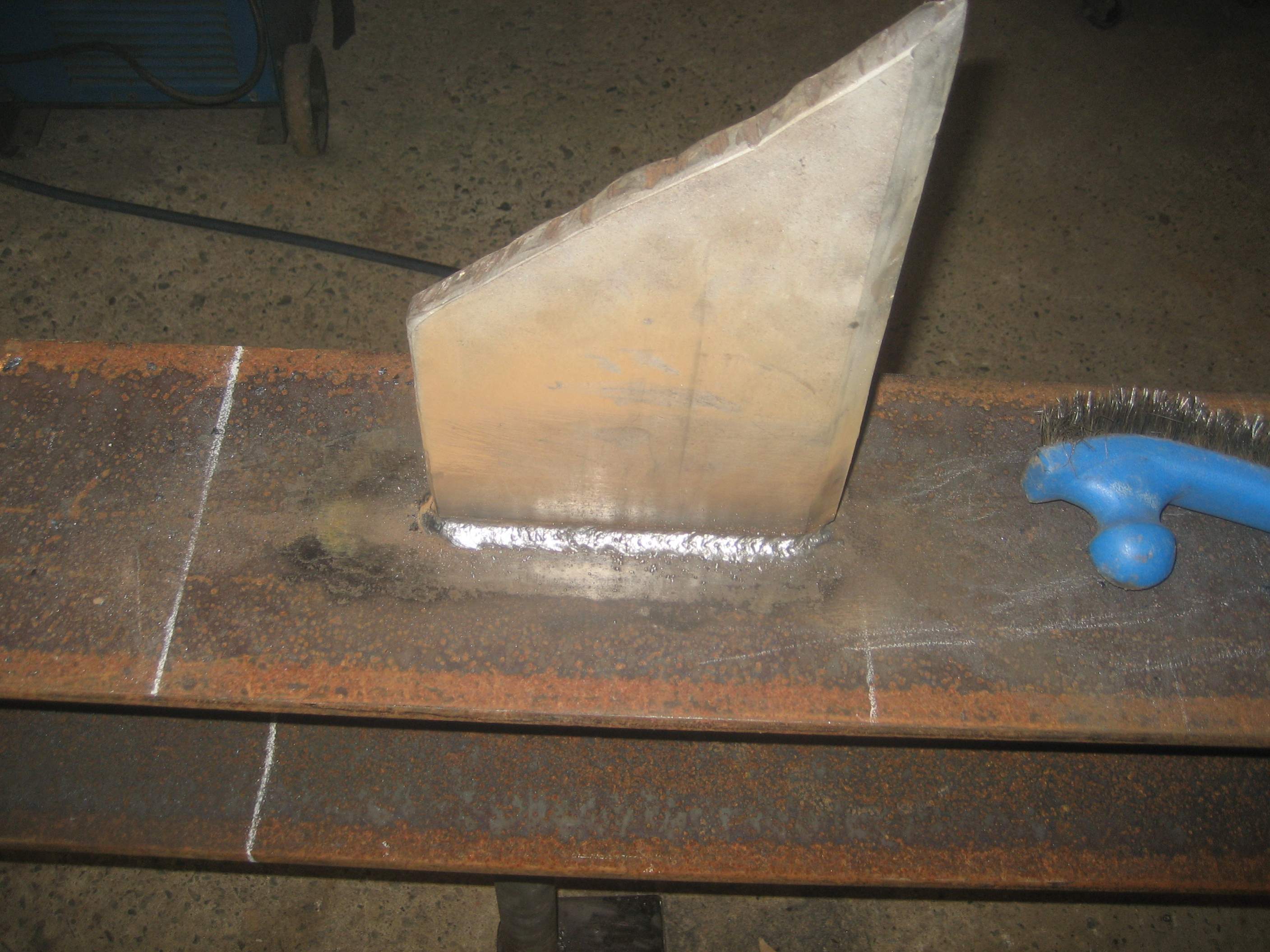

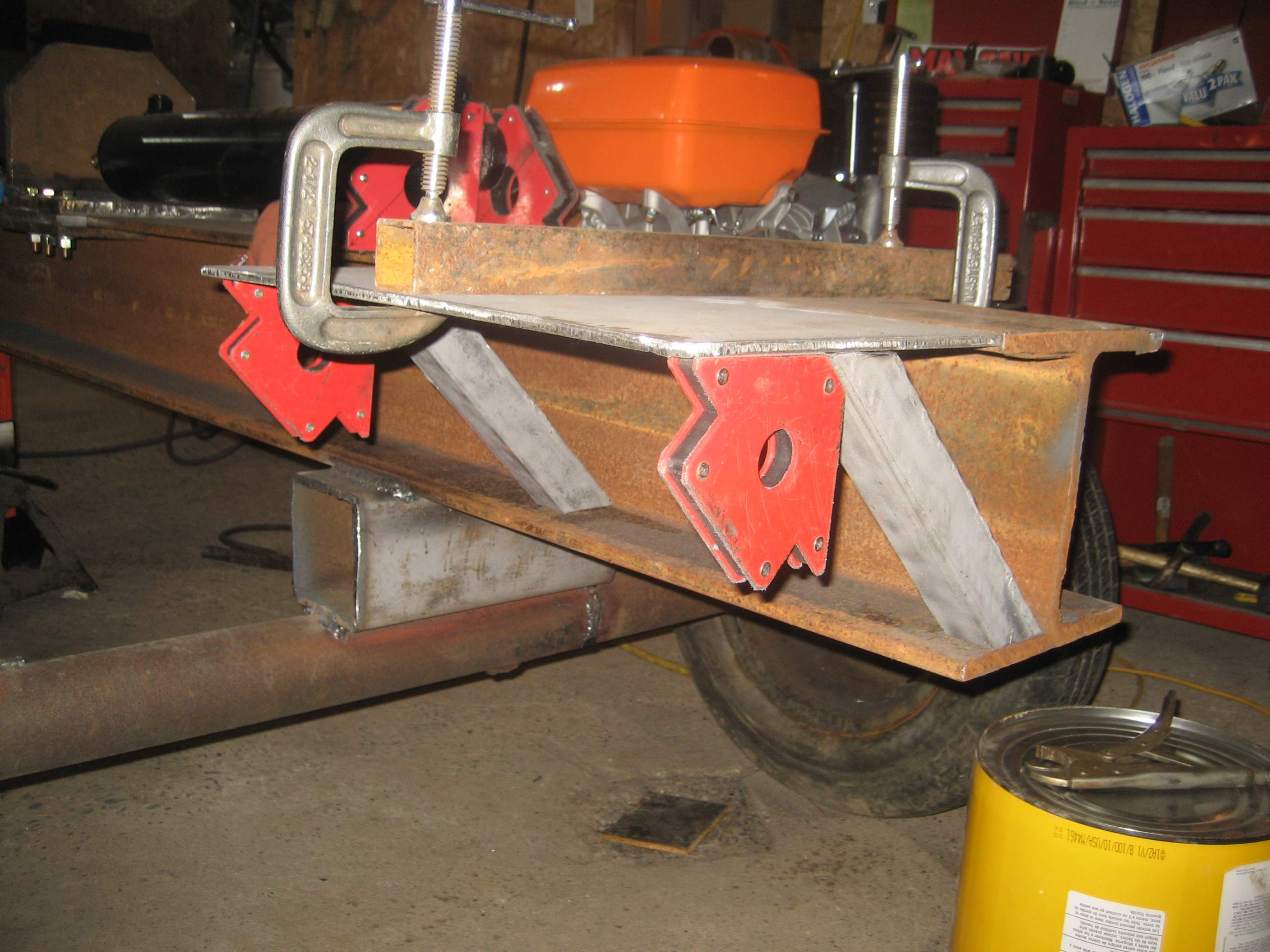

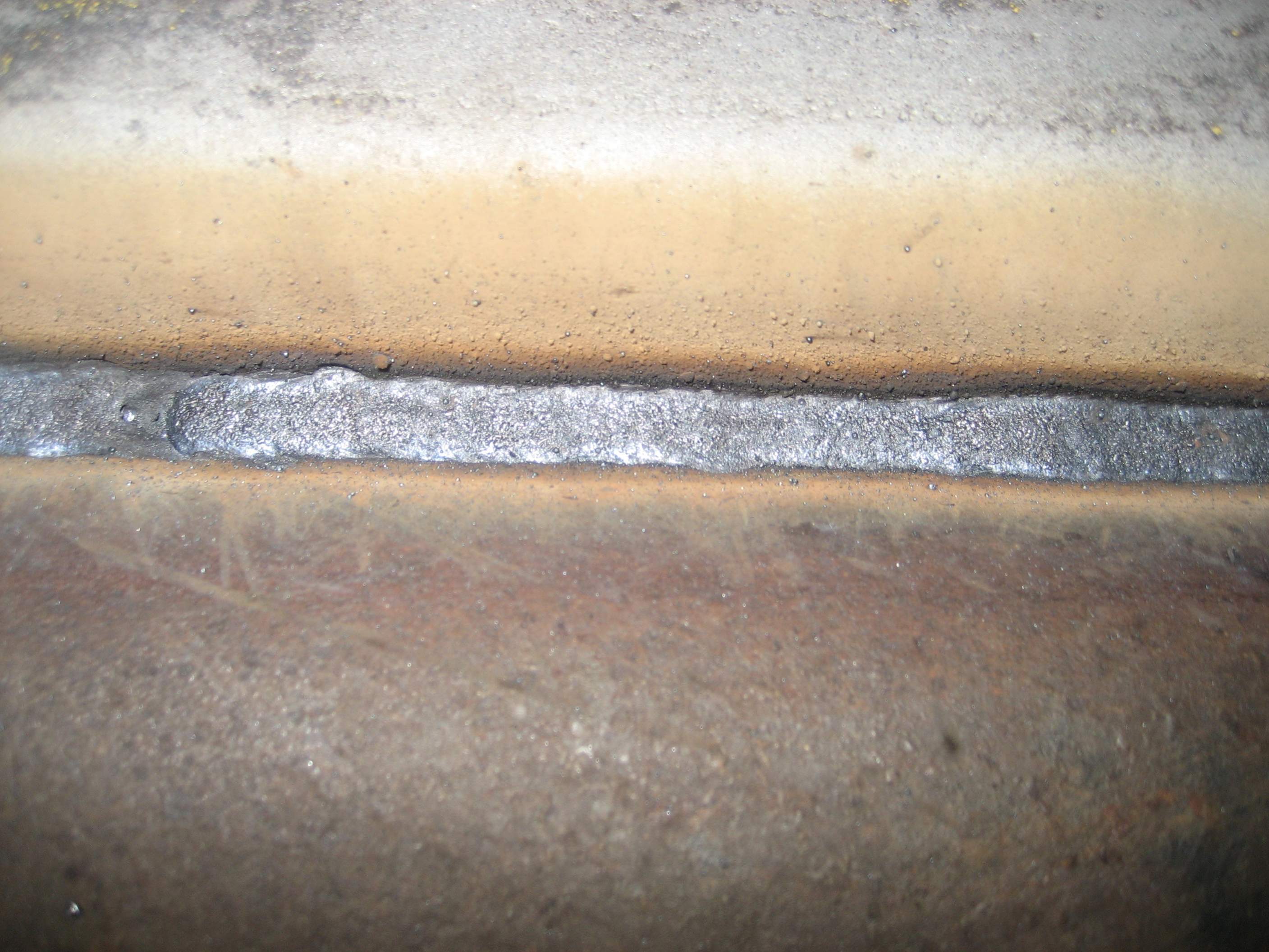

Lots of slag on that last weld but it was soild underneath..Those welds holding that square tubeing on where long hot welds at 400 inches a minute at 260 amps..Bacon baby..LOL

Well i now have everything except the motor.( it was the only thing not on sale at PA this week). I didnt notice till i got home( and because it was in the box) but i have a 4.5 inch bore cylinder now instead of the 3.5 bore i had planned..Now instead of a cycle speed of 7 sec it is 11 sec with the 16 gpm pump i have....Still faster than any store bought splitter and i reckon it will have enough power now to get through a 4 way wedge..

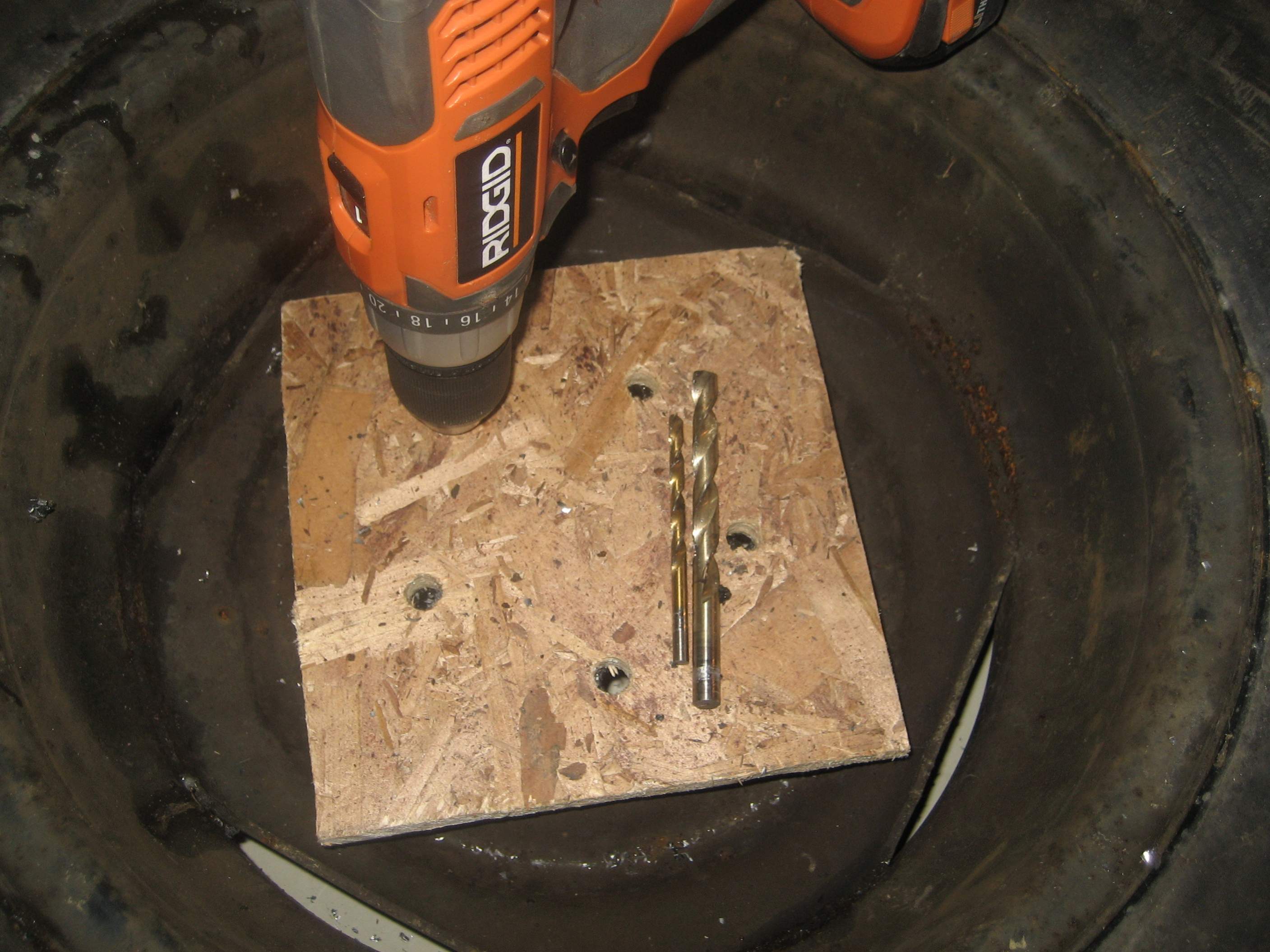

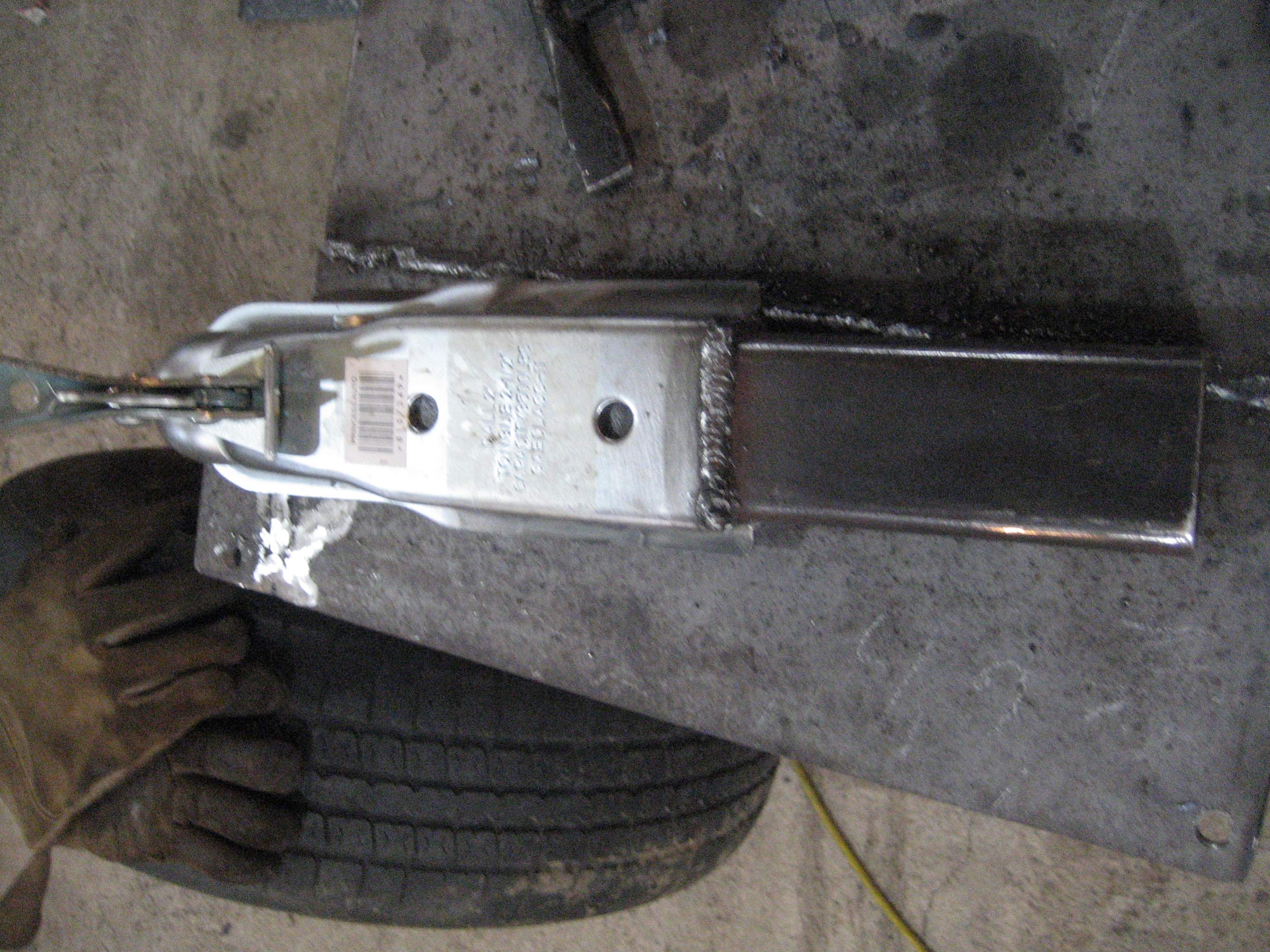

Got a free set of rim/tires but had to modify the bolt pattern..What a PITA..i dont plan on towing at highway speeds anyway..

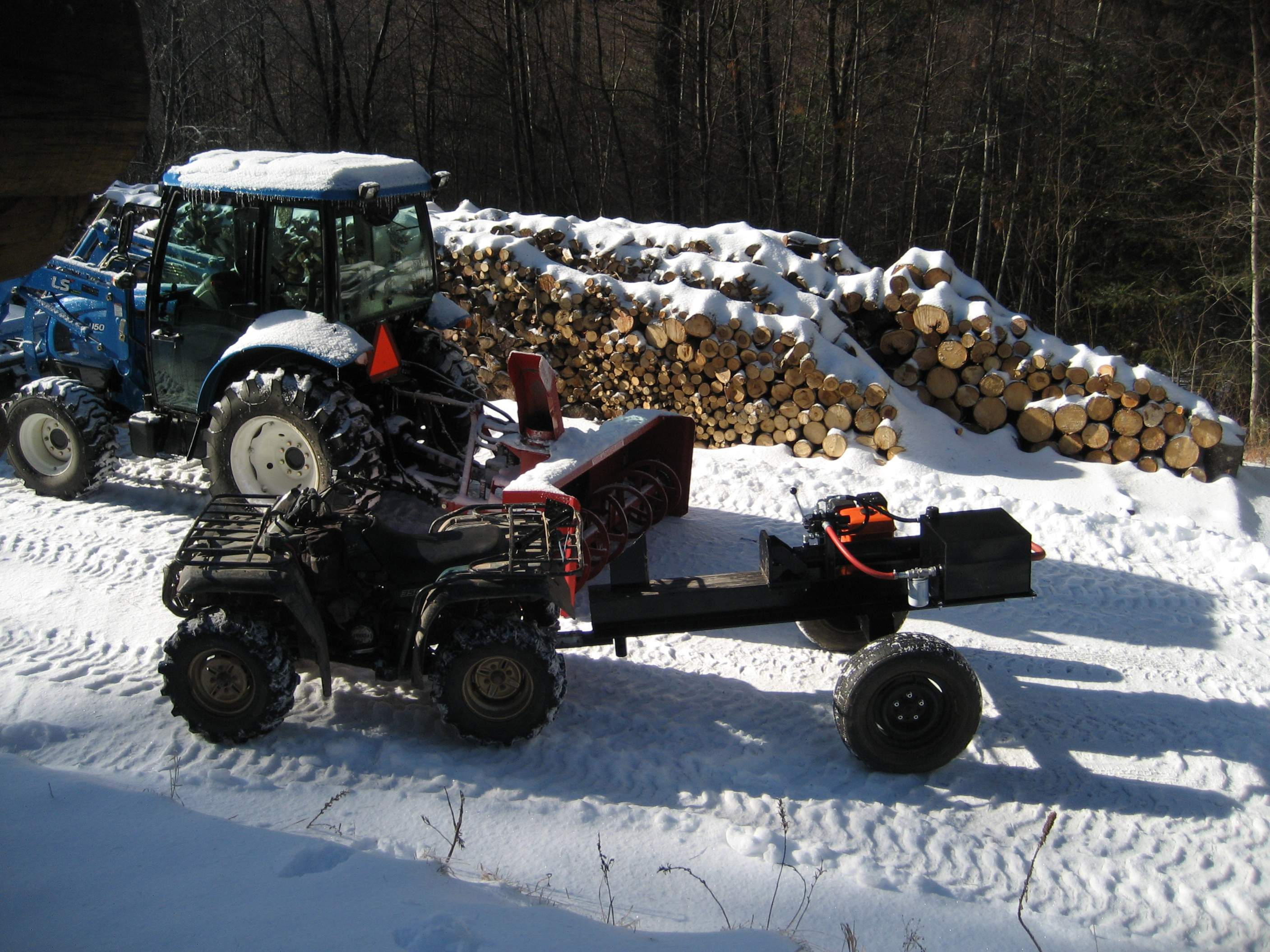

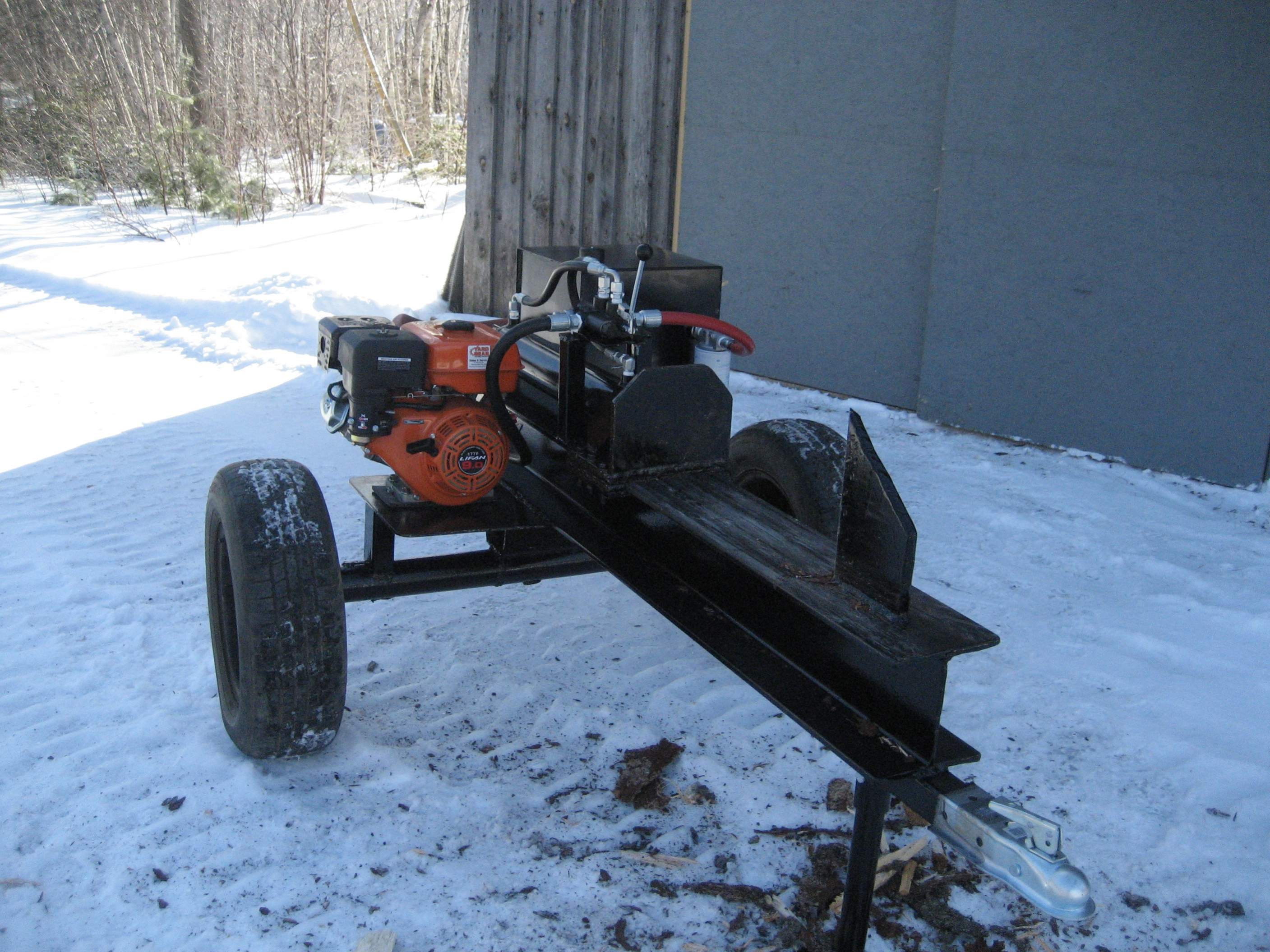

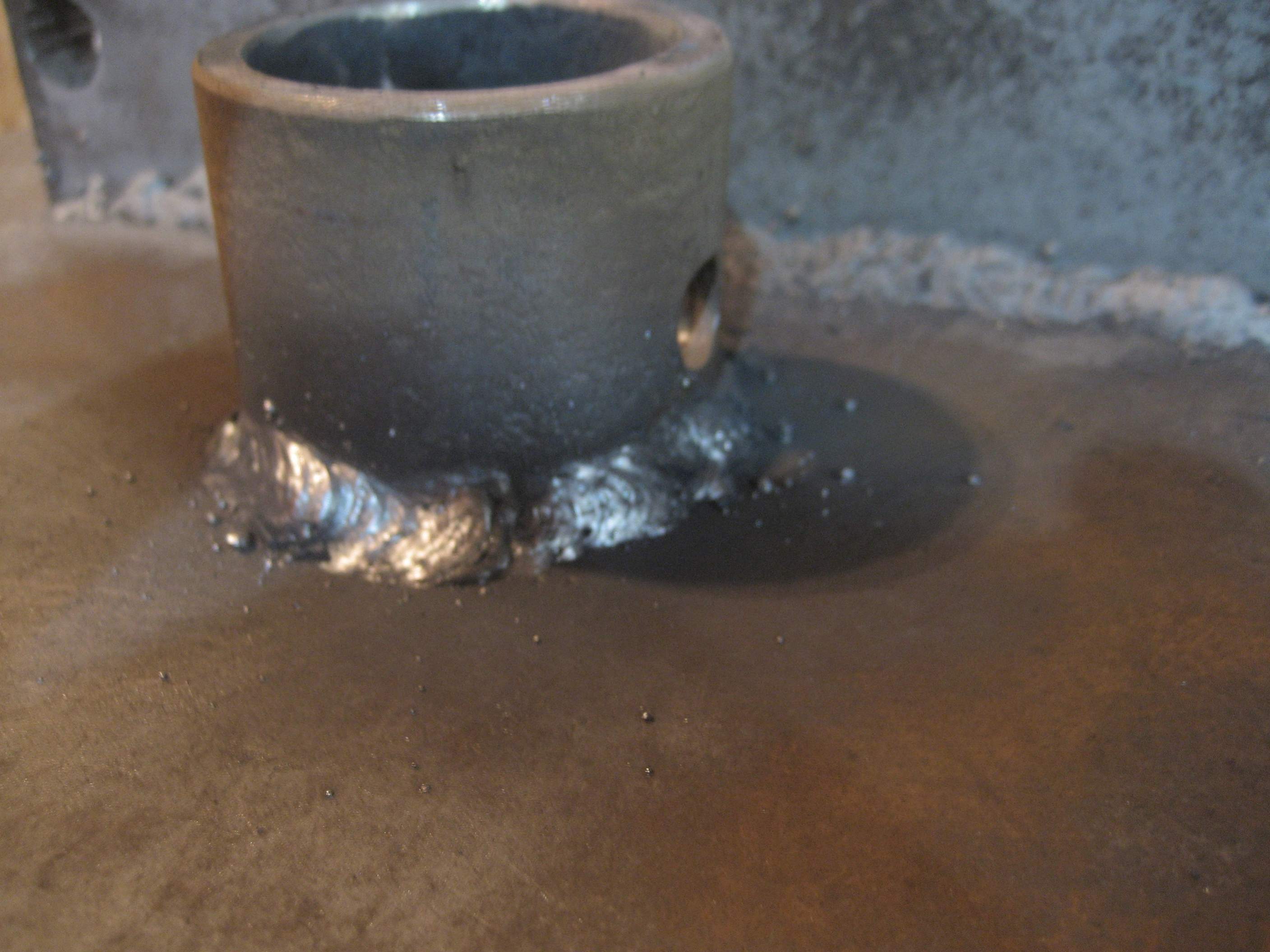

Done. Cycle time wasnt as fast as i wanted because of the bigger 4.5 inch ram.. It has a 10 sec cycle time as of now. Split 1/2 a cord today and no trouble..Made the hydraulic ram pin on my chochester lathe.
It was a fun project..Might sell it to buy a milling machine and build a faster splitter with a smaller ram..:thumbsup:
