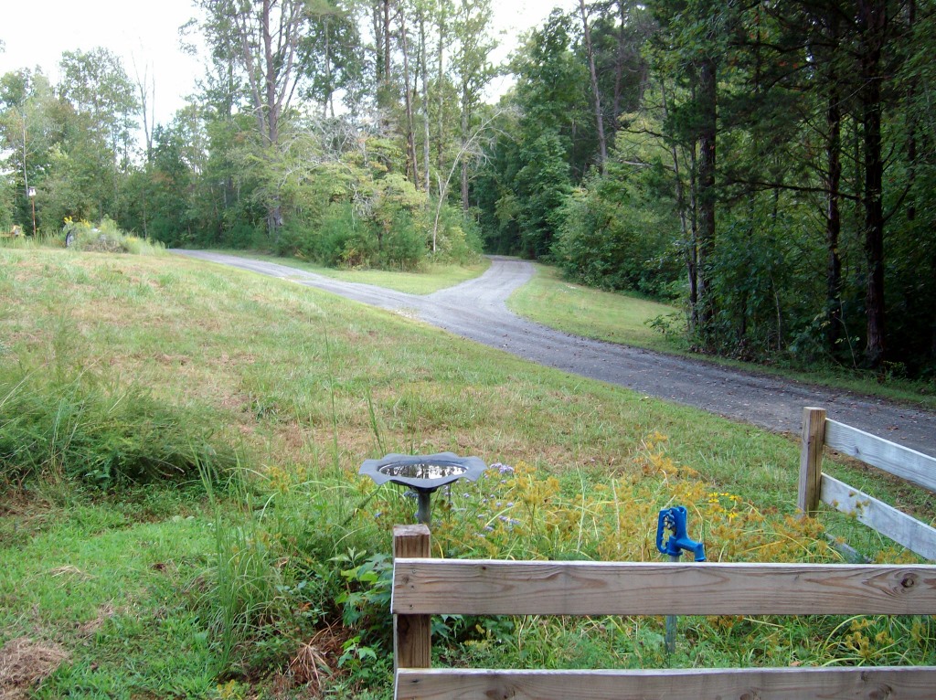

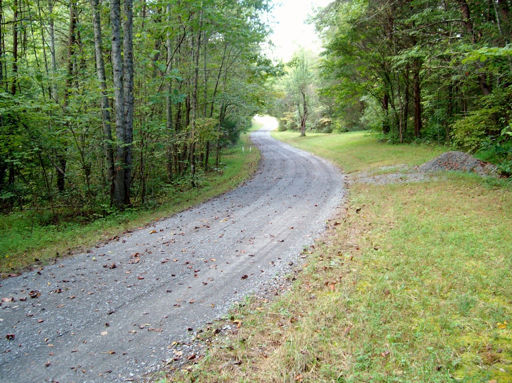

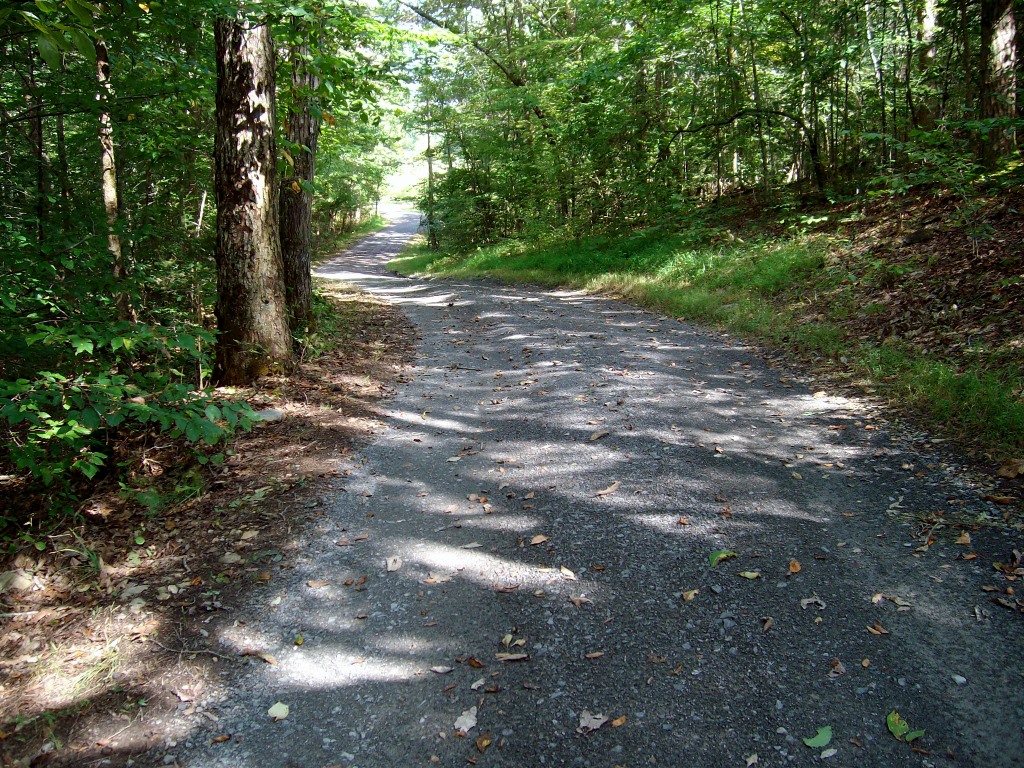

Thanks guys! They fit it in 8 loads. Totaled $2,180 delivered and spread, but that was enough to give us a decent skim coat on 4,450 ft of roads. Not the greatest spread job; driver apparently didn't have a lot of experience, so we got 4" in some places and 1/2" in others, but this was just to cover and smooth our well-traveled, highly-packed roads with a base of river gravel. The base has stuff up to about 2-1/2" dia, so it is a tad rough without some nice fines around it. I pre-graded with just a box blade to reduce most of the wheel ruts and slightly crown. We redo it about every 3-4 years.
