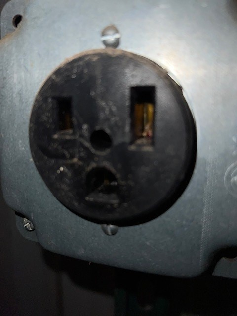

Will check although ANY Harbor Freight or other places that might carry used or open box are 30-40 miles away. So, do not get there very often. Yet another source of confusion for me is the type of AC plugs / breakers required. As mentioned in an earlier thread, I have a Miller Stick and a 50A plug (I think it's a 50, been forever since it was installed). I noted for some (all?) of the 110/115/120v machines, some have input current ratings > 20A? Even the 220V machines seem to be silent on the power source PLUG.
Am I missing something here? Perhaps I am over thinking this? I know little about the various power plugs. I ask because I would hate to buy something and upon unboxing find out that I need a different circuit / plug just to get started. For my Miller Stick, the plug is pic attached.
I of course have "standard" 120V plugs available, but these are not rated >20A (I think). One can of course run another circuit, but my shop is a metal building, so this would/supposed to use conduit and "strut channel".
Since you have 50 amps to the shop,you can buy what you want without worrying about electric power or plugs. You have the most popular plug already and if you need something different it will be simple and inexpensive to change so worry about that when and if it's necessary. To get you over some of the confusion, your plug is commonly called a " NEMA 6-50R" which is on most 220volt machines even if they only need 40,30 or 20amps. Just for the record,is your present plug on dedicated wires from house to shop or is it fed from a breaker panel in the shop along with some 110 volt plugs and lights?
I have (2) meter loops here. One house, one for the shop. The shop has a separate panel (100a, I think) and the circuit for the welder runs to the 50A plug, but also has (2) 120V plugs on the same wires just above. There are additional 120v plugs and a couple of lights - which I need to upgrade to get better light.
I was really wondering about the 120V capable wire machines. It does not appear that a "normal" 120V circuit should/can be used? Yes, I could swap out the 50A plug, but if I keep my Stick welder, then I would not have a plug for it. So, if I understand this correctly, I will still need/want a dedicated additional plug?
