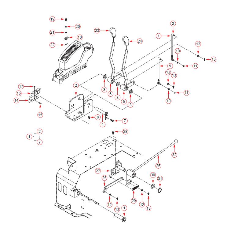

I have been looking at fabbing something up like you suggest. If they ever get my service manual delivered I'll have a better picture of how it works and what I will need to do. Not finding much online for this tractor yet. Do you perhaps have a drawing or parts page shot of the one on your tractor?
   / Now an Official member of the LS forum #22
Part no. 23 is the front (by the seat) position control lever, and the rear position control lever is part number 32.

Thanks, but I have a question. Where does part #1 attach in the lower section?
   / Now an Official member of the LS forum #24
It does not really belong in this drawing, it is the axle for the rear hydraulic remote actuation lever. The lever rotates around part number 1. I guess they just included it to help locate things, but it has nothing to do with the rear position control lever..

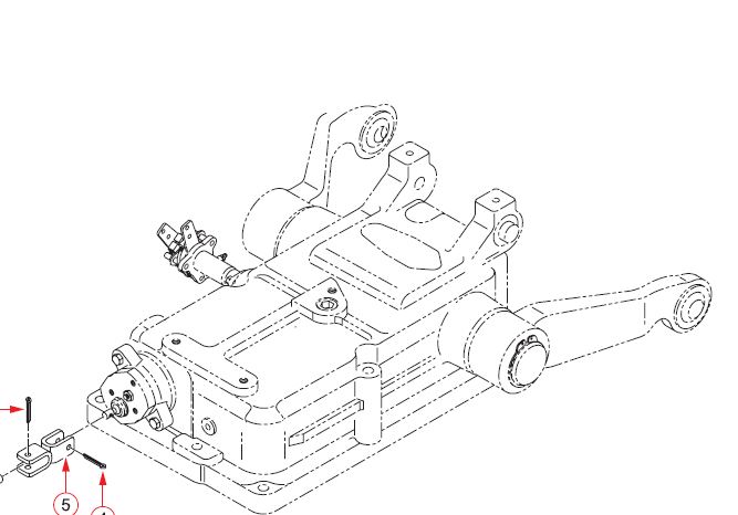

I am referring to the shaft #1 going down in the top of the drawing. Where and how does it connect in the lower section?
   / Now an Official member of the LS forum #26
it attaches to the ears on the side of this 3pt valve. one ear is for the position control and the other is for the draft control ( the other lever by the seat)
I am not sure how they connect together to be truthful..

Look at part 26 in the lower drawing, I think it goes over to the same ear on the side of the 3pt valve. It is like a connecting bar.

Think it is safe to say the #26 linkage on the lower part of the drawing connects to the valve too?
I'll have to look at mine, it can't really be that simple can it?
