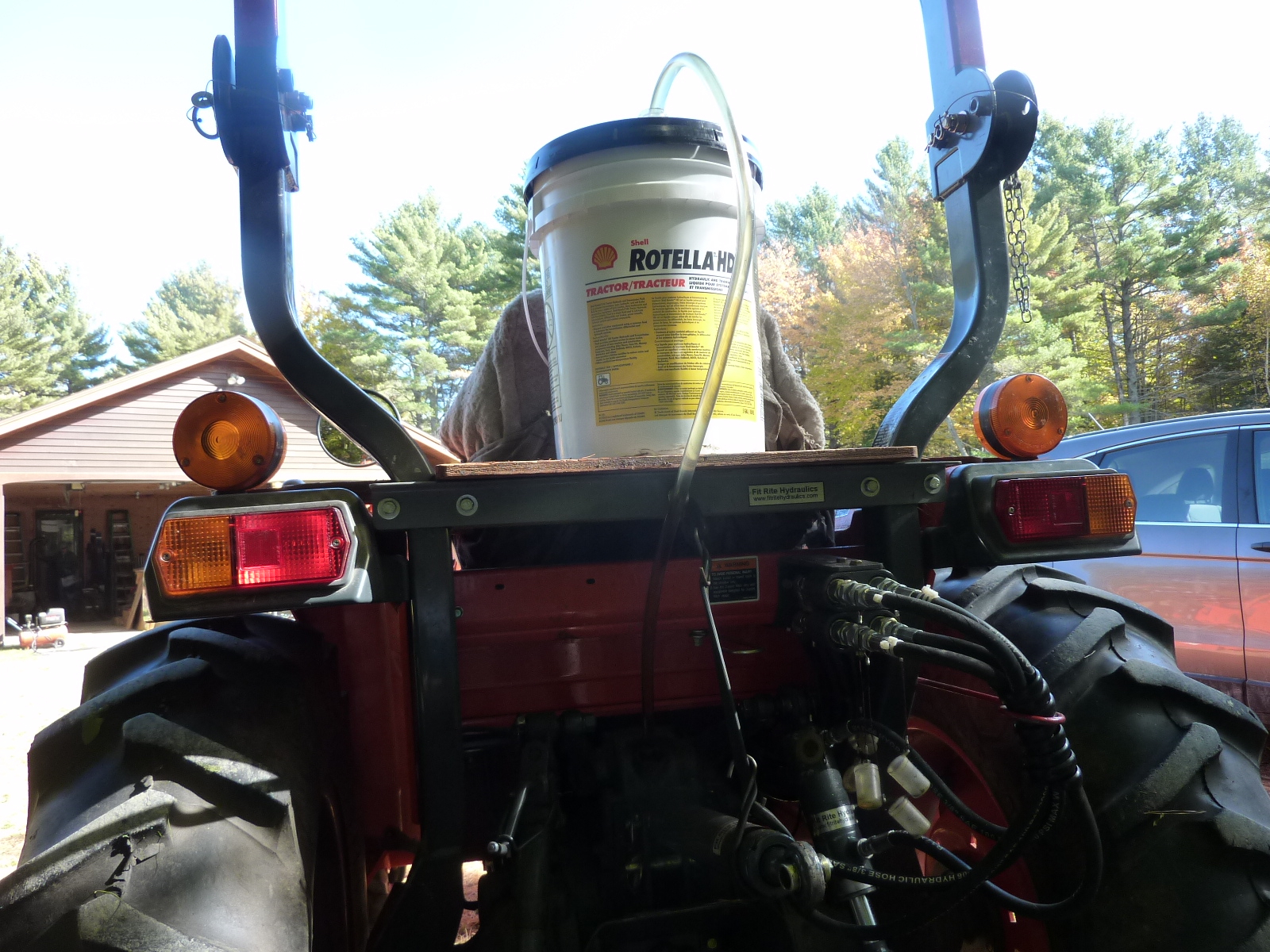

I siphon it from the 5 gallon. Slow but never spill.
Best,
ed

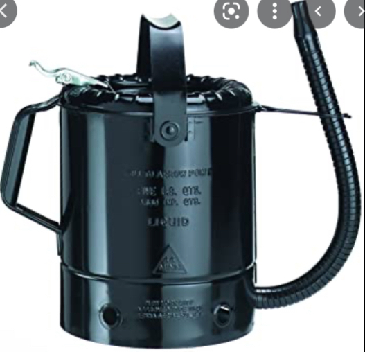

I use a 1 gallon oil can with a valve, similar to this one. A little time consuming, but easy and clean.

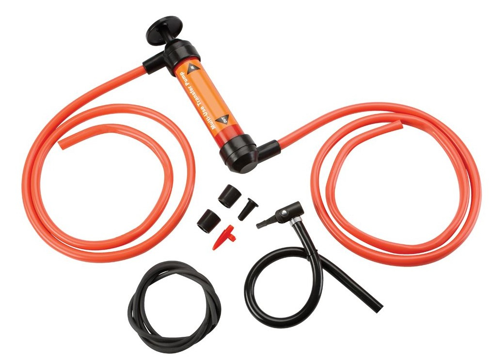

Like many above I use a simple & cheap (HF - $6.99) hand pump... slow but no mess, & if you accidently overfill the tractor you can pump some fluid out...
