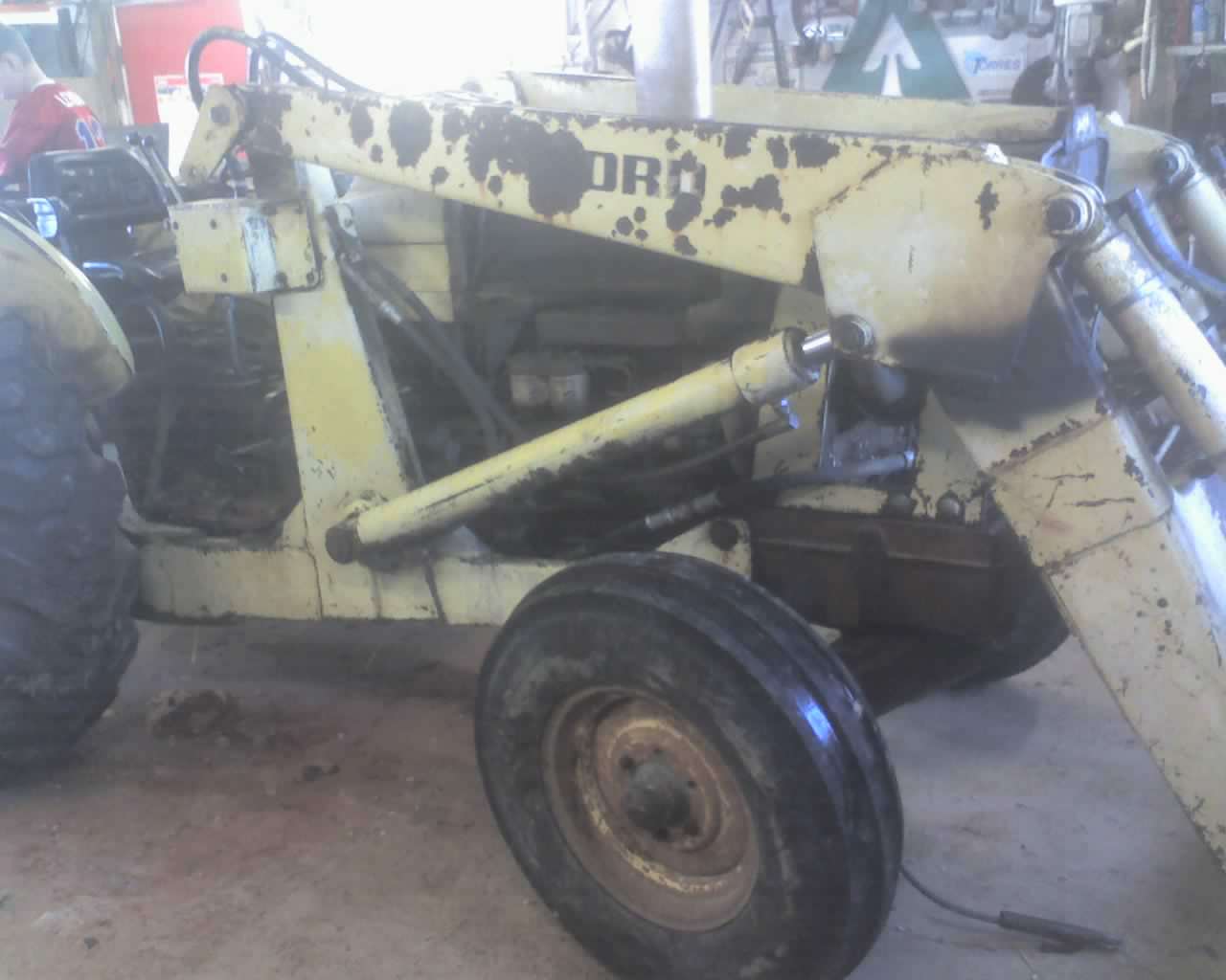

Heres what I drug home yesterday:thumbsup:

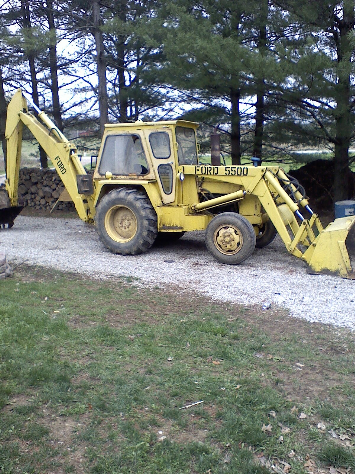

She's a Ford 5500. Quite a large machine.
Engine runs really well. It's a 1967. Backhoe is gonna need some attention. Pins and bushings are a little sloppy. And she has a few leaks here and there. But is otherwise in pretty good shape.
I kinda already knew what I was getting into with the pins/bushings. Dad just got a 4500 and last year we did the same thing. Rebuilt the BH pins and bushings, fixed some leakes, welded some cracks, etc.

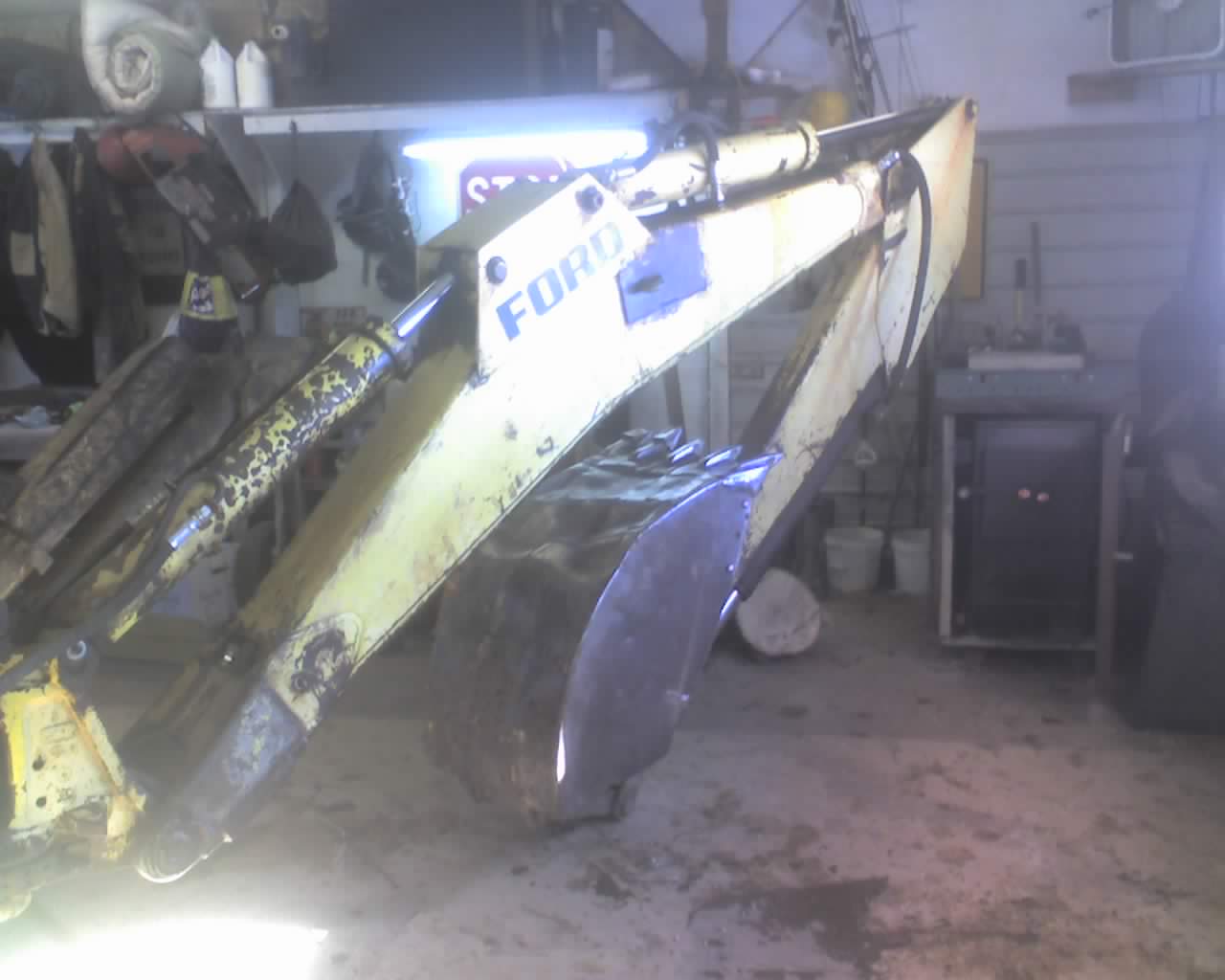

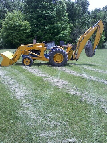

Here is what his before and after looked like: and I hope to make this one just as tight and pretty someday:

The main ones I need to address first off are the swing pins. There is about 3ft of slop with a fully extended hoe. And the other bad ones are the controll levers. With the dipper lever pulled all the way back and the raise all the way forward, there is about 14" between the handles:confused2: Kinda makes it hard to operate both of them with one hand:confused2:
The rest of the pins and bushings arent nearly as bad, but do have some play.
