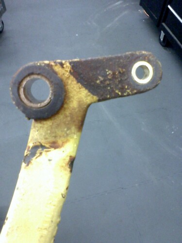

1st pic is the control lever. New bushing in the main pivot. And bushed the smaller hole where the adjustment rod hooks to it. These holes are "supposed" to be 5/16". But in the vertical direction, before the bushing, measured almost 1/2":confused2:

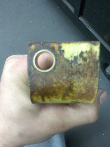

Second pic is a bushing in the rail that mounts the long rod that all the secondary levers pivot on. Those cast-iron levers also got new bushings, but no pics of them.

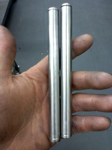

Third pic is new pivot pins for the control levers
