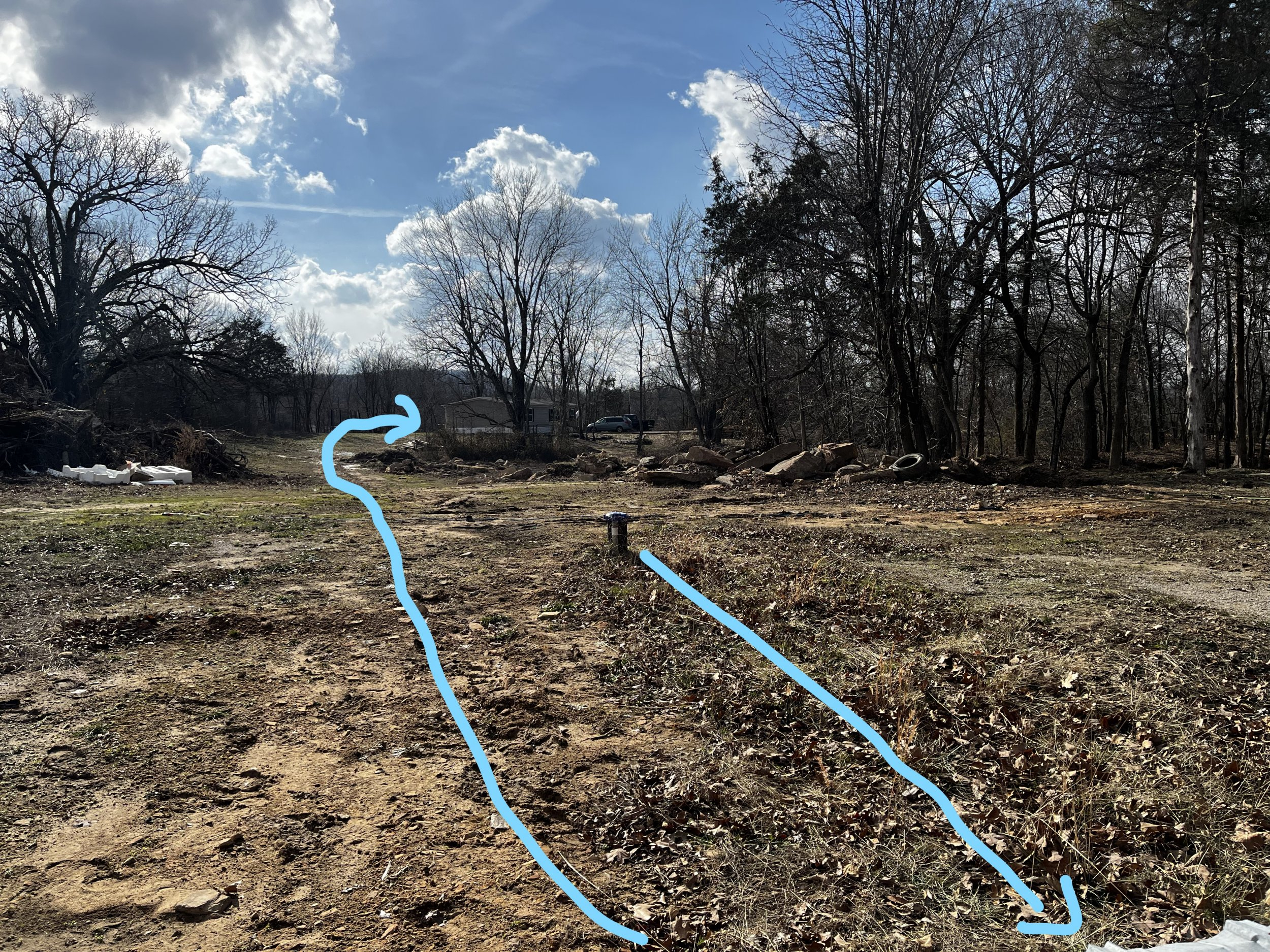

its a submersible well i believe is what my grandfather told me. 650 feet deep. the well head is 20 feet from the tank/pump and the tank/pump is enclosed two feet deep with blocks stuffed with insulation.

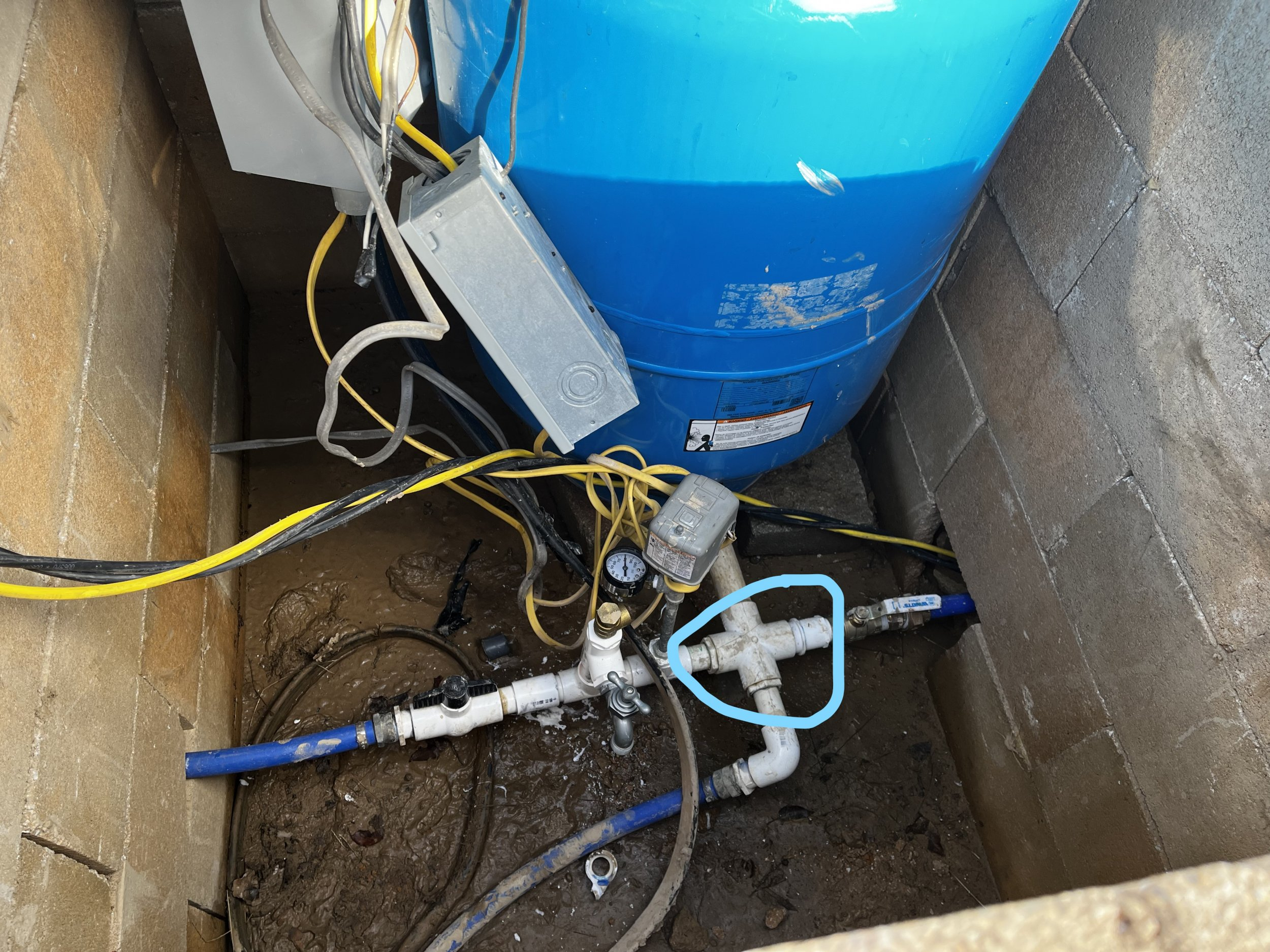

Attached are some photos. With my super glorious editing. shows well head and the tank inside the well house as well as in/out for water.

the circled 1 1/2'' cross is where the ball of ice was
Helpful photos! Thanks.
I would do three things to start with. One put a cover of some sort on the well head to give it some insulation (e.g. an old cooler, or a garbage can with some old feed bags for insulation; make sure it won't blow away). Two, insulate the pipes with at least an inch thick closed cell foam pipe insulation. Three, put a piece of 2"+ thick styrofoam on top of all of the pipes, especially over the four way cross.
