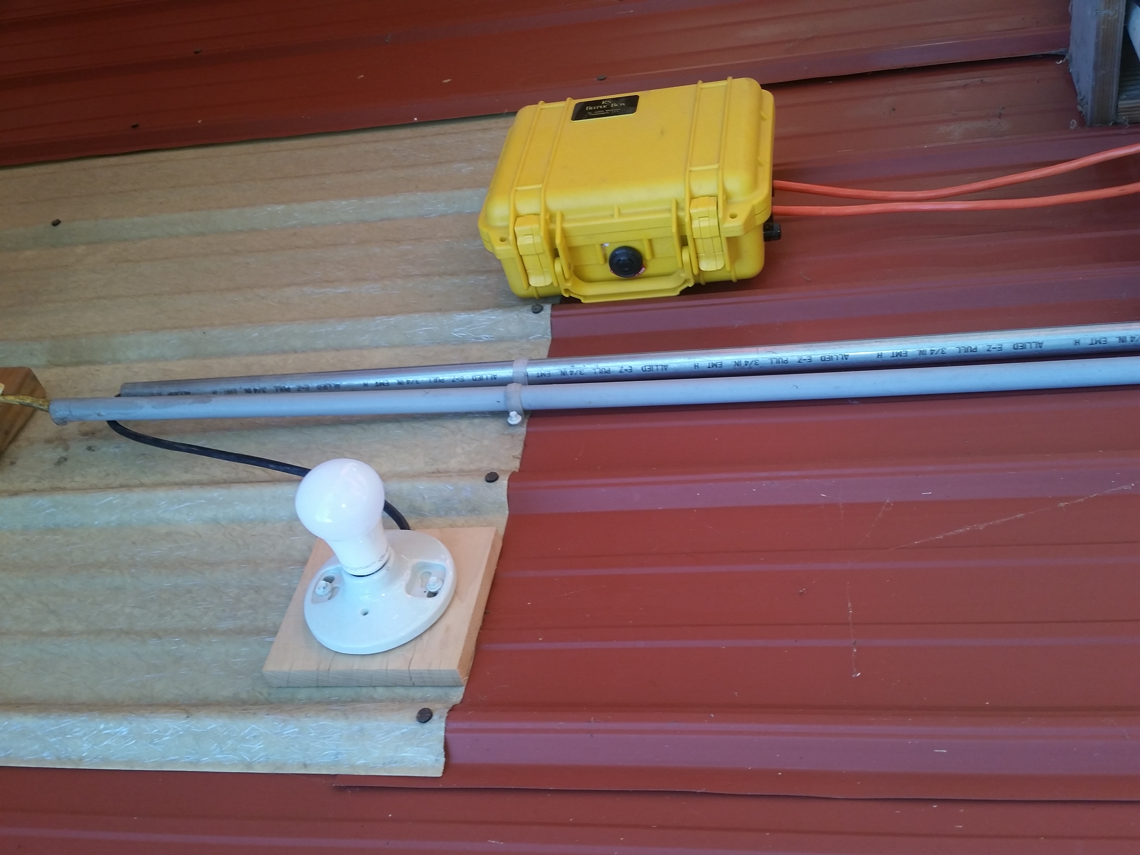

Thought I would waste everyone's time a little by resurrecting my old post. I decided I didn't want to run my block heater all the time but also didn't want to go plug it in if it's needed and cold outside so I put together a system to turn it on wireless. I used a weatherproof box and added an internal wireless switch. The LED light plugs into the box along with the block heater. So I can leave the tractor plugged in and can turn the block heater on (or off) via a wireless remote from the house. When it's on the light comes on.
Not a big deal but handy so thought I would share.

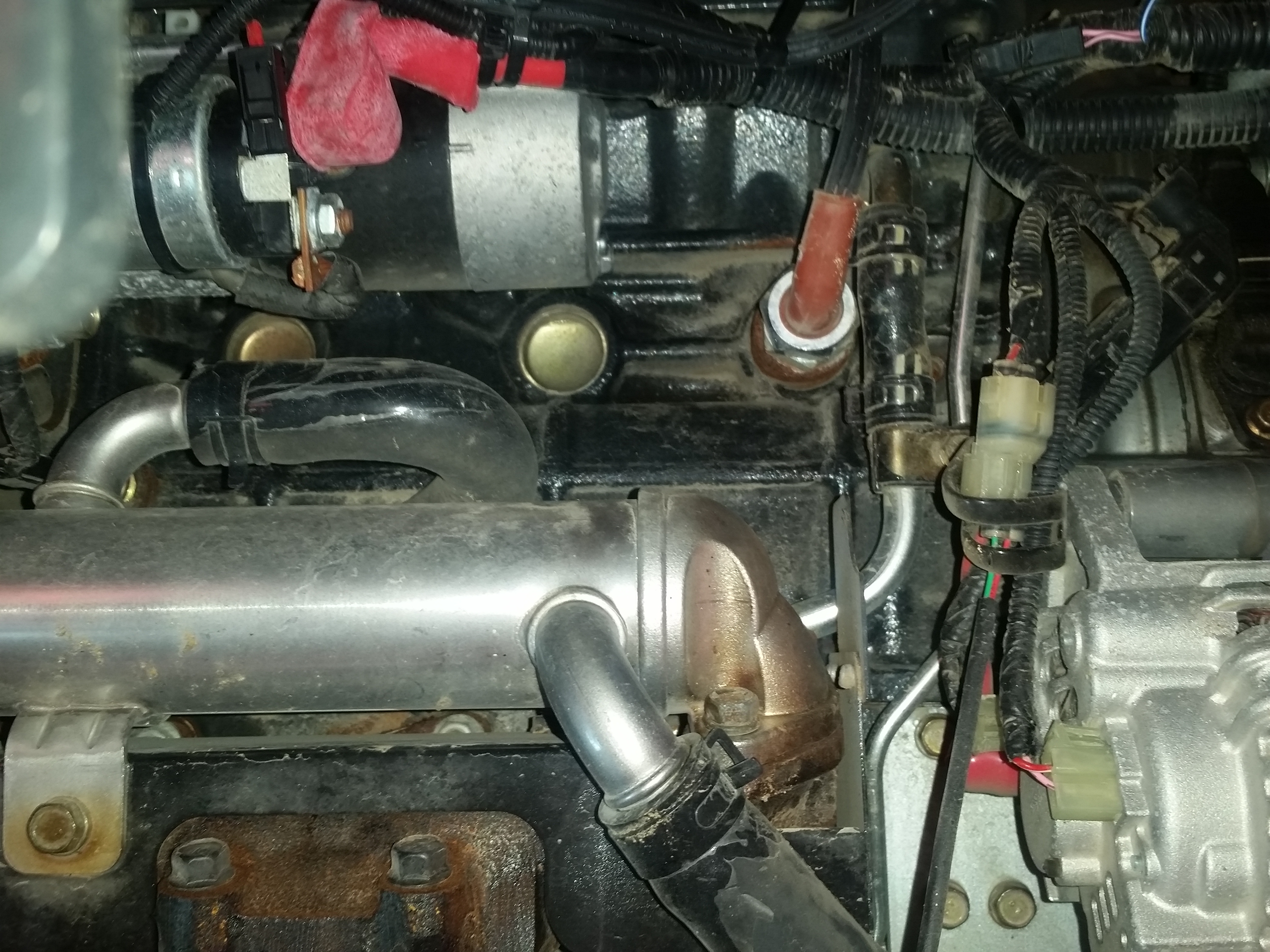

Looks like it works good. Which freeze plug location did you install the heater in, I will be installing mine in a few days.
