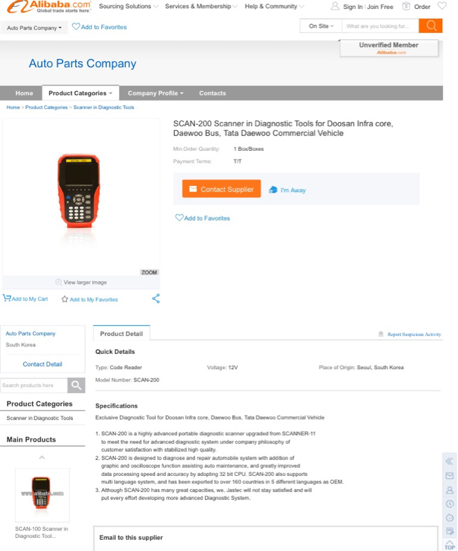

#32
The scanner that the dealer uses is available but at $700 its out of my budget. <img src="http://www.tractorbynet.com/forums/attachment.php?attachmentid=522709"/>
Also the uVIN and the FT4 software is what the deal used with a laptop to read and diagnosis the issues, however they also connect online with kioti to check updates and such. Only issue I see with the FT4 is you have to have a authentication code provided by kioti to activate the program.
