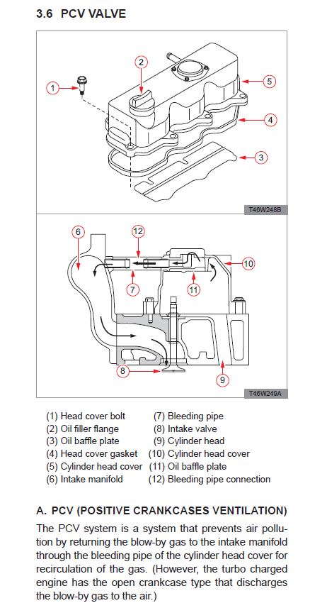

My older (DK45) has "positive" crankcase venting, but it simply consists of a (very short) hose that runs from the valve cover to the intake manifold. Because there is no throttle (air) valve, there is no need to have a PCV valve to restrict manifold vacuum loss at low power settings.
I cannot visualize how a PCV valve could work in a diesel, or why there would be any need for one. I do agree if you have (any measurable) crankcase pressure, it can be very detrimental to your crankshaft seals. My crankcase vent hose runs from the rear of the valve cover, to the rear of the intake manifold, maybe 1 foot long.
Here's a snip from the Kioti manual for the DKse tractors. Really isn't much going on there, but #11, the oil baffle plate, would be easy to have a look at.
If OP can rule that out, its one more thing off the troubleshoot check list.

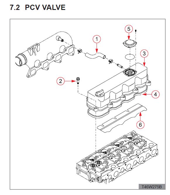

Took a look at the service manual. These tractors do have a PCV valve. Sits on top of the valve cover on the end opposite the fill cap. It has a circular metal cap over it that is attached by what appears to be three screws. The blow-by hose looks like it's 3 or 4 inches in length and is connected to the PCV valve and goes into what appears to be the intake manifold. I'd open that up and see what you can see.

That snip I took in post #8 of this thread is a screen grab from the kioti Workshop manual. and should be exactly what the DKse and most likely NX series tractors have.
I'm shooting from the hip here, but it is possible that the oil heater, if its not big enough or hot enough for extreme colds, may be causing the problem. If only the bottom of the engine is hot, moisture will rise up to the valve cover area, and if there is not enough heat to keep pushing the moisture out of the engine entirely, and it is super cold, The moisture will condensate and freeze back up right at the top, where the pcv system is. Especially if the engine is only run in short increments in the cold, where it does not have time to steam off all moisture gathered.
Worth a check during the next hard freeze, to see if your valve cover is still well below 32deg with the heater still on.
This is one of the reasons I prefer the lower radiator hose jacket water heaters, as opposed to the sump pad type. The hot water really gets around the whole engine with the former, if its big enough.

If you take a look at XCGreen's earlier post with the picture, it shows the valve cover assembly. To the rear of the valve cover assembly is a round cap held on by three or four screws. The picture only shows three, but I suspect there's a fourth screw on the backside. That round cap covers the PCV valve. The tube you found (blow-by tube) comes from the PCV valve and goes to the intake manifold. If you pop that cap off, the PCV valve should be underneath it.
Also, XCGreen is correct in that the DK and NX series share common engine configurations. The graphic he posted is the exact same in the NX workshop manual. The graphic I referred to in order to find the PCV valve is on page 3-80 of the NX workshop manual. The one he posted is found on page 3-41 of the NX workshop manual.

Yes they can. Have a look at this screenshot here, a different view than before. Just take the 4 screws out and have a look at the baffle plate, #5. It could be gummed up stuck against the seal.
A quick thing to rule out while troubleshooting, and with some luck, it could solve your problem.

Thanks for the picture. Will take apart when it is warmer. Sure miss the old tractor. Looks like I may have to take off hood just to have room to get this apart. :confused2:
