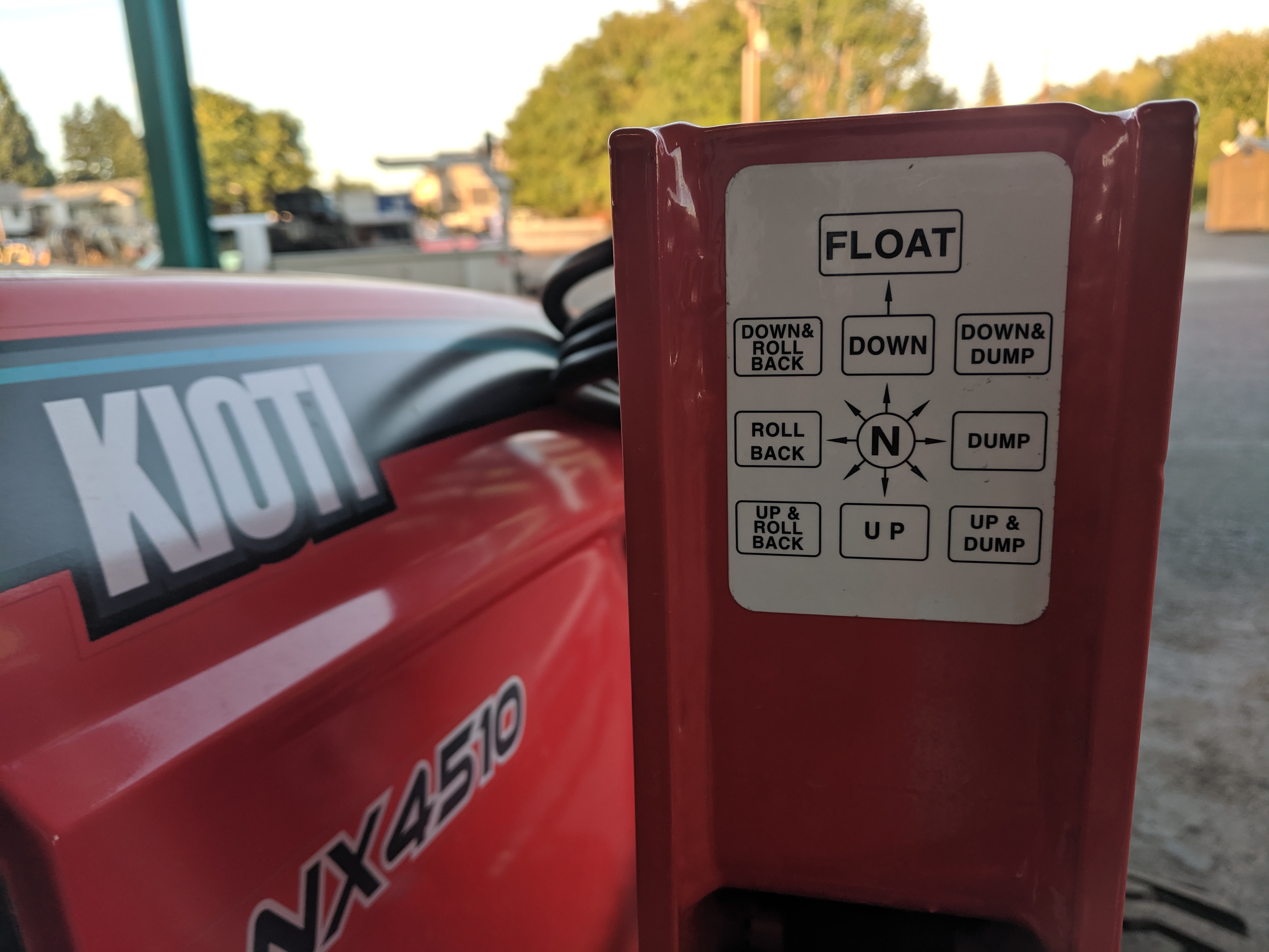

Test drove an NX4510 last night. There was a loader diagram, pic attached. The loader would not lift/drop and curl at the same time. From reading other posts and looking at the diagram, I believe that should be possible. Is it possible that the loader was installed incorrectly?

At max rpm it will but not at full input on both controls. It takes some finesse to get both actions.

This is the diagram.
   / NX Loader able to curl and lift at the same time?
Do other brands do this more easily?

Mine was tough at first to get it to do both, but as the cables relaxed the more I used the loader it has gotten much smoother and easier to do.
Not sure how many hours you have on the machine, I only have a little over 700.

It's a 2018 built NX4510 with 26hours.
   / NX Loader able to curl and lift at the same time? #8
Construction type machines do but they have (in general) a lot more hydraulic flow. Ag tractors are intended to do a myriad of different chores with acceptable performance at a moderate price point.

I really like the value of the NX, but wondering if I will be frustrated by the slow FEL, I have a lot of dirt work to get completed.
   / NX Loader able to curl and lift at the same time? #10
The loader valve is not piloted, so one function at a time unless really feathered.
