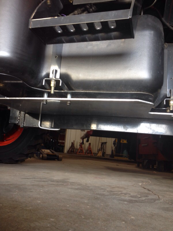

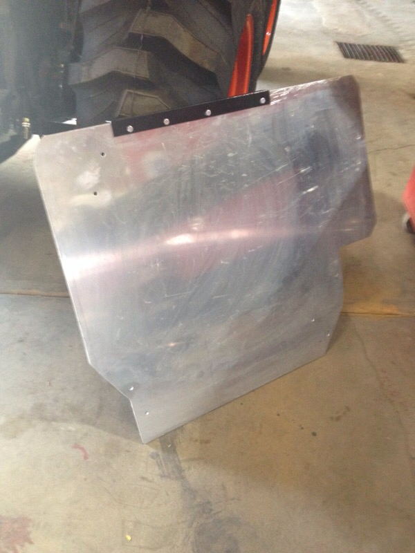

FWIW, the steering also needs to be plated.
Here is a photo of the hose loom I fabbed to protect the hoses from snags.
And here is a photo of my three piece skid plating.
Right side.
Right side
Here is what those plates look like when off.
After installing my hose loom, which holds the hoses up higher and tight, I also had to put on a bit of shielding on one of my third function loader hoses that was rubbing on the right-side leading edge of the cab.

Nice job. I noticed that on my tractor too. It is not good to have exposed rubber covers like that.
