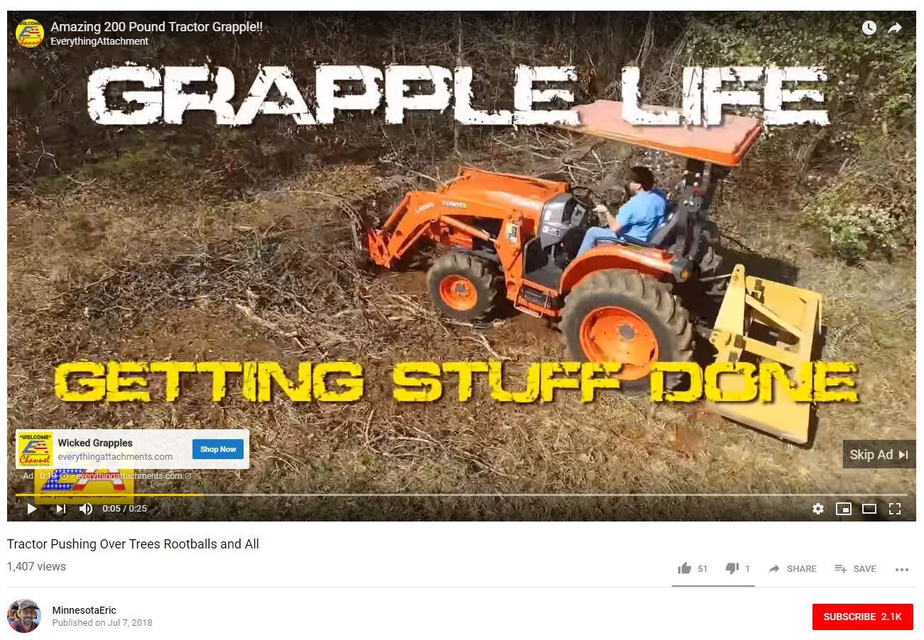

Travis, I think mine is a 72" wide compact which you guys have made open a little wider, added slightly heavier rams, and added the bars in the back to avoid tripping the quick release into your slash fire (heh). Anyway, the original grapple is still going good.
/ NX4510 Grapple #7
Very accurate statements, Eric! I'm glad she's still going strong.
Awesome, video man. You're definitely a smooth operator! :cool:
Ironically, check out what I had the pleasure of seeing before it started playing!
