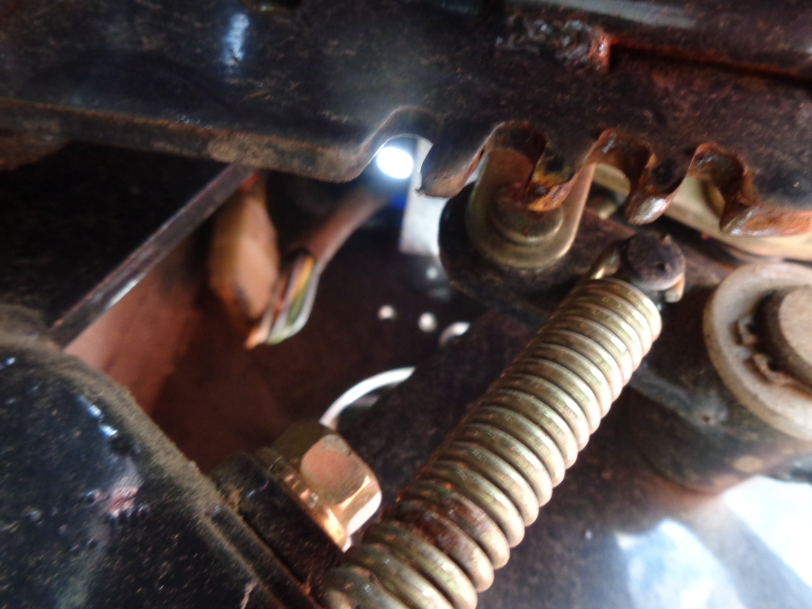

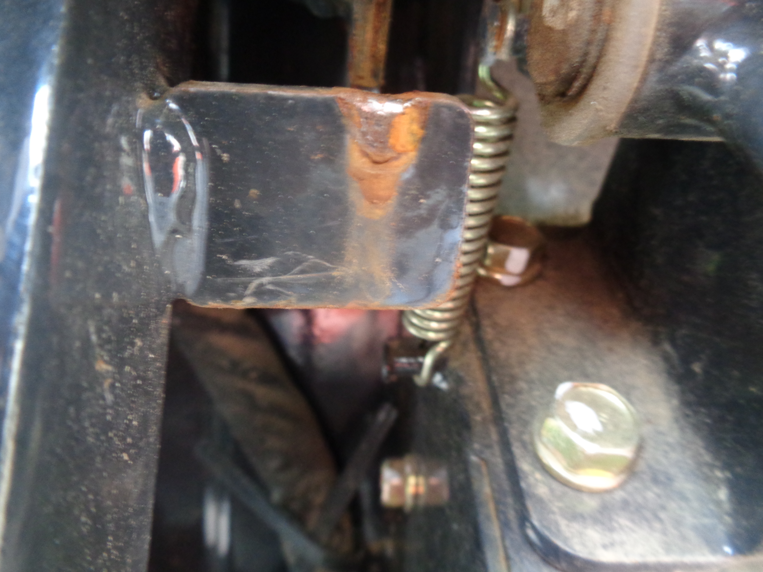

I've got 490 hours on my 2014 NX4510HST without any issues whatsoever with the brake pedals failing to hold. I do have to ask. Are you holding down the brake locking lever when you step on the brake pedals. If you are, you are causing the premature wear. I step down hard on my pedals then set the lever down and release the brake pedal. To release the brake I just step hard on my brake pedals and the locking lever releases by itself. You could probably temper the dogs with a torch when you replace it.
   / NX4510 Parking Brake Failure - Life/Safety issue #13
Here are a few pictures of my brake pedal brake step and the multiple brake pawl. I use my brake every time I park my tractor because I have a downhill driveway that aims towards my garage. When I first bought this tractor I used to push down on the lever when I was setting the E Brake. I learned quickly not to do that. That is why you will see some very slight wear on the brake pedal stop lock. Someday I will pull that off and weld it up. The welding will make it super hard and pretty much wear proof.

Jim R you have the same parking brake set-up as I do. Is your NX a non-cab model also? It's interesting you have very little wear on the brake parts - from your description you are using the exact same sequence which I have always used - cram the brake pedals down hard then push the locking lever down to engage the pawl. To release just step hard on the brake pedals and the locking lever springs off - which is where I believe the wear occurs. Maybe I use the parking brake more often than you. In a typical day of using the tractor for, say, brush clearing or even mowing I might use the parking brake dozens of times - every time I get off the tractor whether I leave it running or not. Of course now that it is so worn I can't use it at all. When I do eventually replace or rebuild the parts I'll be sure and modify them so they will last.

I use my brake pretty much every time I get off my tractor except when I shut it off on flat ground because I drop the loader. If you are slamming the pedals with your foot to release the lock, that may be what Is doing the damage. Or, you are setting the lock on the first notch then pushing the brake pedal harder to set the lock into the second notch. I have an open cab just like yours.

That kind of wear is not going to happen on the release of the brakes unless you are really slamming on that brake pedal. If you are doing that, then it is self inflicted.

I too agree no need to cram anything. I apply enough pressure to the pedal to hold the tractor, then push down on the parking lock lever to engage, to release I simple push on the pedals enough to allow the lever to spring back to release. It should not take much force to apply or release the brakes. Per haps the pedals and locking paw are sticking due to rust or corrosion and need cleaned.
