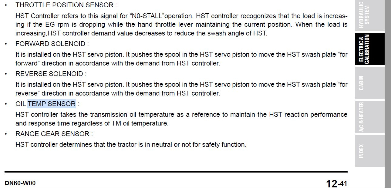

My NX can be jerky as hell usually on medium range pedal to the floor and it's when the fluid has warmed up. I can set cruise and it stops and travels smoothly. I've figured out a bunch on my tractor but not this one yet.
My jerky motion also only seems to occur when the hydro fluid is hot. Normally the hydro fluid only gets that hot when I'm using the PTO for an extended period of time.

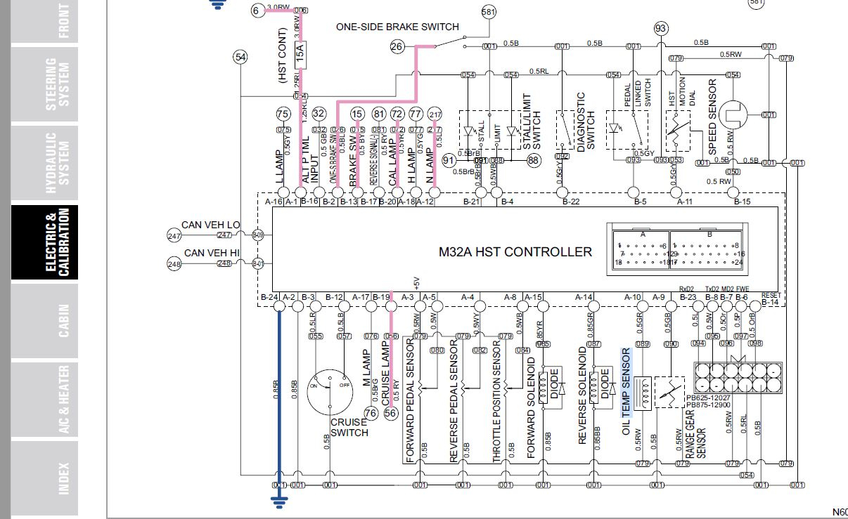

In my manual section 4.7 HST CONTROL SYSTEM (HST MODEL) it shows a oil temp sensor. I want to find out how to get the transmission oil temp sensor data to a dash mount readout.
Anyone have any ideas?

Locate the sensor. If a single wire, it works by grounding and you can tab a temp gauge into it.

I'm going to look for it but the diagram shows a iron core inductor symbol instead of the usual resistor type temp sensor. I did a internet search for a Kioti oil temp sensor part but can't find anything.

If it is a two-wire, then one wire is the signal, and the other wire is the reference voltage. You want to tap into the signal which will be a lower voltage than the reference voltage. Reference voltage comes out of the ECU, and is modified by the sensor. The reference voltage may be battery volage, maybe 12v or something less.
