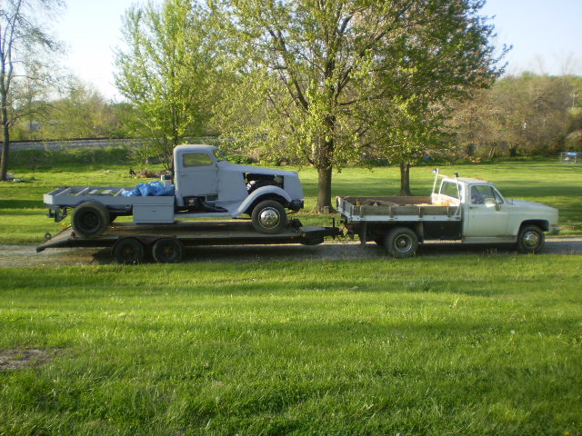

I have a trailer that I built from a MH frame and it has served me very well. The trailer started out as a 12'x60' with 2 axles so it is probably very old. I cut it down to about 8'x24' with the wheels toward the rear so it tows very well bedhind my 1 ton. Two important things come to mind. The original bearings only had 1/2 as many rollers as a new trailer bearing would have so they were replaced. MH rims do not have a flat bead surface like most tubless rims. The bead is angled as a result it is easier to break the bead away from the rim when turning or hitting a curb. The solution is simple though. Keep the tires aired up tight and they will stay on the rim. I have hauled BIG weight for long distances and had no trouble with the tires because they were properly inflated.
