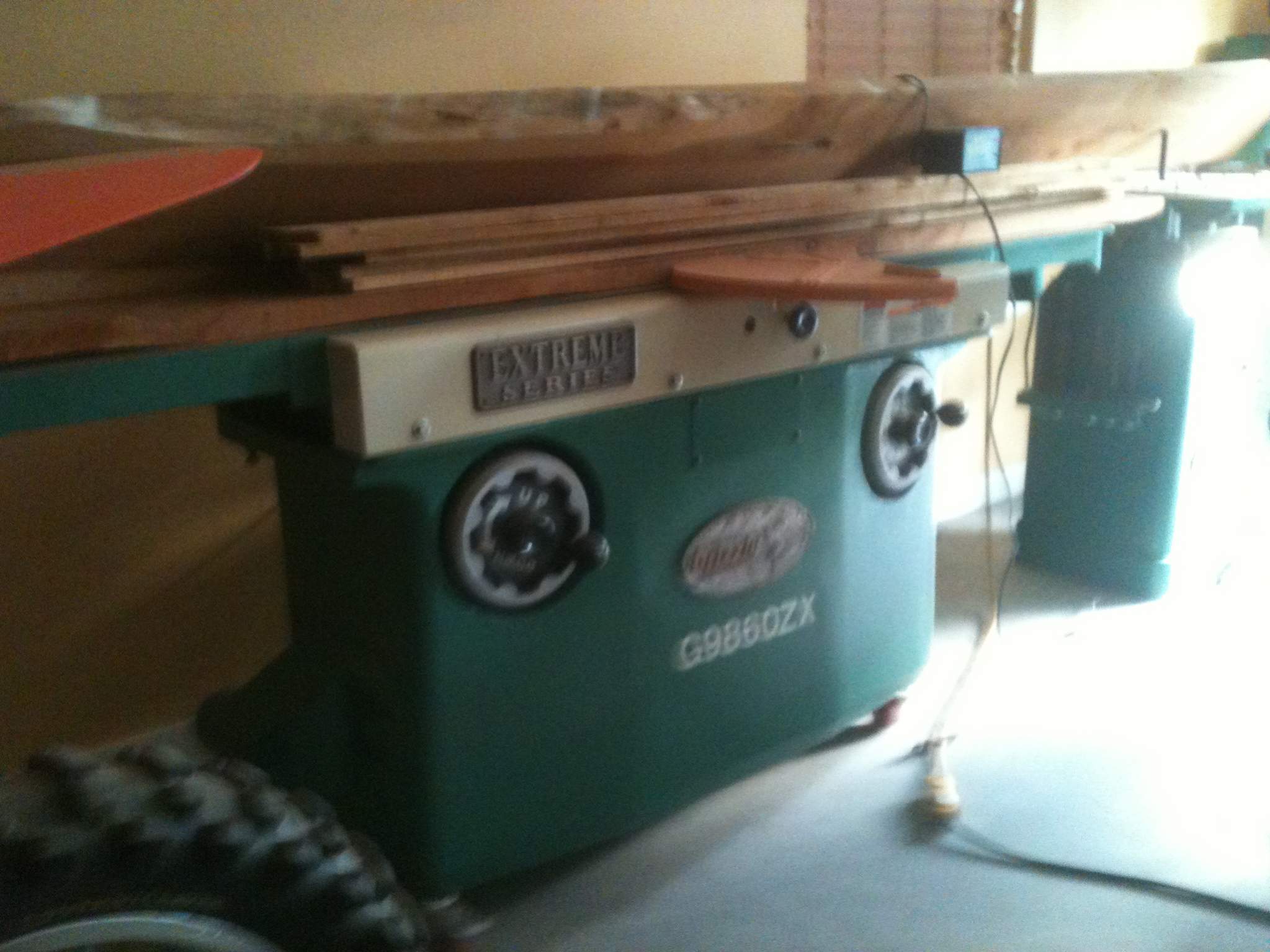

I'm not sure where "Old Dominion" is.....so if its Texas,I have a 12" x 92" jointer I can help you with. I also have a 20" planer.
I believe the 40" Timesaver Norm used was a drum sander,not a planer. When you get to the finished project,you may find a cabinet shop with one of these that can do a final sanding/flattening. Good luck and keep us posted!
