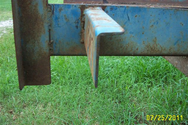

The ' L shaped ' metal is angle iron, and is pretty standard in trailers built like this. If you clean up the metal, and give it a good coat of satin black Rustoleom...the treated wood will not cause much of a problem. You will get more rust underneath from salt, sand blasting of the paint off by gravel/etc. that will do more damage in the long run. As stated above, the wood planking makes the trailer more sturdy and tends to spread the weight out more than a mesh covering would do. Put some good heavy treated planks on it or oak...and tilt the nose up or down to let the water run off when it is stored.

The "angle" is 1.5 x 2.5 x 1/8, but it seems lighter than other angle material I've seen. Here is a picture of the tail light bracket. It almost looks like the factory took some flat stock and then bent it to this shape to make the angle.

The 2 trailers I have are decked with PT and the manufacturer used self tapping metal screws to secure the boards to the angle iron. They are called TEK screws and will be much easier to install that through bolts and no pre drilling through the angle.
