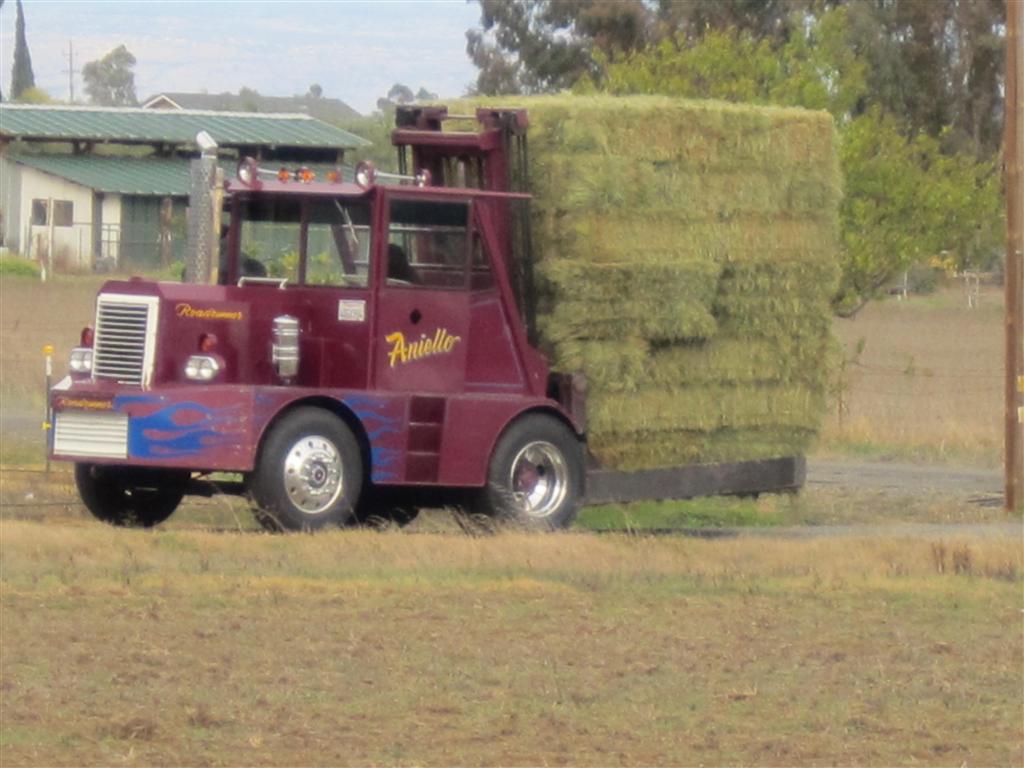

Here's a squeeze in action delivering a load of bales to my neighbor (she boards and trains horses).
Looks like it takes 16 runs with the squeeze to unload that big double bottom hauler.

Does operator have to operate that squeeze while looking back or in mirrors?
   / oat hay Baling issues #46
No mirrors, they drive forward with the load and simply back into the hay storage area
like a forklift with a load and set it down
They apparently used a truck tractor frame and body adding a forklift
hoist and frame to make their forklift to transport the pallets of bailed hay and
have it set up to operate in both directions with two operating stations
They just tow it from place to place(hence the horns and lights) and unhook it to work and then hook it back up to transport it.
They apparently decided to build it from equipment they had rather than buying a three wheeler as they needed the ability to operate in forward and reverse quickly and
also have the capacity due to the high wide bulky loads that hay pallets are.
This is definitely a good case for wrapped round mini bales for hay and haylage as the load would be much smaller and heavier and stay fresher longer for the buyer.
A mini bale system would permit the user to make half round cage built to store a lot bales and sized for bridge clearance height isses to load the wraped bales in and move the cage into the storage shed and then pick it up when its empty to refill it for the customer.
   / oat hay Baling issues #47
The driver's seat swivels 360 degrees and there are two control stations front and rear.
Two guys handle delivery--one drives the double bottom hauler, the other drives the squeeze.

I did not see any california plates on the bale squeeze forklift truck that is why I thought it was a towed unit.
   / oat hay Baling issues #49
Those guys are into some serious hay production and now I know the story on the mysterious three twine bales that I've only seen as props on TV.
   / oat hay Baling issues #50
Probably came down from Oregon. A lot of Oregon hay gets trucked south on I5 to this area and further south to the feedlots around Stockton, Kettleman City, etc.

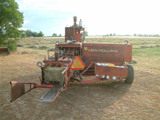

ok so now my hay adventure is done till next october i figured out (i think) why i was having issues. the first is the hay was too short. and also too dry
the too short idea is from all the rest that was longer came out very nice. I think all the work i've been doing to this old 214t has made the job go alot smoother. only real issue on the baler is the inboard bill hook doesn't let the knot go sometimes. went 2 years without a missed knot. 7 knots in 188 bales the other day and about 10 in 155 today. any ideas why it hangs up?
   / oat hay Baling issues #53
Are the bales banana shaped? If so adjust needed forks. Sounds like the weight is right, moisture shouldn't be a problem if its been down that long. Sure is slippery hay though. We used to have trouble with meadow hay with a 214. If your getting a tight straight bale its the nature of the beast. 2 twine bales are a pain.
Stay with it you'll win in the end.
   / oat hay Baling issues #54
That should have been feeder forks. Auto spell? ? ?
